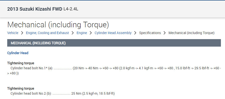

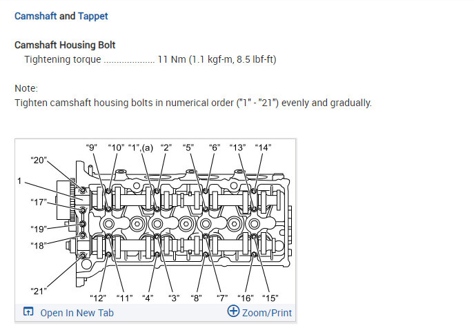

I’m doing a head gasket job on my vehicle listed above GTS, and I need to know the torque specs of head bolts and camshaft bolts all of them on top the valve I’m not sure if any of the bolts would be a different spec, please I need help?
Mar 4, 2024 at 8:58 AM
  • 110,241 POSTS

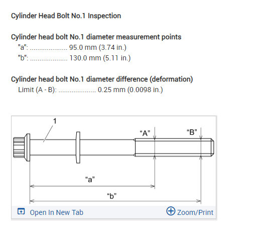

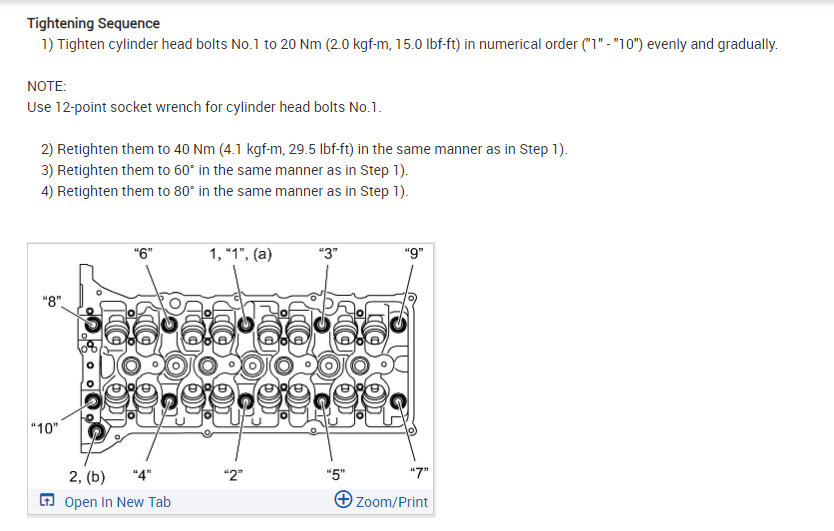

I attached the manufacturer's torque specifications below. Take a look through them and let me know if you have any questions.
Also, let me know if I can help in any way.
Mar 4, 2024 at 11:31 AM
KEVIN FOSTER
7 steps to tighten them?
Mar 4, 2024 at 12:17 PM
KEVIN FOSTER
Can I just do 15 Ft pounds then 29.5 ft pounds?
60 degrees then 80 or do I have to do it in the order says?
