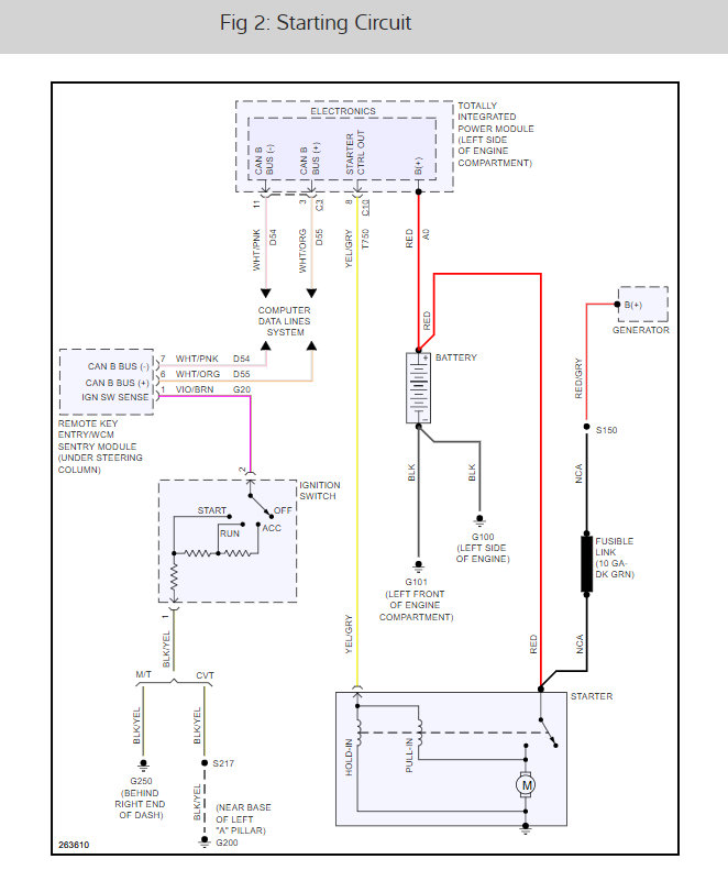

I have power to engine but all it does when I turn over is nothing. I put new battery in it and new belts. It was running at beginning of the year but then parked and it has been so sitting. trying to fix this car.

We need to check voltage at the starter when cranking. Not only do you need voltage but you need sufficient voltage. When you say nothing happens, does that mean it just doesn't turn over or the lights don't come on in the dash or anything? If no lights or anything then we could have an ignition switch issue. This sounds like the starter is having problems or the battery needs to be load tested these guides can help us fix it.
and
Please run down these guides and report back. Maybe sending a video of what it does when trying to start it will get us on the same page. Thanks

It sounds like the starter motor has gone out. To be sure here is a guide to help you test the system and fix the problem. I have also included the starter wiring diagrams so you can see how the system works.
Oct 22, 2019 at 8:59 AM

Kasekenny yes, the car powers on all accessories turn on, lights turn, on blinkers work, fuel pump kicks on. but, when I turn the car fully over there's nothing not even a click and all the power stays on.

Is the security light flashing? Can you please shoot a quick video with your phone so we can see what's going on? that would be great. You can upload it here with your response. Do you get power to the trigger side of the starter please check out the guide above.

Thanks y'all. it was a 7.5 fuse under dash had a wire going to my ignition.
