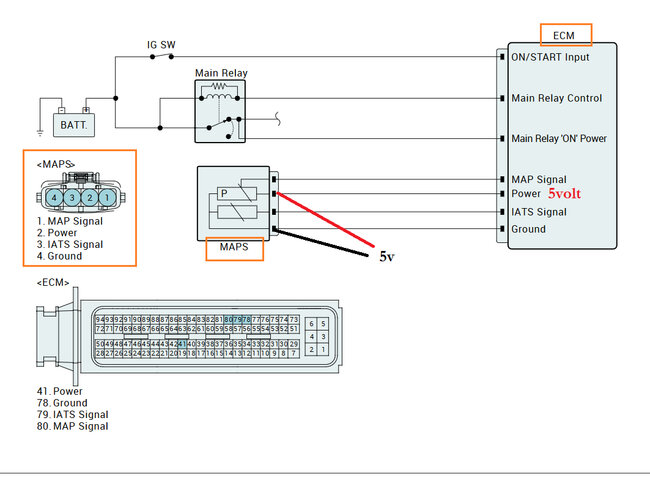

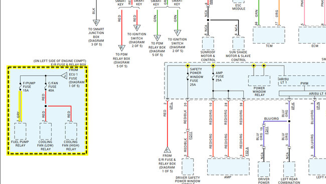

Hello, the codes setting, p0108 and p0113 are both related, I'll post a wiring diagram for you, but the cylinder 2 misfire code may not be related, where did you buy your parts from when trying to get rid of this misfire?

Is your check engine light blinking when it sets the misfire code? The other 2 codes are for the MAP sensor and intake air temp sensor which are combined into one sensor, so the sensor may have a bad ground, since the MAP sensor part is indicating a "Signal High" and the IAT part of the sensor is indicating a "Signal Low".
This is the OEM for the MAP/IAT sensor, with it unplugged, key On, engine Off. You should read 5volts across pins 2 and 4 with a multimeter set on DC volts. Thats the first check I would do.

The MAP sensor is on the Throttle Body, just behind the throttle plates, since it measures intake manifold pressure. It's a 4-wire sensor. As for the misfire, if you have replaced the ignition coil, plug and fuel injector, that pretty much leaves, either there is a control problem with one of those components such as wiring. Or there is a compression issue. And a static, only cranking compression test may not always reveal the issue. If there is a valve sticking partially open at certain times, it can be difficult to catch. You can try pulling the spark plug out and putting a bore scope down the spark plug hole to take a look into the cylinder, to see if you notice anything that looks odd.

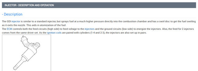

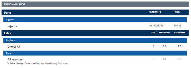

Here is the GDI injector operations diagram, you'll notice it states "Also the feed for 2 injectors comes from the same driver set" So power for the high side powers up 2 injectors, and most GDI injectors are Peak and Hold type, meaning they open the injector with a high voltage, and then pulse them with a lower voltage to keep them open. But you should be able to see the Fuel Rail data PID drop off quickly if one is staying open, check that first. Since you can't tap into these fuel rails due to the very high pressure, watching the data PID should help you figure out what's going on, a ton of white smoke sounds like one is staying open. The resistance spec for each injector is 1.5 Ohms. I'm looking for a fuel pressure spec, but it will be high, usually 500 to 2000psi for a GDI rail.

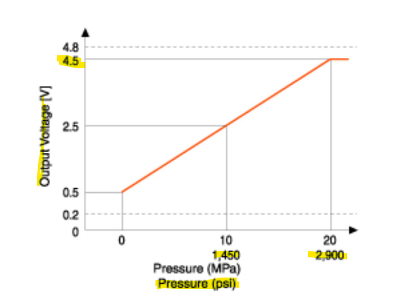

Here is the Fuel Rail pressure sensor voltage over pressure graph, so 4.5volts is 2,900 PSI. Very high pressure.

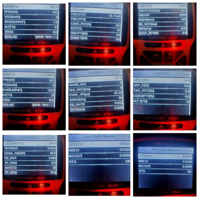

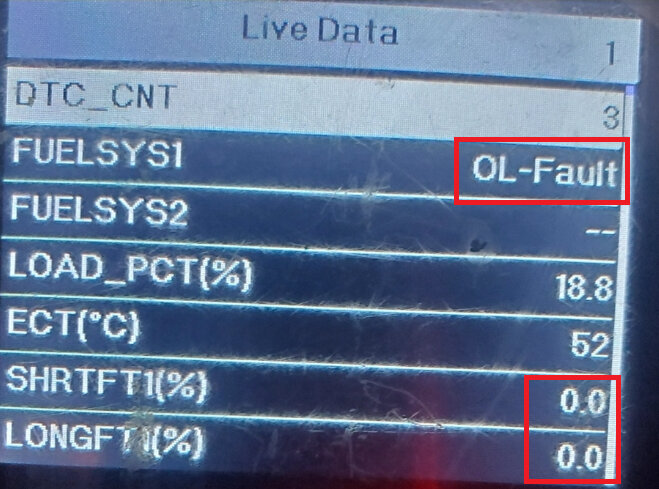

Ordered new injectors should be in today. The pics are with the car running. The spark adv. Jumped up to 25 could that be from injectors because those and coils were replaced.
May 15, 2024 at 11:15 PM
ANN SENN
  • 49 POSTS
I made a collage because it would only let me upload one picture at a time and then I'd have to send them one by one.
May 15, 2024 at 11:16 PM

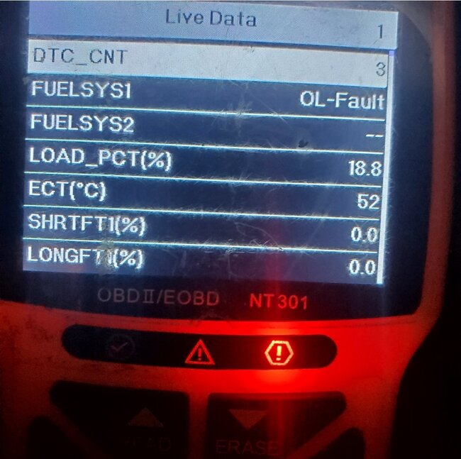

Had no reading for short and long fuel trim?

There's no fuel trim data because the vehicle has a fuel system fault, see where it says OL-Fault, that's the fuel system staying in Open Loop operations due to the faults. This is a very basic scan tool and is only giving you global OBD2 data, it's not going to be much help. Your front Air/Fuel ratio sensor reading is extremely rich at -2.938ma. that should be close to 0 and the EQ_RATII should be close to 1. Being in OL (open loop) operation the PCM is only taking input data from a couple sensors, you need to know what the Fuel Rail pressure is. And you need to check the MAP sensor to determine what that fault is.

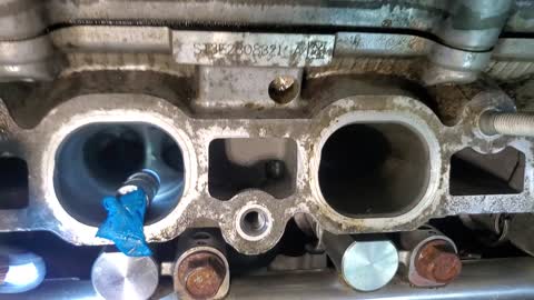

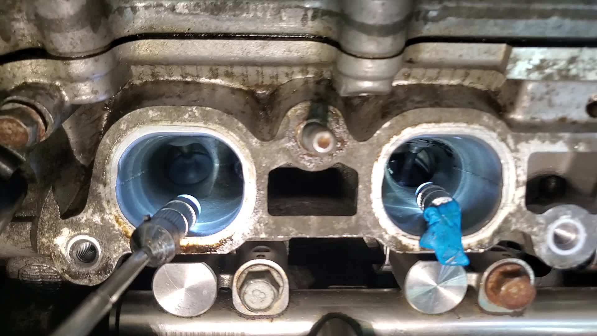

Unfortunately, I do not have that tool however I was looking in the valves and is it normal for one to be down a little bit and the other three to be all the way up here's a little video.

AL514
  • 5,668 POSTS
No that's not normal, with 2 intake valves and 2 exhaust valves, each pair should be the same. Are you taking a video with the valve cover off?

AL514
  • 5,668 POSTS
If the valve cover is off, you can take a look at the valve springs and see if one is broken, take a picture if you can't upload a video. Is it the #4 that you see a valve hanging open?

Intake manifold off cylinder 2 is about..25"
Below flush... Where the others are.
May 18, 2024 at 12:42 PM

AL514
  • 5,668 POSTS
It's difficult to see in the video, but I'll take your word for it, did you pull the valve cover off and inspect the valve train for any issues? They're very clean for being a GDI system, usually there's a ton of carbon build up on the valves and it requires a walnut blasting to clean them out. But I would start by checking under the valve cover to see if there's anything you can spot visually. Thats definitely going to be the cause of the #2 misfire code. Obviously if you find a broken valve spring, it will have to be replaced. When you have the valve cover off rotate the engine by hand and watch the #2's valve/camshaft movements. But you have a very good idea of what you're doing, I'm sure you can get this figured out. Let me know if you need any further service info.
