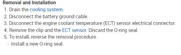

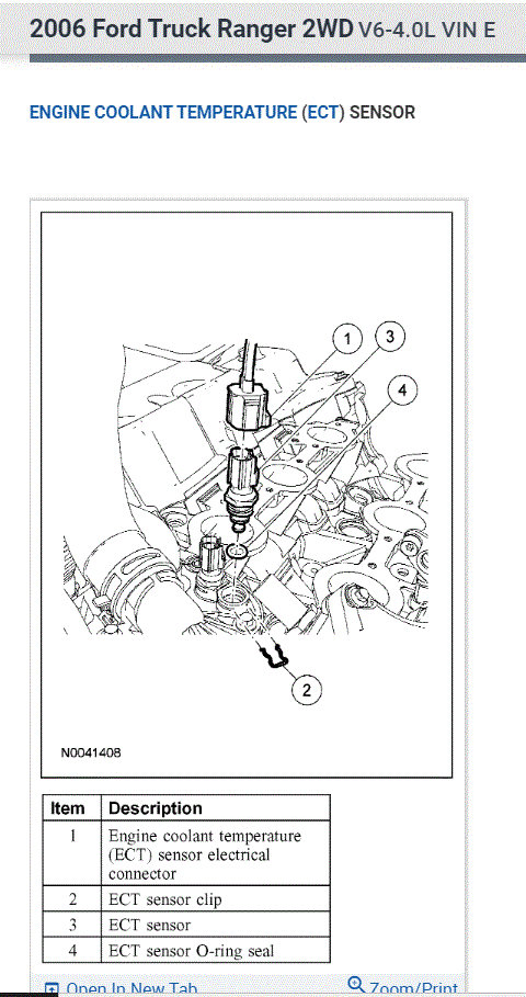

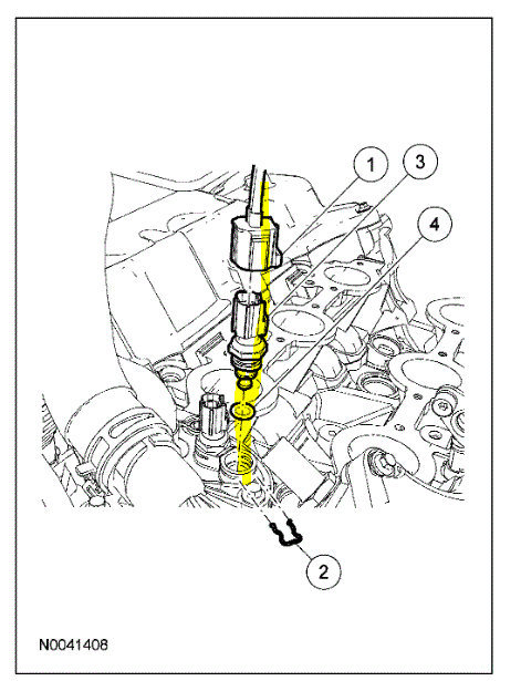

One is an ECT sensor, and the other is a sender. If you want the one that signals the ECM for fuel control and the cooling fan, it's the one on the right standing at the front of the vehicle. See pic 1.

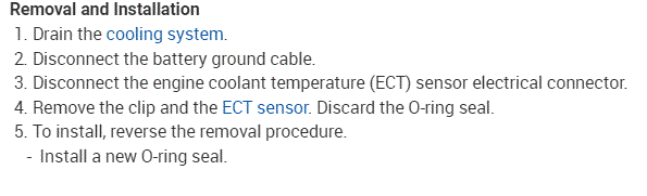

Pics 2 and 3 are the directions for replacement.

Just want to be sure the sensor on the driver's side is for the ECM, correct?
Larry
Jun 3, 2022 at 12:18 PM
  • 110,194 POSTS
Yes. At least that is how it is identified to be in the manual. If I recall, that is the one I've replaced in the past for the ECM. It's been a while, but that is what I remember as well.
Let me know how things turn out for you.
