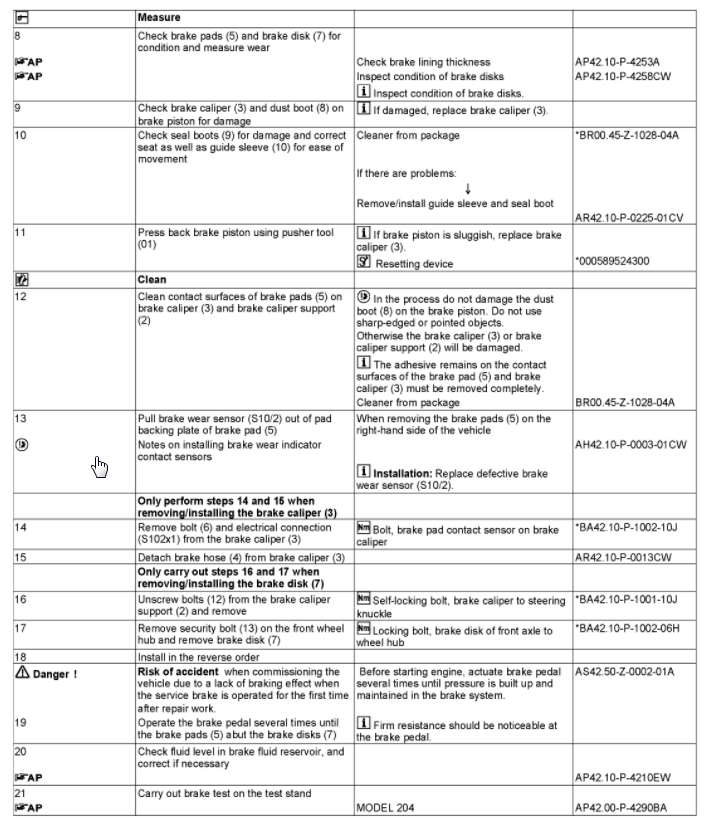

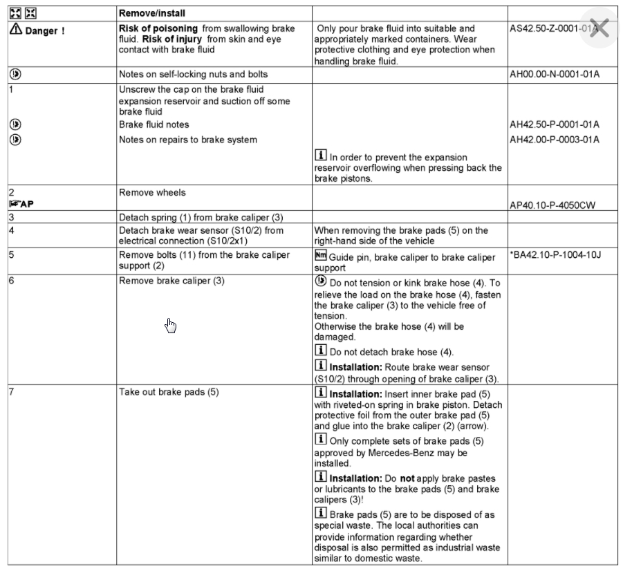

Front disc rotors (drilled) need the replacement instructions?
2014 MERCEDES BENZ 350SDL
51,000 MILES • 3.5L • V6 • 2WD • AUTOMATIC
JAMES ST ROMAIN
MEMBER
2 POSTS
front disc rotors (drilled) need the replacement instructions?
Mar 17, 2019 at 5:02 AM
Experienced Mechanic
18,907 POSTS

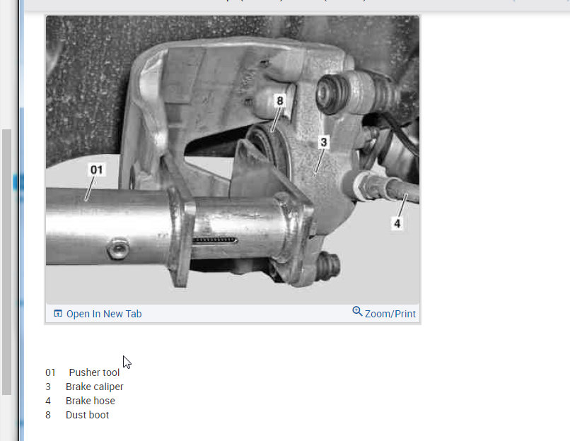

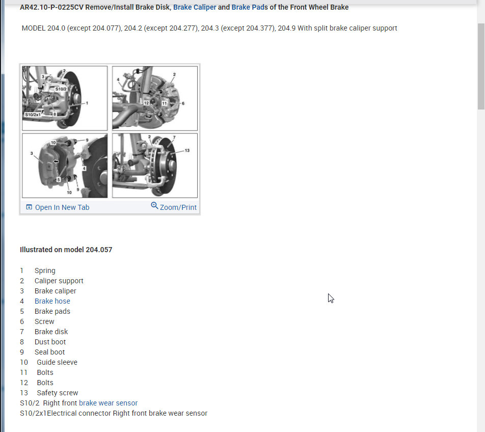

Here is a guide that will help with this:
Plus here is a video that will help as well:
https://www.youtube.com/watch?v=v5hMVIJ1u8k
Lastly below is the process from the manual that will help with getting this completed. Please let us know if you have other questions. Thanks
