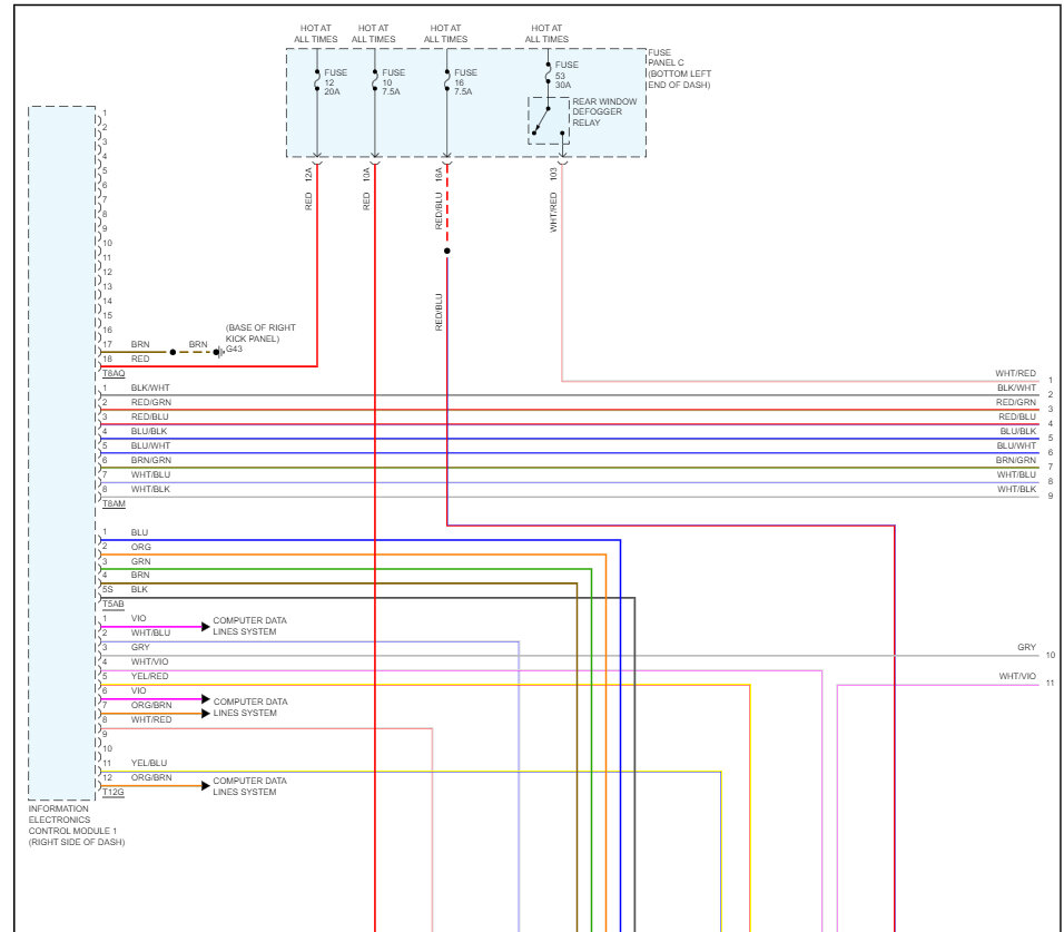

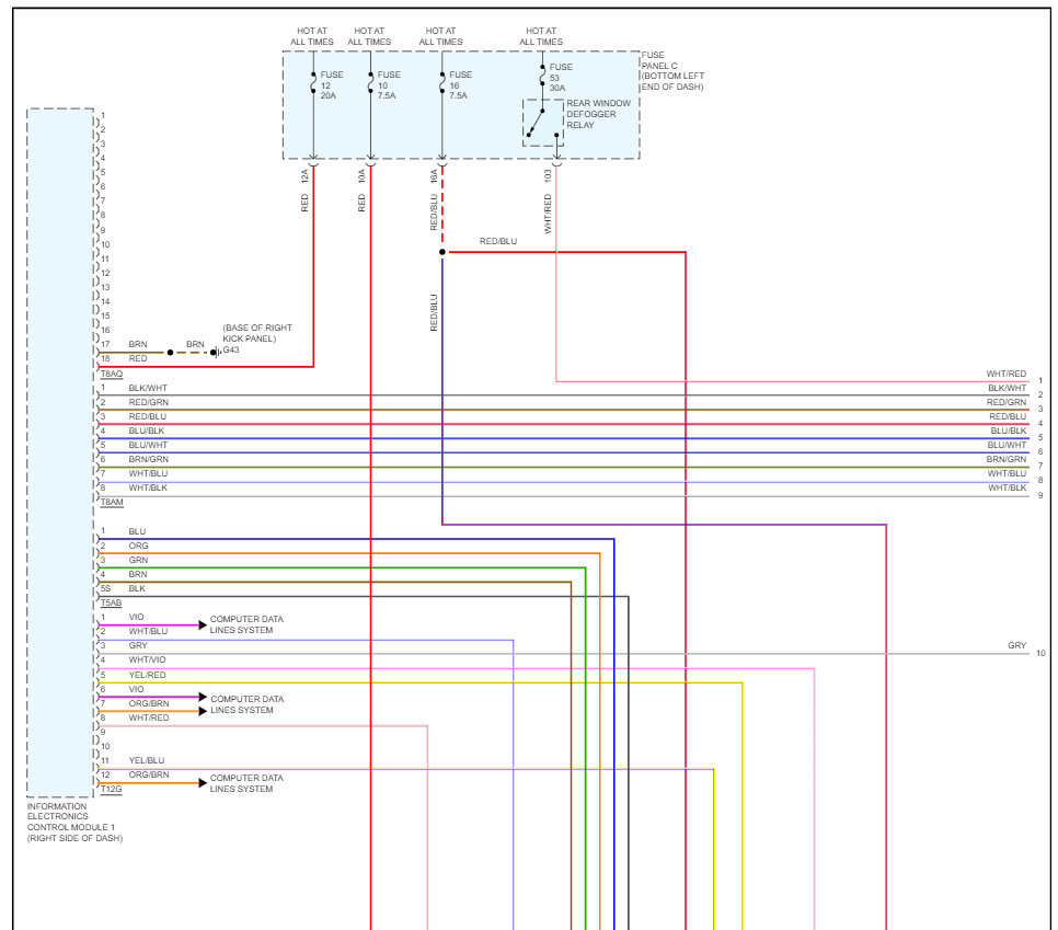

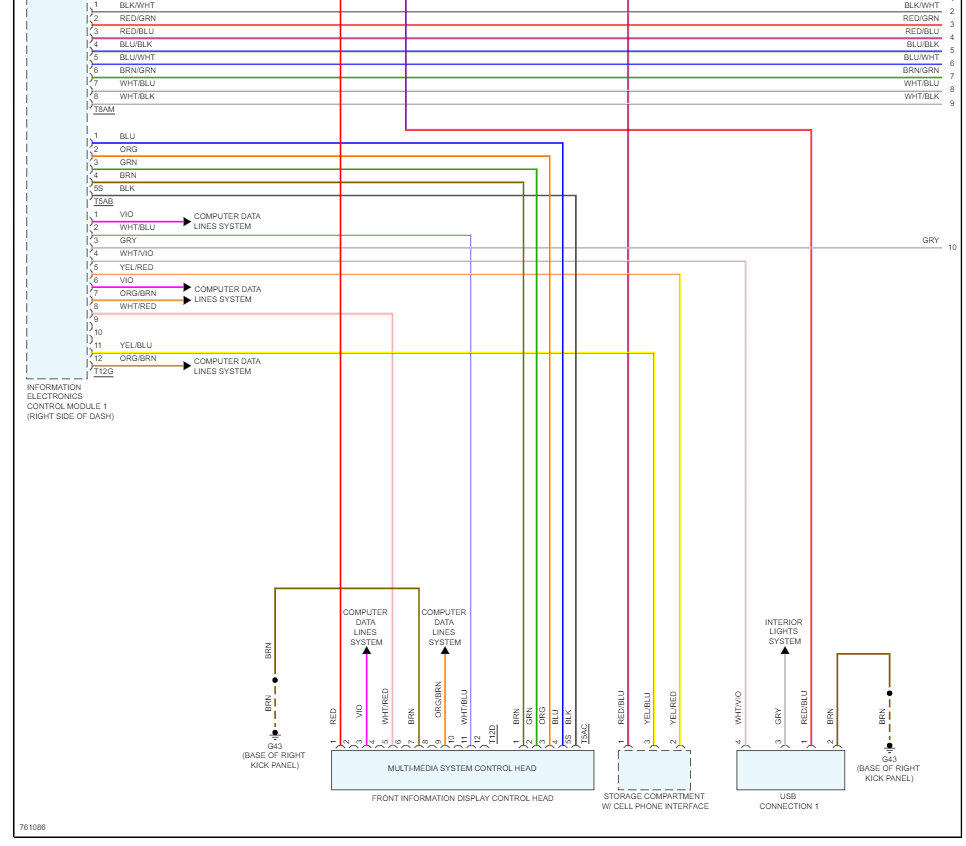

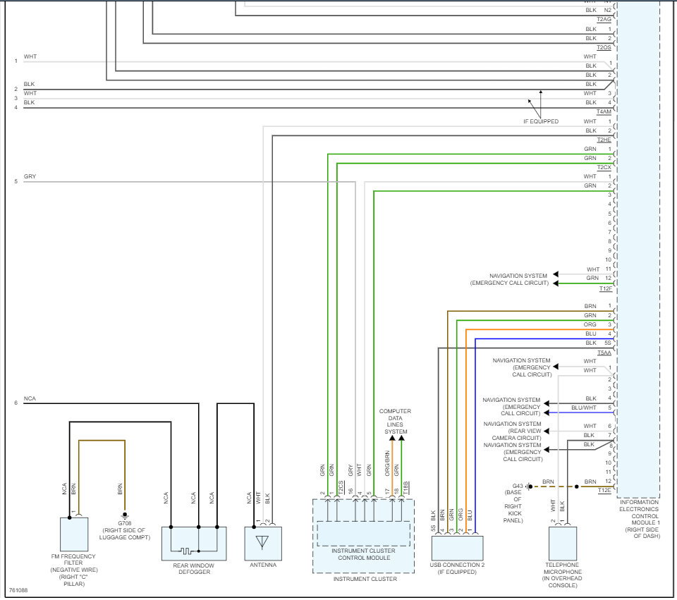

I need radio wiring diagram so i can install my amp and sub. I can't get a straight answer.
Jun 13, 2023 at 6:04 AM
  • 55,423 POSTS
Sure, here are the radio wiring diagrams for your 2021 VOLKSWAGEN JETTA. Check out the images (below). Please let us know if you need anything else to get the problem fixed.

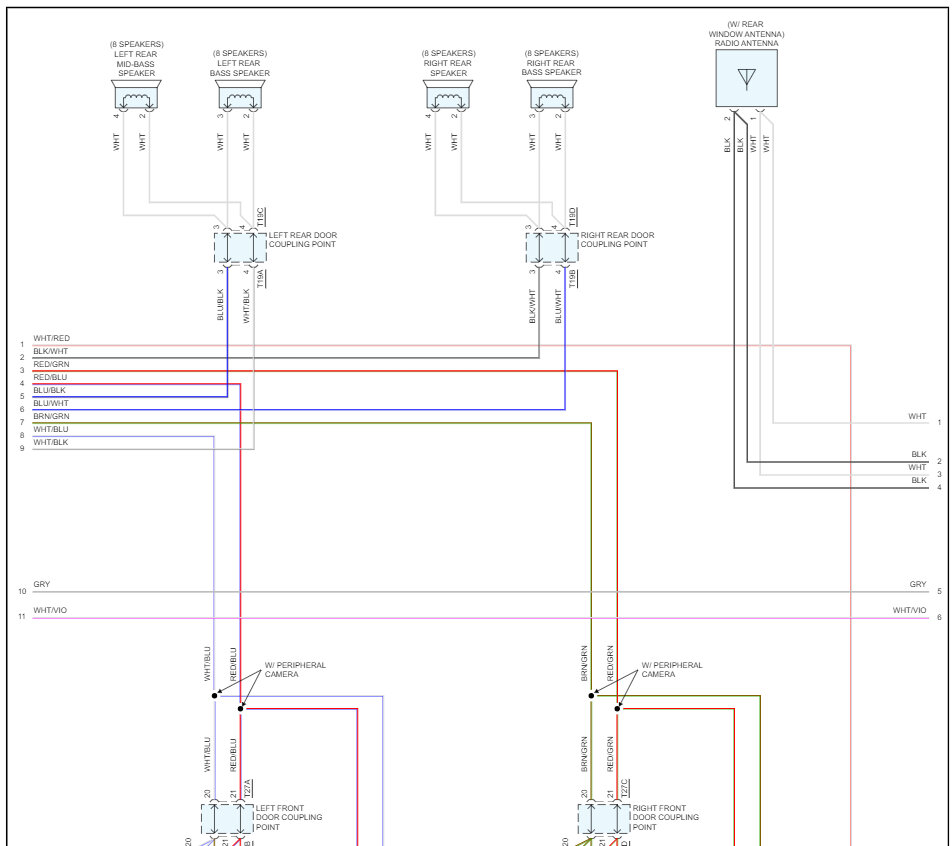

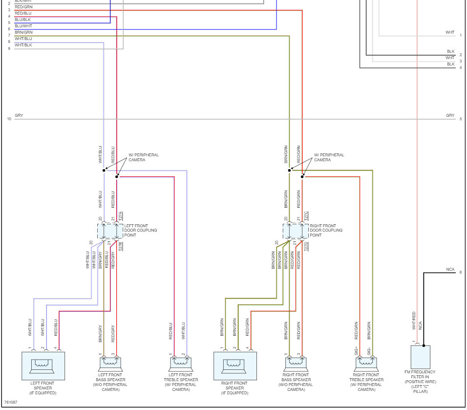

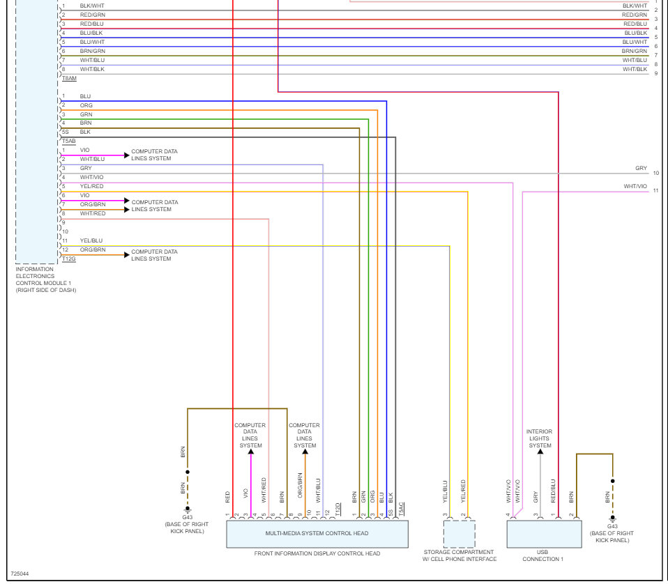

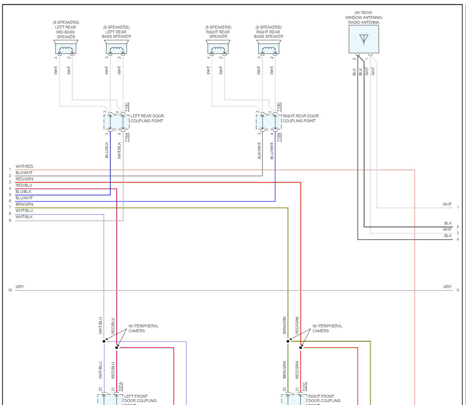

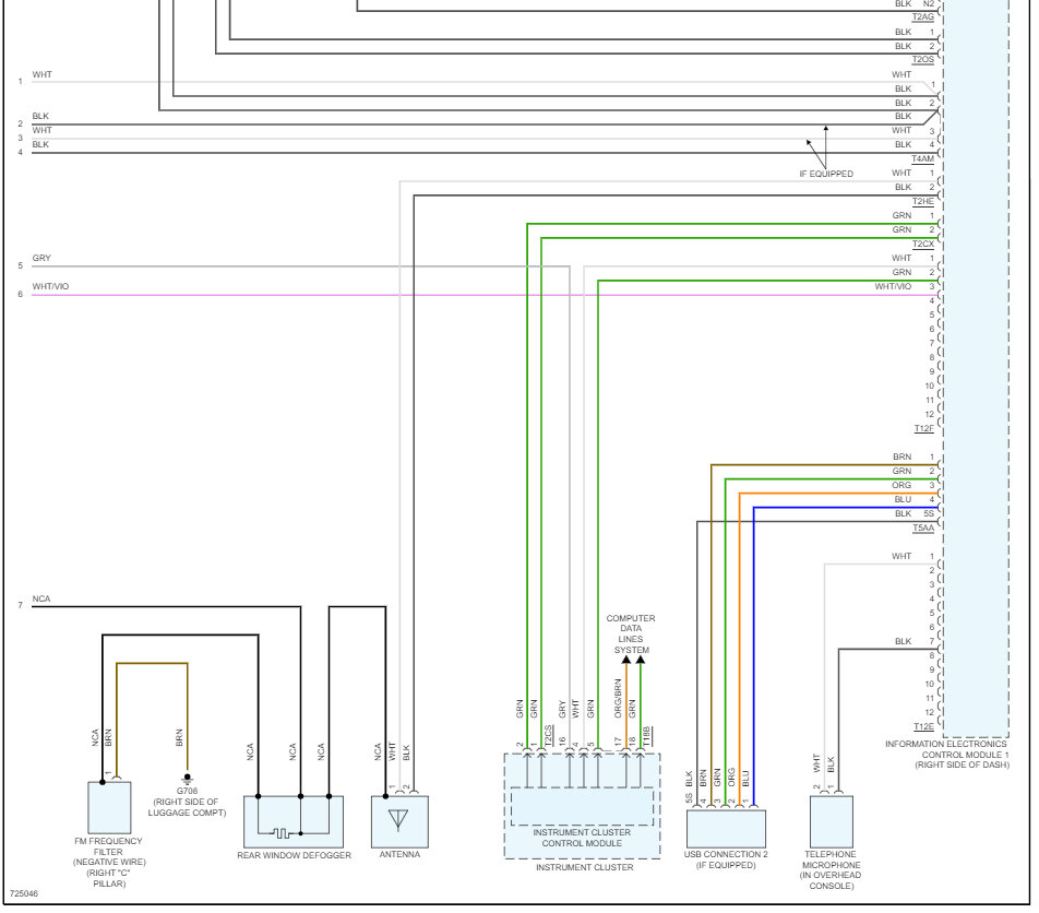

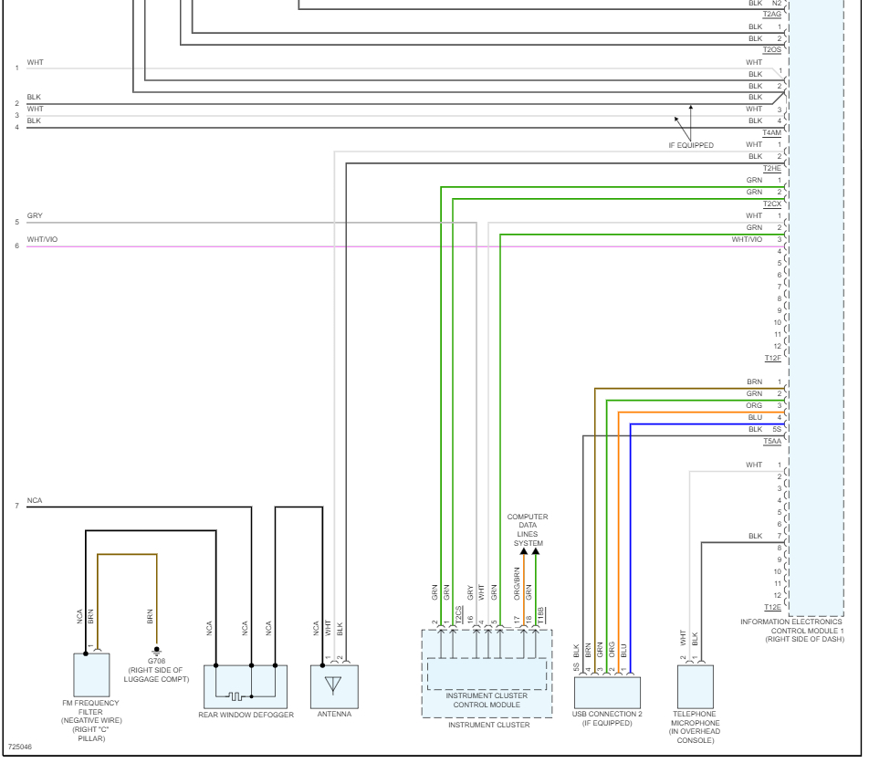

Hi ken, would it be the same color wires to the rear speakers on a base model 2020 Jetta?
Sep 5, 2023 at 12:54 PM
  • 55,423 POSTS

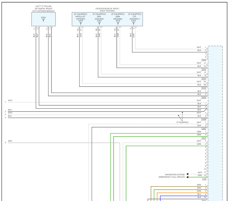

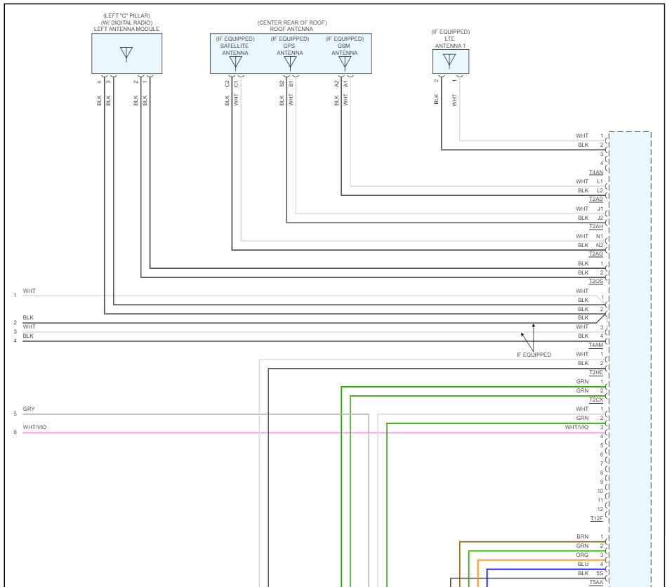

Here are the wiring diagrams for the base model radio for the 2020 Jetta. This guide can help you test the connections:
