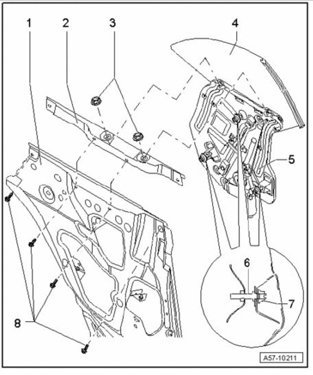

Yes, I have found a guide and will give you an idea on what you are in for when doing the job and a diagram (below) that shows what it will be like on your car.
https://www.2carpros.com/articles/how-to-check-and-replace-a-electric-power-window-motor

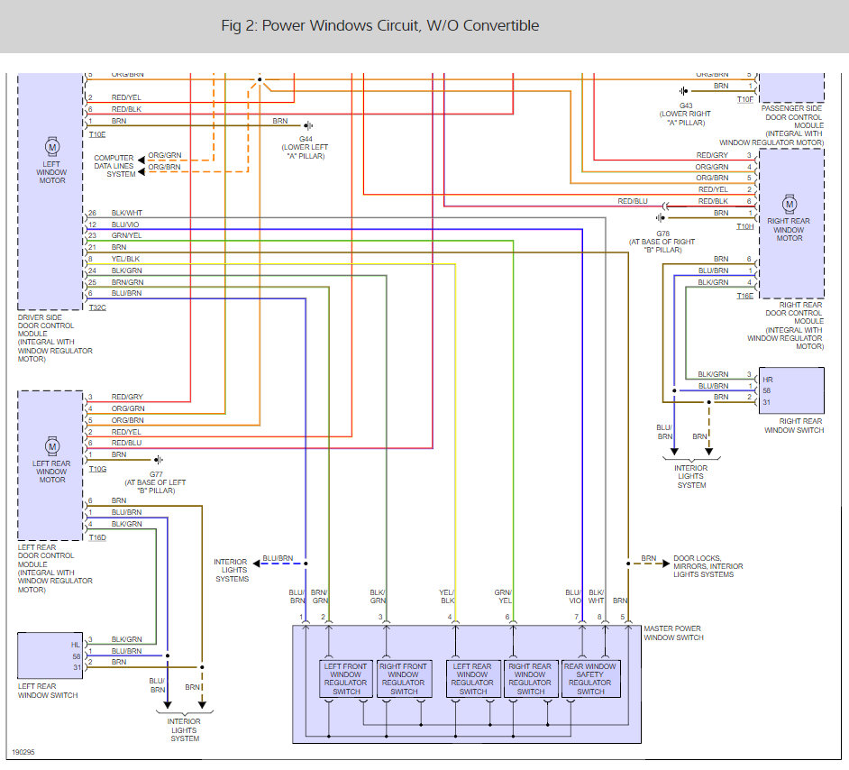

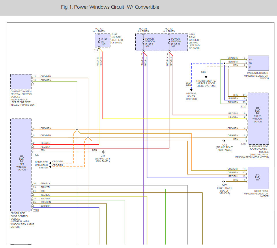

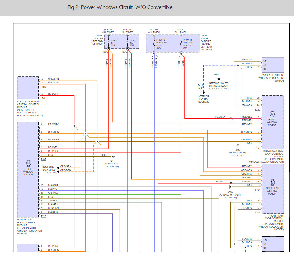

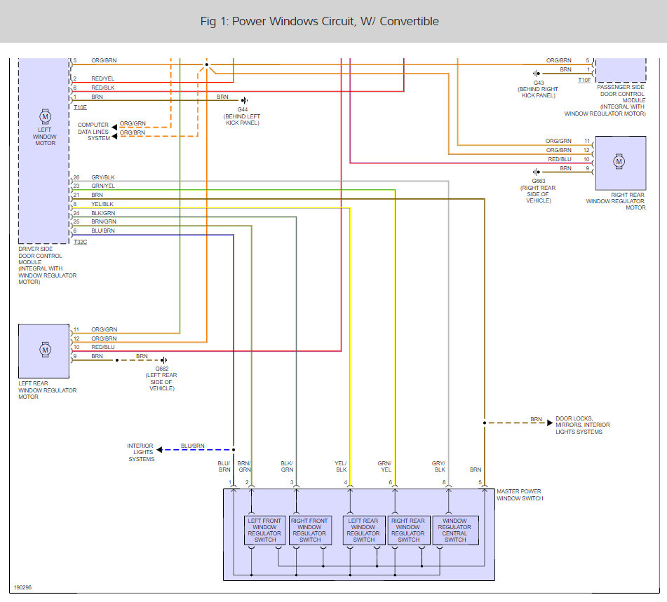

Thanks Ken, but I really only need the wiring diagram showing each wire color and purpose. I have a cut harness.
Sep 9, 2017 at 11:00 AM
  • 55,628 POSTS
Yep got you covered, here are the window wiring diagrams you asked for. (below)
