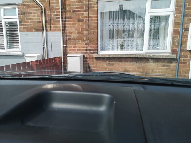

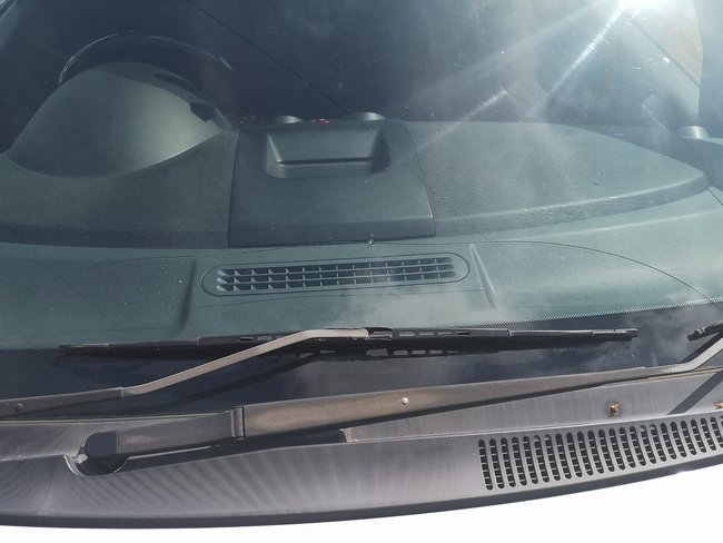

I have accepted courtesy car from them almost 2 weeks ago and still waiting for my car to get fixed. They said they were going to try another ABS modulator or something like that. At courtesy car crack appeared at windscreen. What do you think I should do about my situation and crack in window? I haven't done much driving at all. Just 10 min to work and back from work, that crack in the windscreen window annoying me. On top from last night I found really small few cracks like long hair at passenger's doors window. They are too small for picture to see.

Hard to tell what the cause was, any rock chips or other damage? Maybe call them about it. Every shop handles things like that differently.

I was driving maximum 40 MPH only in town and while driving didn't notice anything. After overnight, I left it at work in a parking bay. I found it in the morning after work.

Hard to say without seeing it up close, could be from a rock chip that didn't get noticed and spread as the interior temperature changed or someone could have shot it with something like a bb gun or something like that as well. Glass really isn't that hard to damage. In shops around here the shop insurance on loaner cars takes care of it. But it depends on the local laws as well. That's why I would call them and let them know about it. Shows you are being honest with them.
