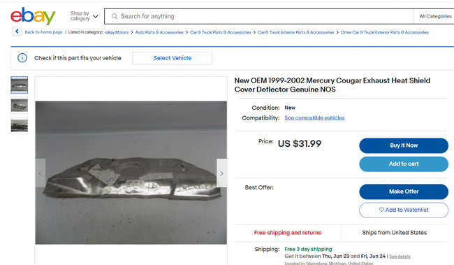

I believe you are referring to the heat shield. It is mounted between the exhaust and floor of the vehicle.
Is there any chance you could take a pic of where it's missing? There are a few different ones.
I attached a pic of the one I think is missing. It is an upper shield between the exhaust and the floor as I mentioned. But please understand, without seeing what is missing, this is only a theory. I found this on eBay.
See pic below.

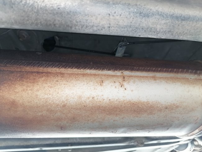

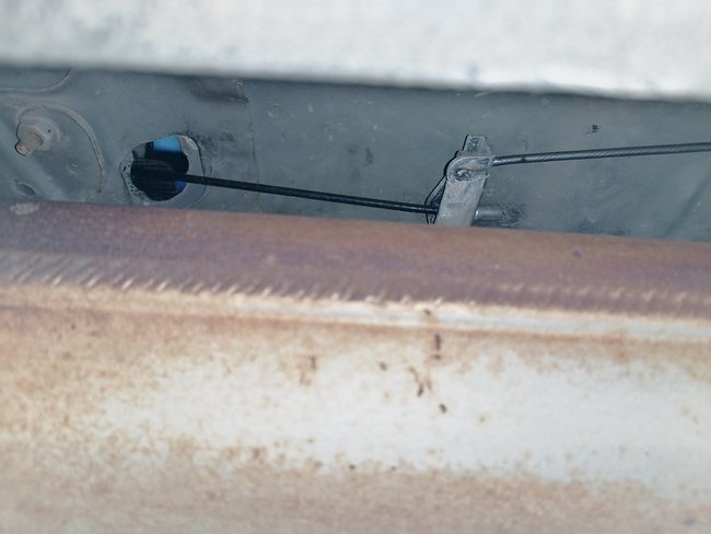

I took some photos from the underside. Angle is bad but hope you will understand.

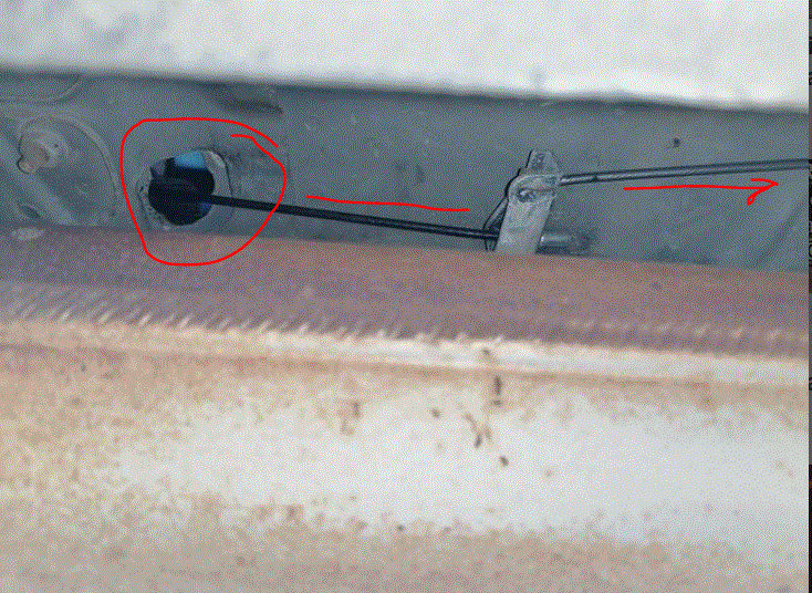

The angle is perfect. If you look below, I copied one of your pics and circled where the heat is going. The heat shield should be between the muffler and the underside of the vehicle. I believe the pic I sent is the one you need. I would contact the seller and confirm to be sure, but that's what is missing.
Let me know if I can help.
See pic below.
