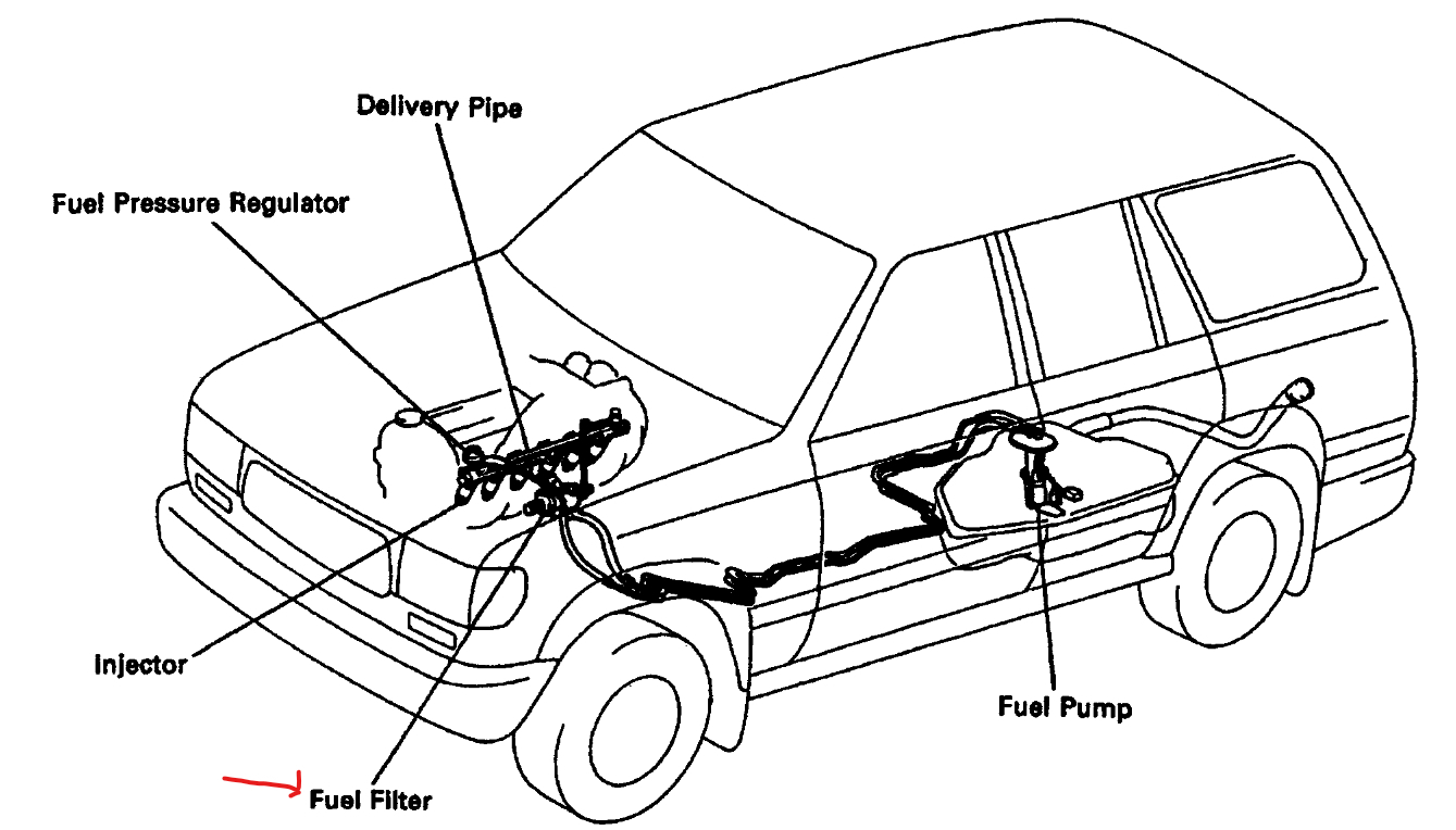

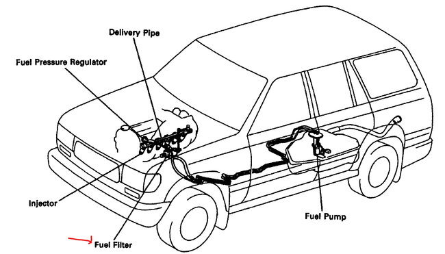

Most of the time when the engine is low on power the turbo is going out, or you need to change the fuel filter, air filter, MAF sensor is bad, or you have a partially clogged catalytic converter. Here is a guide to help you get started so we can eliminate parts until we find the problem:
