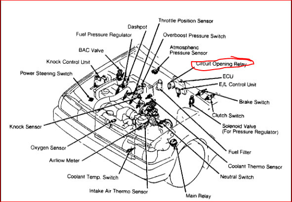

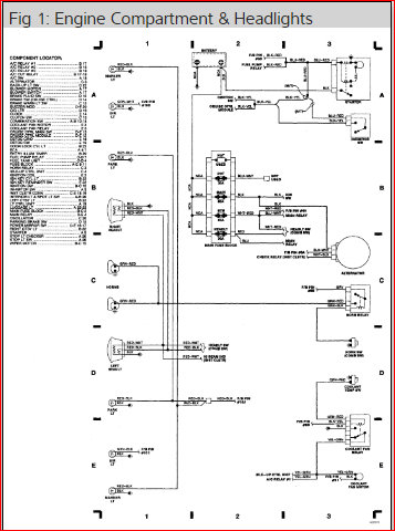

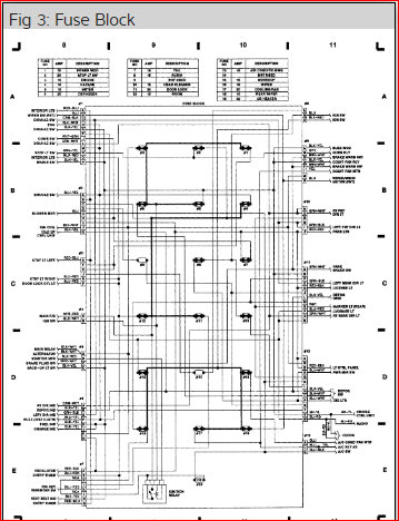

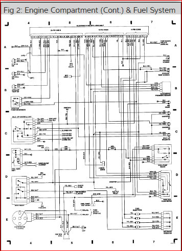

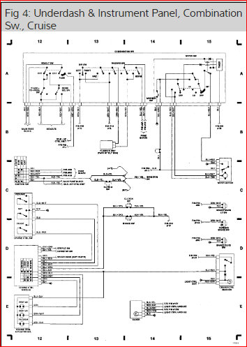

Working on the vehicle listed above (wagon) with fuel pump not getting power. Need to know location of fuel pump relays, and part numbers for them. Also need wiring schematics for the fuel pump, fuel pump relays, and ignition switch. It sounds like other people have had this problem with their vehicles as well.

I have attached a picture of the location of the fuel pump relay (center of firewall) and pictures of your vehicles wiring diagram. I have also attached a tutorial for you to view. The fuel pump relay Ford part number is E8GY 9345 D. Hope this helps and thanks for using 2CarPros.

The wiring diagrams are blurry when I save and print them. Not sure if they can be sent via email with better luck or not. I looked under the dash and on the fire wall. The relay is not where I would expect it to be. I already saw the location diagram, but what I expect to find is not there. I will look for a picture of the relay part number you gave me to help narrow my search.
