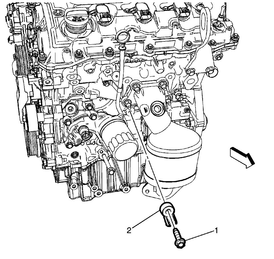

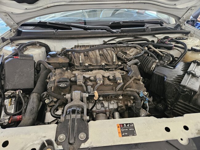

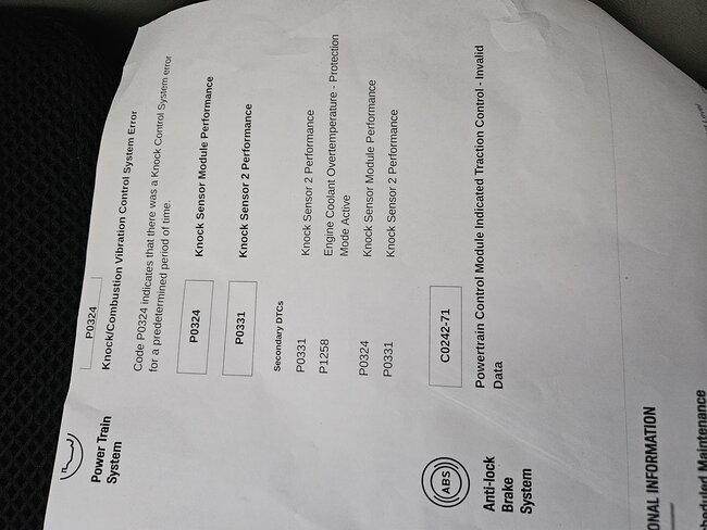

Need knock sensor bank 2 location, diagram, replacement steps?
170,000 MILES • 3.6L • V6 • 2WD • AUTOMATIC
TIJUAS
Got a knock sensor 2 bad reading at auto store. Need to replace it, just need to know where it is.
May 27, 2024 at 7:23 AM
  • 110,248 POSTS

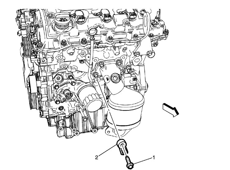

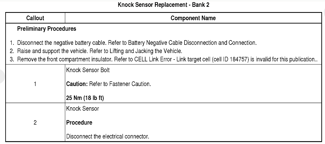

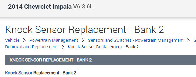

The manual indicates it is accessed from under the vehicle. However, the good news is it is located at the front of the engine above the oil filter and below the exhaust manifold.
I attached the directions below for the bank 2 sensor. Take a look through them and let me know if you have questions.
Let me know if this helps.
May 27, 2024 at 11:57 AM
TIJUAS
Thank you! I was able to locate the sensor and complete the job with the information and diagram you provided. I appreciate your help!
