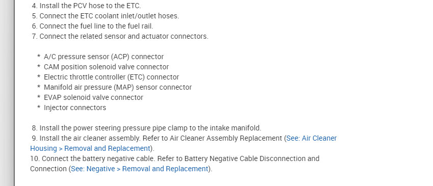

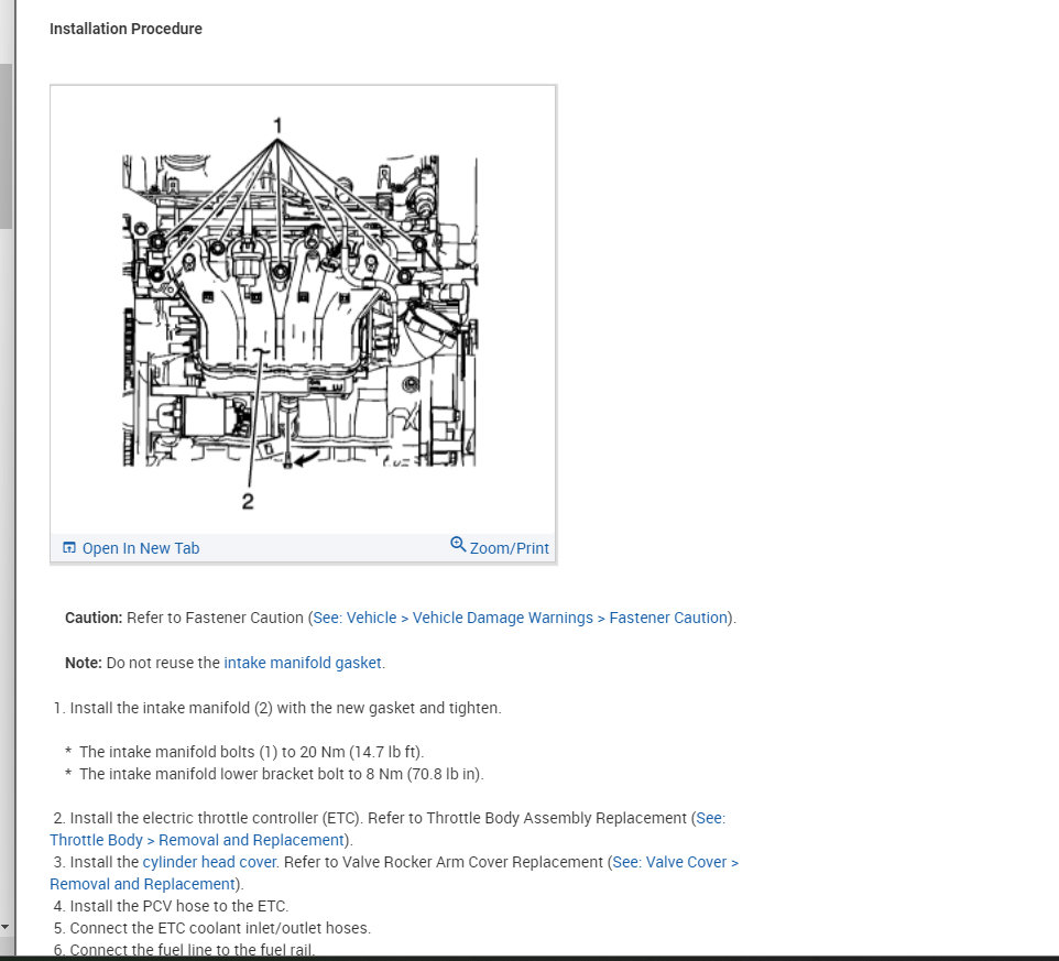

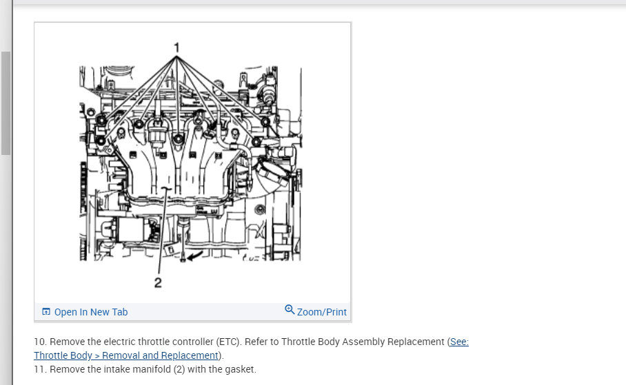

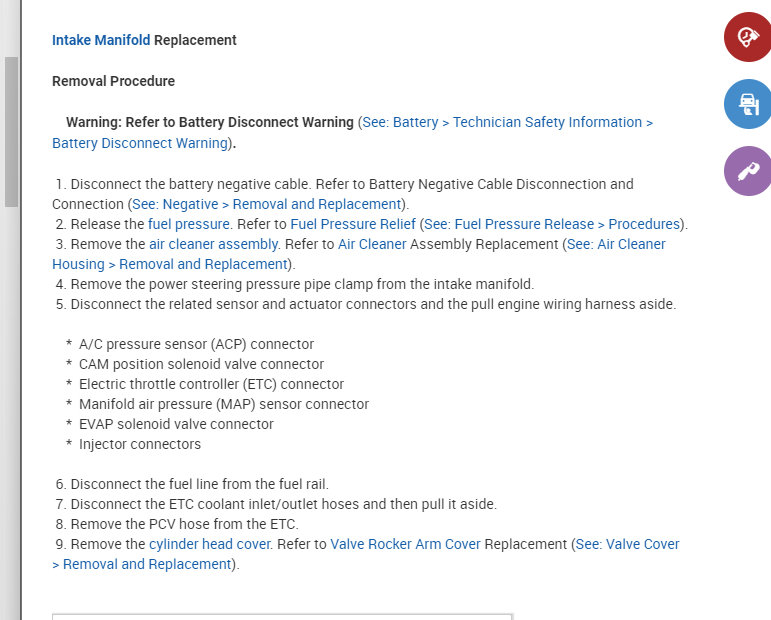

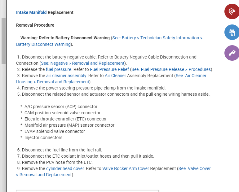

I will attach the info from the manual. However, here is a guide that will help with doing this repair even though this is a different vehicle:
https://www.2carpros.com/articles/replace-intake-manifold-gasket
As for changing the oil, the only time you need to do this is when you have to clean the gasket material off with a chemical or razor blade. Basically, if there is any chance that the material will fall into the engine is when you should change the oil.
If the gasket is a rubber gasket, then it is not needed.
The sequence is working from inside out even though it does not say that.
Please run through this material and let us know if you have questions.

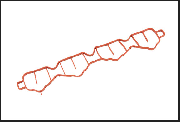

Correct. I attached an image of the manifold gasket per the manual part number.
These style gaskets do not require RTV unless the manual specifically calls for it.

Yes, that is the one on the back of it on the lower section of the manifold. Does All data say anything about RTV? I cannot see any used by the factory on the original gasket.

It does not. I attached the instructions above in a previous post. It literally says to install the gasket and manifold and then tighten it.
