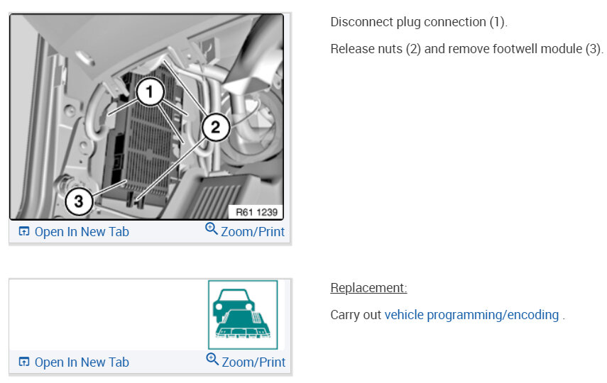

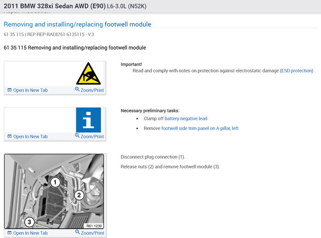

It sounds like the Footwell module has gone out which is common in these cars, but to be sure we need to do a CAN scan, you can get a CAN scanner (Controller Area Network) which will work on most cars from Amazon.
here is a video to show you how:
https://youtu.be/u-4syLc-ifQ
and
Here is one for about $99.00 if you need it:
https://amzn.to/3ZixY4v
Here is how to change the footwell module out in case a code comes up for its failure. You can get a preprogrammed unit by searching Google or Ebay.
