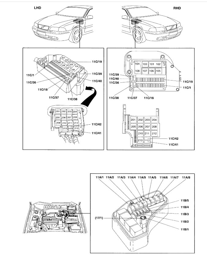

Transmission seems stuck on Limp Mode but can't see the arrow, Cluster doesn't show anything, and Tachometer and Speedometer don't go up. Need help with this (First time owner of a Volvo).

The first thing I would do is check the fuses, this guide can help with the fuse locations in the images below:
Please check the fuses with the key on, if the fuses are okay let's run the codes to see which ones are stored.
