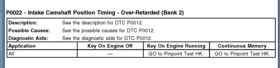

Code P0022
CHRESTIAN WALKER
  • 2006 FORD F-150
  • 5.4L
  • V8
  • 4WD
  • 168,900 MILES
I had multiple codes pop up and I fixed what they said. I put 2 brand new camshaft position sensors in and new plugs and boots and the codes went out yesterday. Now today a new code p0022 cam position actuator A-Bnk2 Timing Over-Retard. Please help me and let me know what to do. It starts and it runs but it has that code now.
Thursday, September 24th, 2020 AT 5:49 PM
4 Replies
This could be a couple things so we need to run through this testing. This could be a wiring issue a variable cam timing solenoid, PCM, or a couple other things so the only way to know what the issue, is to do the testing.
Let me know what questions you have. Thanks
Thursday, September 24th, 2020 AT 6:11 PM
  • 109,874 POSTS

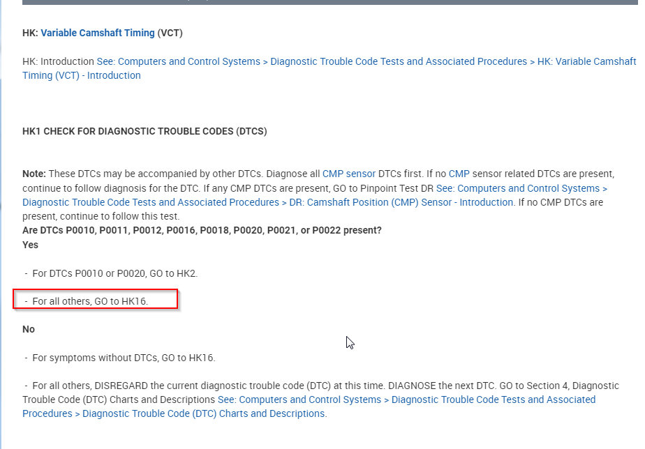

I need to know if any of the following codes were present prior to the original repairs.
DTCs P0010, P0011, P0012, P0016, P0018, P0020, P0021?
The variable timing control (VTC) system is controlled by oil flow in the actuator assembly. The code is indicating timing to be retarded (behind) which is setting the code. I need to know if the original codes indicated a different issue prior to the repairs.
Thursday, September 24th, 2020 AT 6:15 PM
CHRESTIAN WALKER
I never got those codes I got p0300, p0340, p0344, p0345, p0175 and p0022. I changed sparkplugs and boots and I also changed the 2 camshaft position sensors on my truck. Before that I fixed my air conditioner had to replace the compressor, but now it has code p0022. Only code now coming up on my truck now.
Friday, September 25th, 2020 AT 7:34 AM
  • 109,874 POSTS

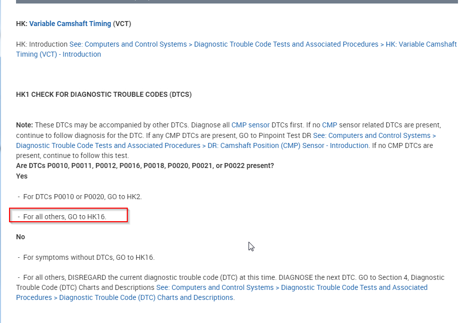

The diagnostics are extensive for the code. I wanted to confirm there were no others before overwhelming you. However, if there are no others, here are the diagnostics. Take a look through them and let me know if you need help or have questions.
_________________________
2006 Ford Truck F 150 4WD Pickup V8-5.4L VIN 5
HK: Variable Camshaft Timing (VCT) - Pinpoint Test
Vehicle Powertrain Management Computers and Control Systems Testing and Inspection Pinpoint Tests HK: Variable Camshaft Timing (VCT) - Pinpoint Test
HK: VARIABLE CAMSHAFT TIMING (VCT) - PINPOINT TEST
HK: Introduction See: Computers and Control Systems > Diagnostic Trouble Code Tests and Associated Procedures > HK: Variable Camshaft Timing (VCT) - Introduction
HK1 CHECK FOR DIAGNOSTIC TROUBLE CODES (DTCS)
Note: These DTCs may be accompanied by other DTCs. Diagnose all CMP sensor DTCs first. If no CMP sensor related DTCs are present, continue to follow diagnosis for the DTC. If any CMP DTCs are present, GO to Pinpoint Test DR See: Computers and Control Systems > Diagnostic Trouble Code Tests and Associated Procedures > DR: Camshaft Position (CMP) Sensor - Introduction. If no CMP DTCs are present, continue to follow this test.
Are DTCs P0010, P0011, P0012, P0016, P0018, P0020, P0021, or P0022 present?
- For DTCs P0010 or P0020, GO to HK2.
- For all others, GO to HK16.
- For symptoms without DTCs, GO to HK16.
- For all others, DISREGARD the current diagnostic trouble code (DTC) at this time. DIAGNOSE the next DTC. GO to Section 4, Diagnostic Trouble Code (DTC) Charts and Descriptions See: Computers and Control Systems > Diagnostic Trouble Code Tests and Associated Procedures > Diagnostic Trouble Code (DTC) Charts and Descriptions.

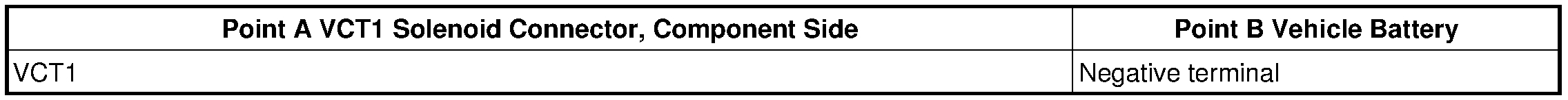

HK4 CHECK THE VCT1 SOLENOID RESISTANCE
- Ignition OFF.
- VCT1 Solenoid connector disconnected.
- Measure the resistance between:
PIC 1
Is the resistance between 5 - 14 ohms?
- GO to HK5.
- INSTALL a new VCT1 solenoid. REFER to Computers and Control Systems, Electronic Engine Controls.
- CLEAR the DTCs. REPEAT the self-test.

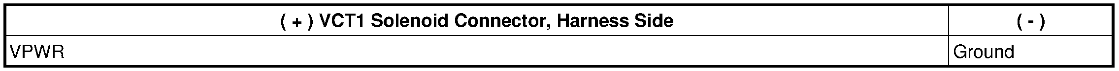

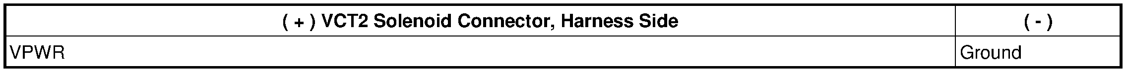

HK6 CHECK THE VPWR CIRCUIT FOR AN OPEN IN THE HARNESS
- Ignition ON, engine OFF.
- Measure the voltage between:
pic 3
Is the voltage greater than 10 V?
- GO to HK7.
- REPAIR the open circuit. CLEAR the DTCs. REPEAT the self-test.

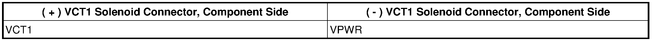

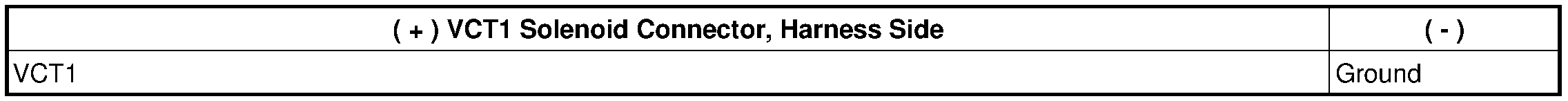

HK7 CHECK THE VCT1 CIRCUIT FOR A SHORT TO POWER IN THE HARNESS
- Ignition OFF.
- PCM connector disconnected.
pic 4
Is the voltage less than 1 V?
- GO to HK8.
- REPAIR the short circuit. CLEAR the DTCs. REPEAT the self-test.

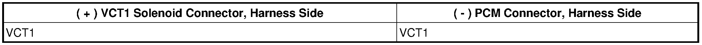

HK8 CHECK THE VCT1 CIRCUIT FOR AN OPEN IN THE HARNESS
- Ignition OFF.
pic 5
Is the resistance less than 5 ohms?
- GO to HK9.
HK9 CHECK THE VCT1 CIRCUIT FOR A SHORT TO GND IN THE HARNESS
pic 6
Is the resistance greater than 10K ohms?
- GO to HK20.

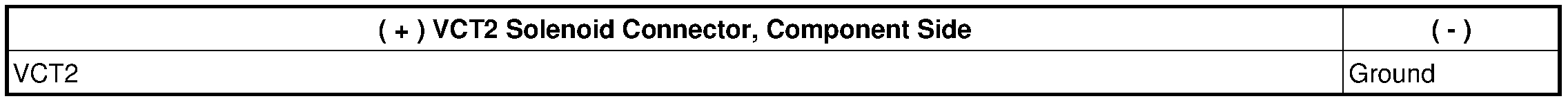

HK10 DTC P0020: CHECK THE VCT2 SOLENOID RESISTANCE
- Ignition OFF.
- VCT2 Solenoid connector disconnected.
pic 7
- GO to HK11.
- INSTALL a new VCT2 solenoid. REFER to Computers and Control Systems, Electronic Engine Controls.

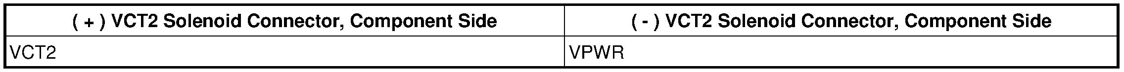

HK11 CHECK THE VCT2 SOLENOID FOR INTERNAL SHORTS
pic 8
- GO to HK12.
HK12 CHECK THE VPWR CIRCUIT FOR AN OPEN IN THE HARNESS
pic 9
- GO to HK13.

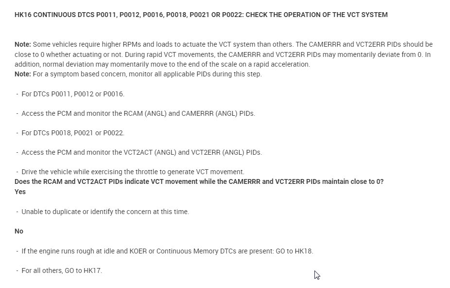

HK16 CONTINUOUS DTCS P0011, P0012, P0016, P0018, P0021 OR P0022: CHECK THE OPERATION OF THE VCT SYSTEM
Note: Some vehicles require higher RPMs and loads to actuate the VCT system than others. The CAMERRR and VCT2ERR PIDs should be close to 0 whether actuating or not. During rapid VCT movements, the CAMERRR and VCT2ERR PIDs may momentarily deviate from 0. In addition, normal deviation may momentarily move to the end of the scale on a rapid acceleration.
Note: For a symptom based concern, monitor all applicable PIDs during this step.
- For DTCs P0011, P0012 or P0016.
- Access the PCM and monitor the RCAM (ANGL) and CAMERRR (ANGL) PIDs.
- For DTCs P0018, P0021 or P0022.
- Access the PCM and monitor the VCT2ACT (ANGL) and VCT2ERR (ANGL) PIDs.
- Drive the vehicle while exercising the throttle to generate VCT movement.
Does the RCAM and VCT2ACT PIDs indicate VCT movement while the CAMERRR and VCT2ERR PIDs maintain close to 0?
- Unable to duplicate or identify the concern at this time.
- If the engine runs rough at idle and KOER or Continuous Memory DTCs are present: GO to HK18.
- For all others, GO to HK17.

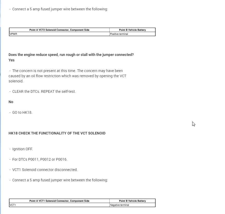

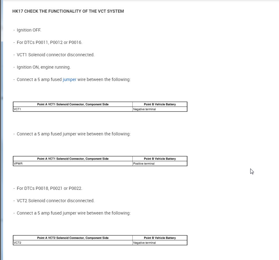

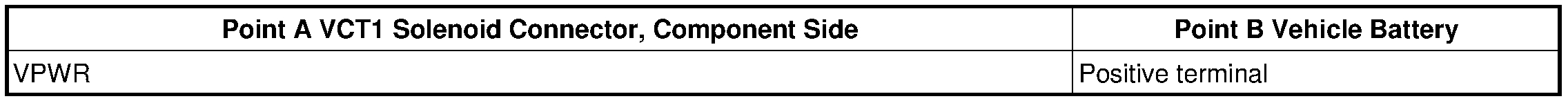

HK17 CHECK THE FUNCTIONALITY OF THE VCT SYSTEM
- Ignition OFF.
- Ignition ON, engine running.
- Connect a 5 amp fused jumper wire between the following:
pic 13
pic 14

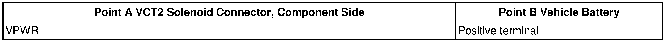

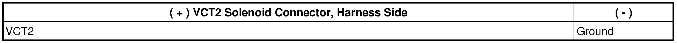

pic 15
pic 16
Does the engine reduce speed, run rough or stall with the jumper connected?
- The concern is not present at this time. The concern may have been
caused by an oil flow restriction which was removed by opening the VCT
solenoid.
- GO to HK18.

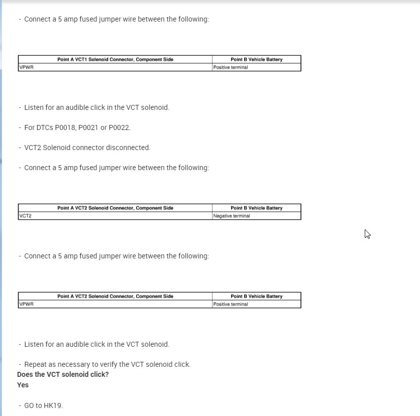

HK18 CHECK THE FUNCTIONALITY OF THE VCT SOLENOID
- Ignition OFF.
pic 17
pic 18
- Listen for an audible click in the VCT solenoid.

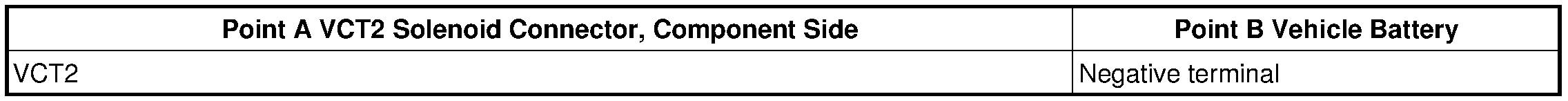

pic 19
pic 20
- Repeat as necessary to verify the VCT solenoid click.
Does the VCT solenoid click?
- GO to HK19.
- INSTALL a new VCT solenoid.
- Refer to Computers and Control Systems, Electronic Engine Controls.

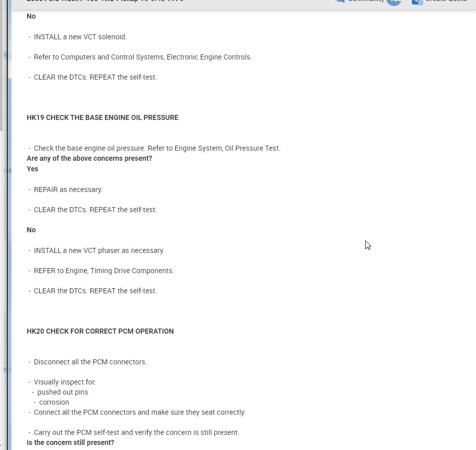

HK19 CHECK THE BASE ENGINE OIL PRESSURE
- Check the base engine oil pressure. Refer to Engine System, Oil Pressure Test.
Are any of the above concerns present?
- REPAIR as necessary.
- INSTALL a new VCT phaser as necessary.
- REFER to Engine, Timing Drive Components.

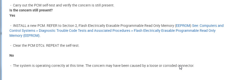

HK20 CHECK FOR CORRECT PCM OPERATION
- Disconnect all the PCM connectors.
- Visually inspect for:
- pushed out pins
- corrosion
- Connect all the PCM connectors and make sure they seat correctly.
- Carry out the PCM self-test and verify the concern is still present.
Is the concern still present?
- INSTALL a new PCM. REFER to Section 2, Flash Electrically Erasable Programmable Read Only Memory (EEPROM) See: Computers and Control Systems > Diagnostic Trouble Code Tests and Associated Procedures > Flash Electrically Erasable Programmable Read Only Memory (EEPROM).
- Clear the PCM DTCs. REPEAT the self-test.
- The system is operating correctly at this time. The concern may have been caused by a loose or corroded connector.
