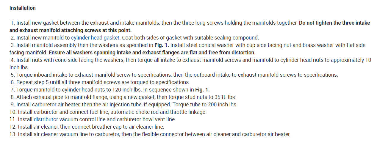

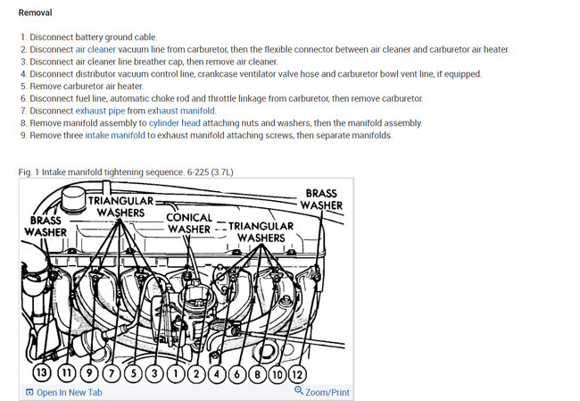

Slant six 225 motor exhaust manifold coil broke off heat riser. where can I get another coil and how does the front of pulley come off ?
Apr 29, 2021 at 12:19 PM
Experienced Mechanic
52,796 POSTS
Good morning,

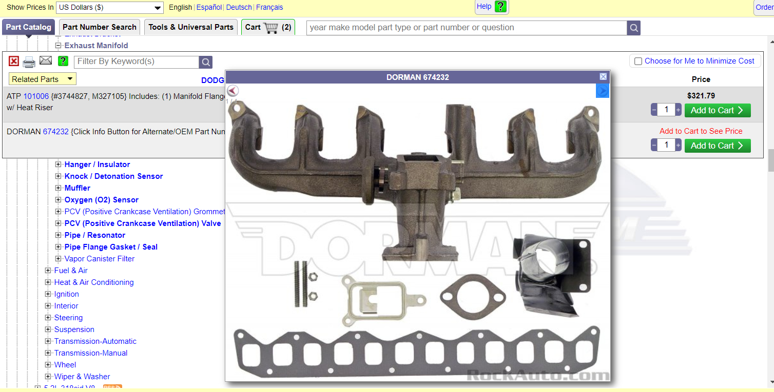

They do not offer the spring anywhere. The only repair is to replace the manifold.
I attached the procedure below for you for the repair as well as the part.
