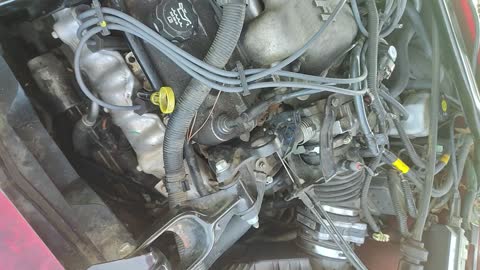

Here is the video requested.
Mar 18, 2025 at 1:42 AM
  • 55,282 POSTS
It is hard to tell from the video, can you film the engine from under the hood? From what I can tell from this video it is not good, but I want to be sure.

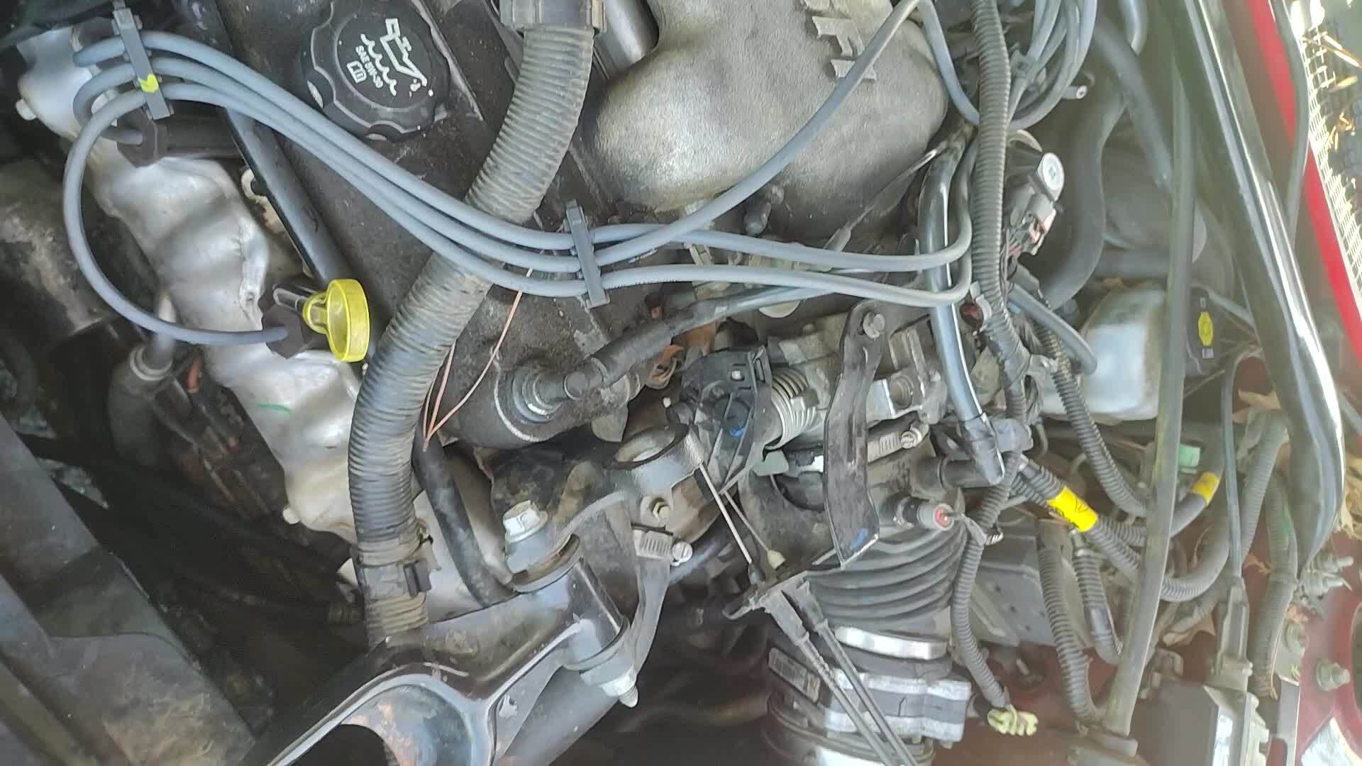

Yeah sure thing sorry about that.
Mar 18, 2025 at 6:33 AM
DANIEL NELSON2
  • 44 POSTS
So anything?
Mar 19, 2025 at 12:48 AM
  • 55,282 POSTS
Wow, that engine is hurt, sorry. The engine will need to come apart to see what happened. You can confirm it with a compression test. Thanks for the video, it makes things easier for us.
