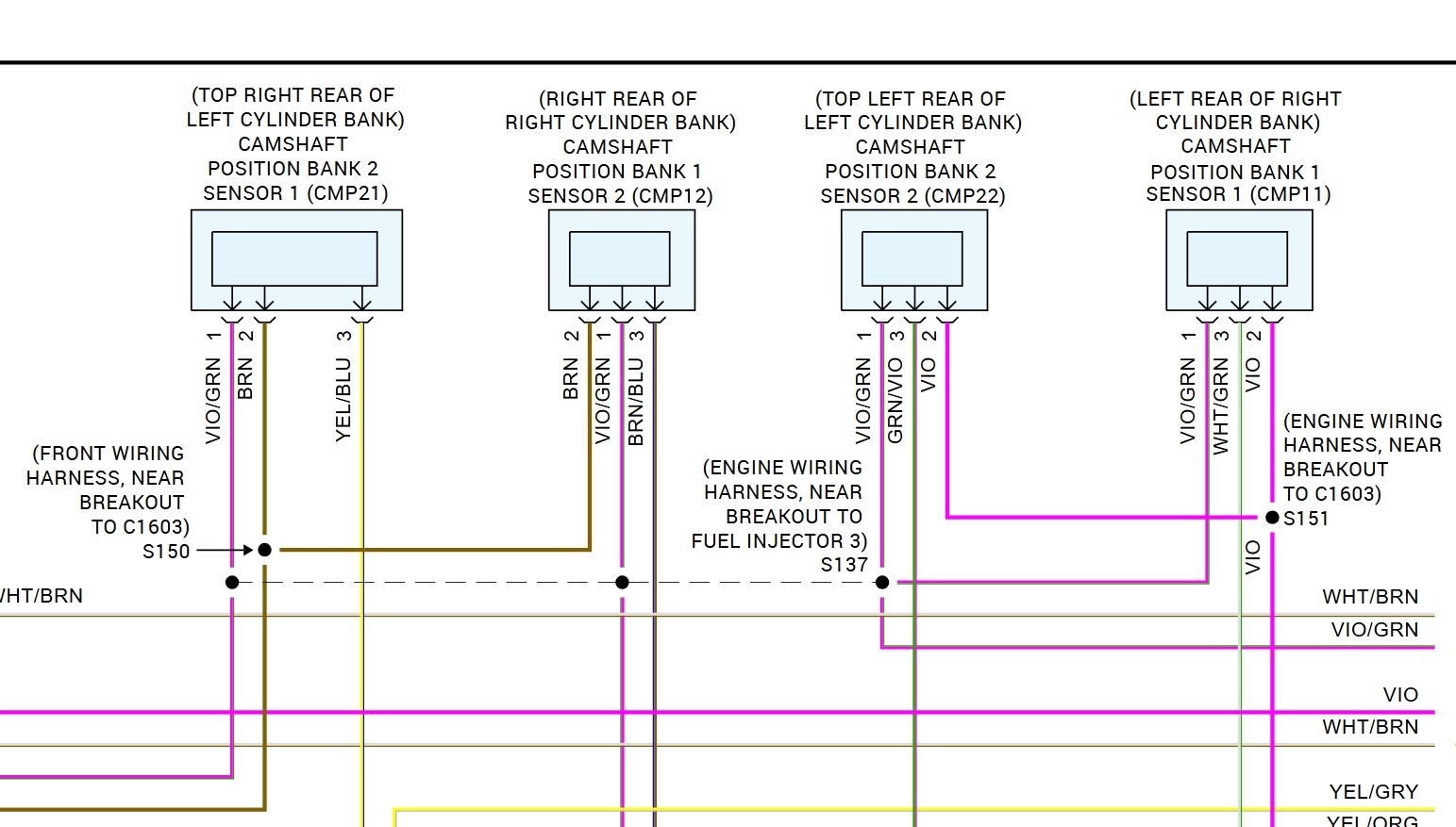

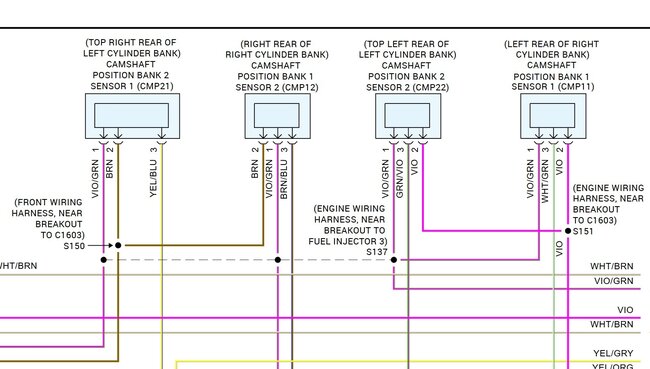

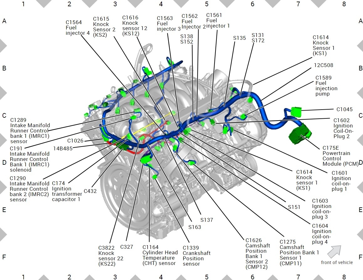

P0300- random multiple misfires, P0308 - misfire cylinder 8, P0355 and P0349 both are for cam sensor bank 2 sending intermittent signal to the PCM. I would start with a good inspection of the engine wiring harness. Especially where it comes over the edge of the cylinder head up front. Look for damage to the loom or the tape and possibly a broken wire from the cam sensor. That harness also carries the injector controls and knock sensors. If only a couple wires were damaged it could be that the engine flexing during the drag racing is causing shorts in the signals.

I have checked for all that and nothing seems to be damaged or disconnected.

Okay, so, these codes were before all the work and are still there? What else was done with the CAI? This is the original engine and all? I would go over the harness, peel off the tape and loom and really inspect the wiring. Wires can look perfect but be damaged inside. I would also use a scope to check the signals coming into the PCM, The P0349 can shut off the engine, so I would look at that sensor and it's wiring first.
