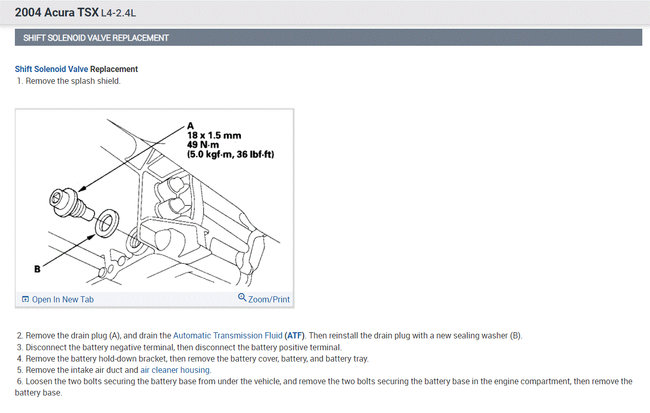

The idea that it revs high and you can't go faster leads me to believe it is related to the shift solenoid indicated in the diagnostic trouble code.
The shift solenoid is responsible for shifting to the next gear. Basically, it's the same as if you were driving a vehicle with a manual transmission and never up-shifting. (if that makes sense LOL)

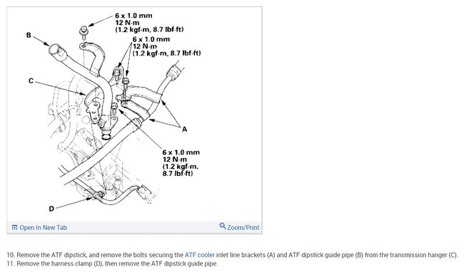

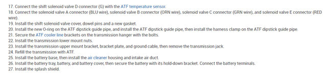

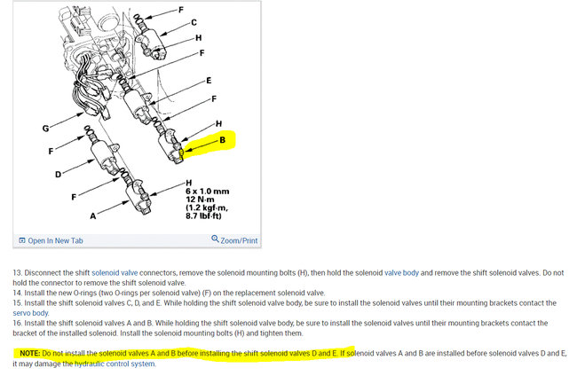

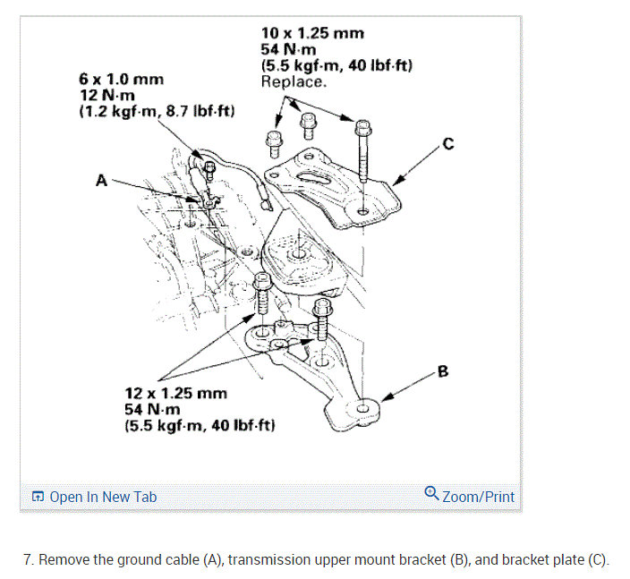

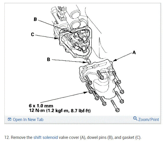

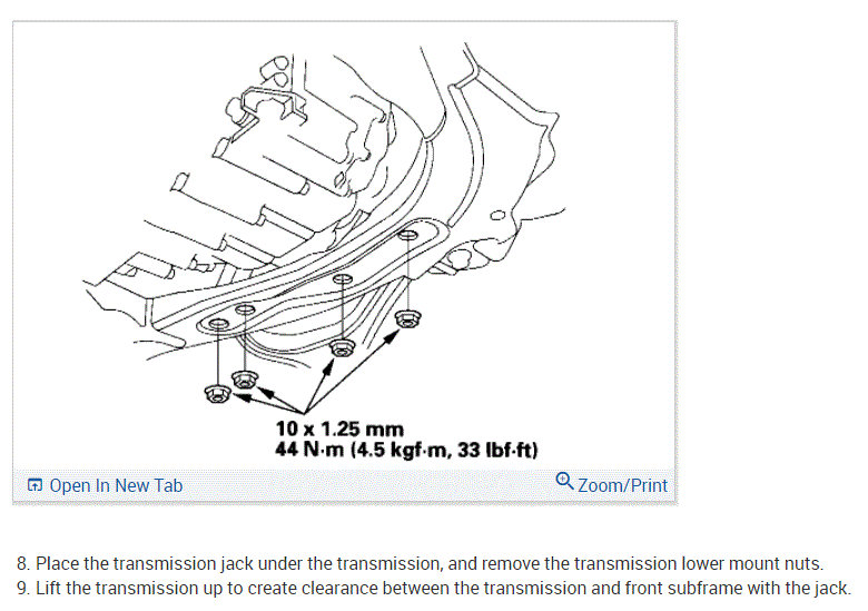

To replace the shift solenoid, you will need to remove the shift solenoid valve cover on the transmission. This will require draining the fluid, supporting the transmission, A/T cooler line brackets, and a few other things to access the solenoid.
I attached the directions for the procedure below. I highlighted the solenoid in question and an important note under it. Note that you shouldn't have to remove any of the other solenoids to replace solenoid B.
Aug 18, 2021 at 6:41 AM

So then solenoid b would be the last one towards the bottom on the right correct? I just want to be sure. So I'll just disconnect the connector and remove and place new one then connect it and put everything else back together.
Aug 27, 2021 at 12:13 AM
  • 110,251 POSTS
I looked at the pic from the manual and see why you may be confused. It does appear to be the bottom right. And yes, once you remove and replace it, put it back together.
Let me know if I can help in any way. Also, if you have a chance, let me know how things work out for you. I'm interested in knowing.

So I changed out the shift solenoid and the car was driving perfect for about 20 to 25 minutes. About the first 15 minutes it was street driven then the rest I got onto the freeway and once I hit uphill the car went back to doing the same thing and more often there were no codes and the only code I got was a 45-06 and shift malfunction. Is it time to just invest into a new transmission at this point? after believing the issue was finally gone due to it driving great I just couldn't believe it was too good to be true. :(

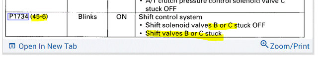

If it was working properly, are you sure the wiring wasn't an issue? I've seen a breakdown under the insulation causing problems. One minute there is a connection and movement causes that to change.
Did you check all connections and the wiring when you did the work?
If the trans was working correctly, there is an issue either with a bad solenoid or shift valve is stuck. This repair is much cheaper than a new trans.

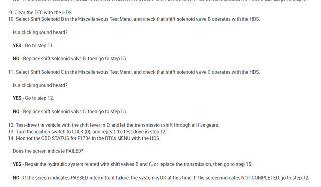

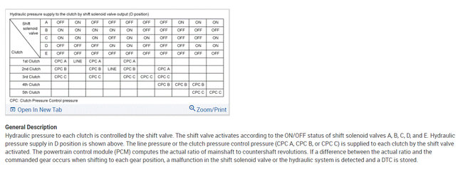

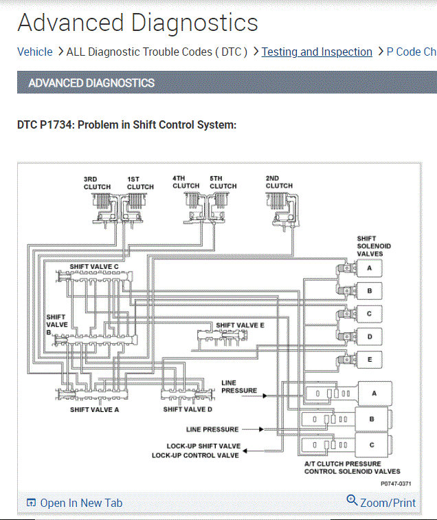

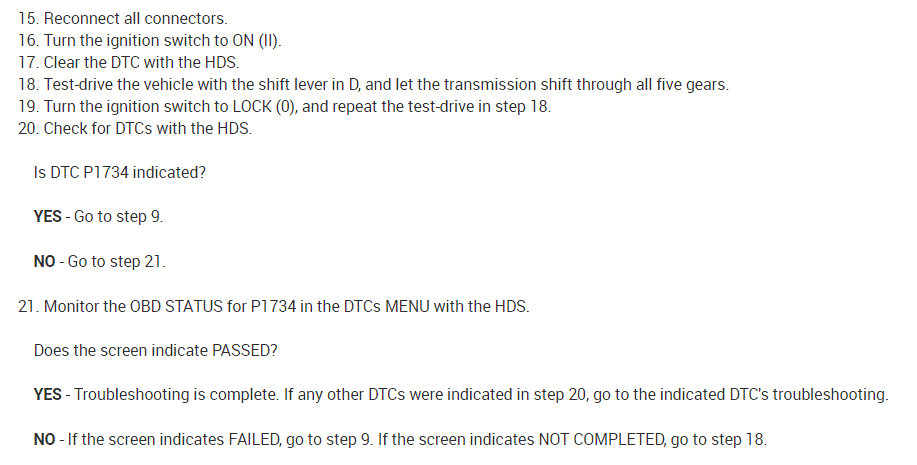

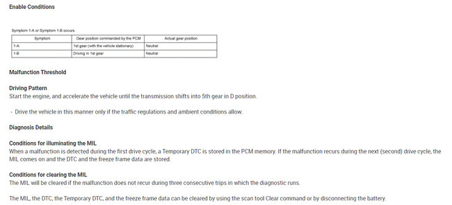

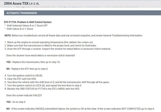

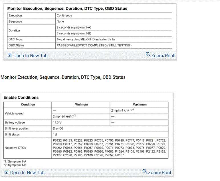

The code you provided, 45-06 (P1734), can be either with solenoid B or C. Your last post is the first I saw it. Do me a favor. Take a look through the diagnostics below and let me know if you are comfortable performing them. You will need a scan tool that can actuate solenoids.
Note: The first pic below shows the definition of the code, pics 2 - 4 are the diagnostics, and the last pics are advanced diagnostics.
Let me know. And again, I don't (at this point) feel the transmission is bad.
