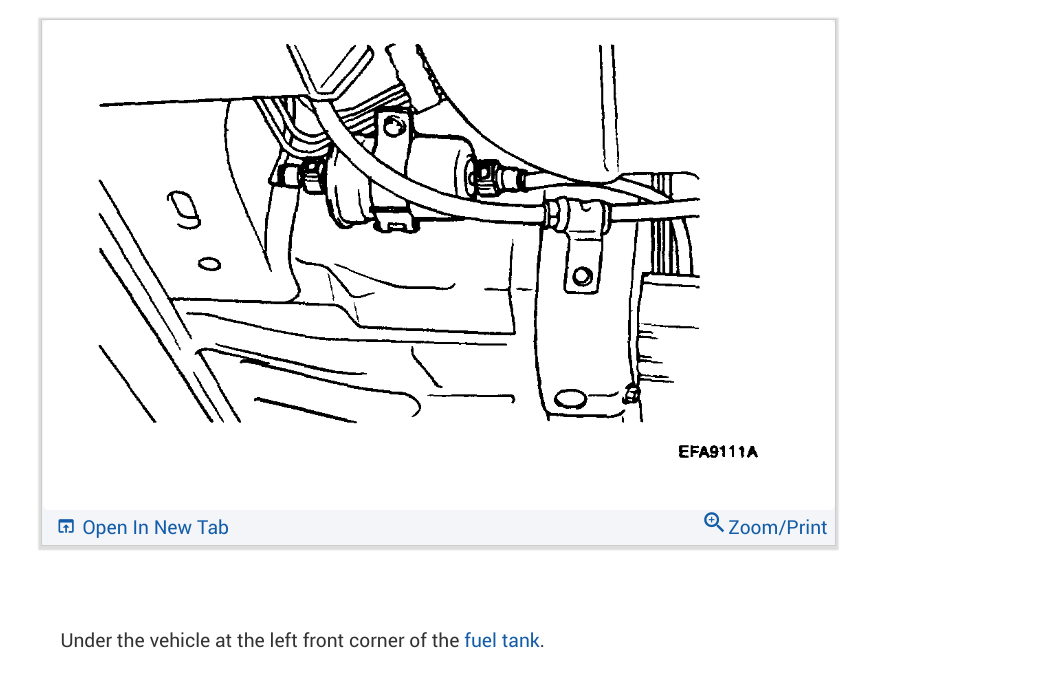

I've raised the car and traced the fuel lines under the car from tank to firewall and no luck.

It's by the left front corner of the fuel tank. I have the information and a diagram of it in the diagrams down below. I hope this helps.

Drivers left are passengers left side

That is the passengers side left.
