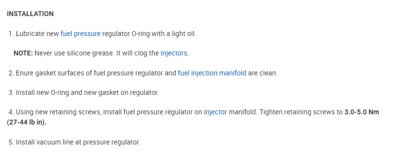

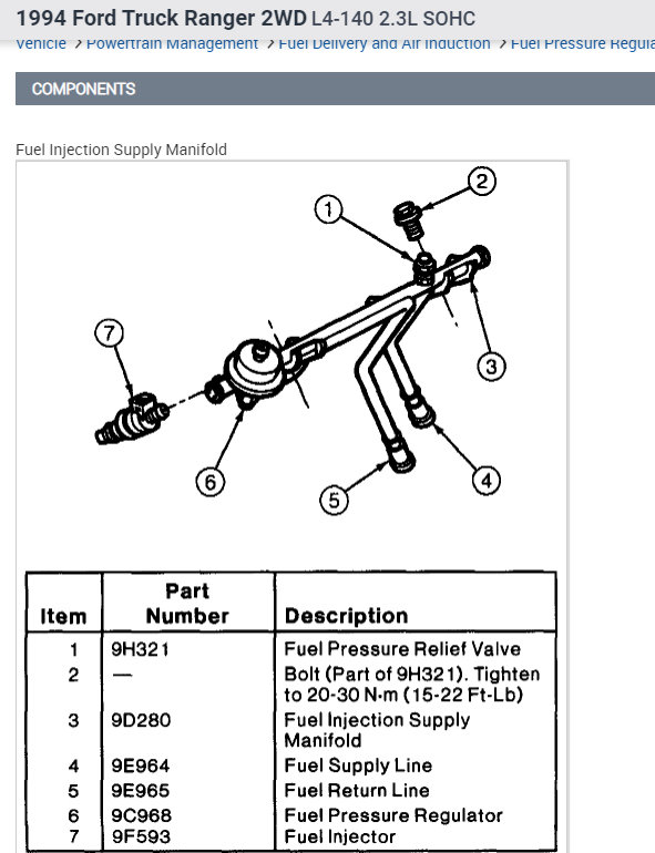

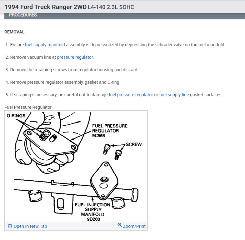

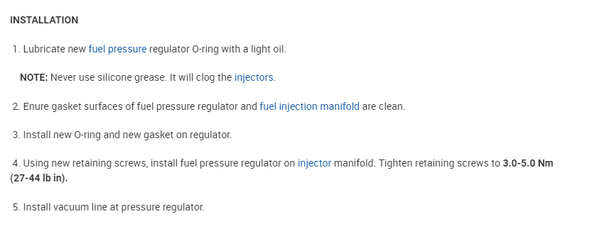

I have attached the fuel pressure regulator replacement guide below for your reference.
