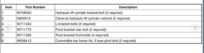

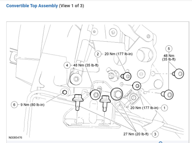

I was unable to download the manual. However, I did attach what I have below. The first pic shows the bolts related to the top. Pic two identifies the bolt and the part number.
Take a look through this and let me know if you see what is needed.

Thanks for the reply. Unfortunately, it is none of these bolts.

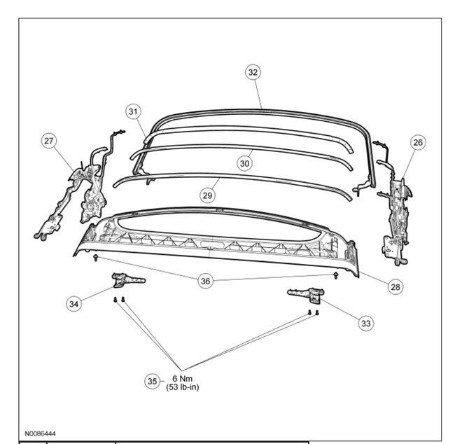

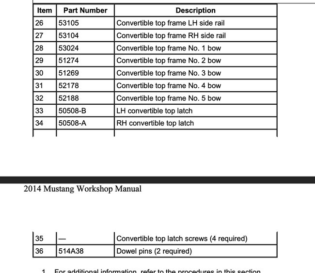

I have attached a screenshot from the manual of the part I am looking for. It's the bolts that connect to 30 from 26/27.

Here is a second shot showing the parts list. You'll notice that one potential candidate for the bolt is #35, but unfortunately there's no part number...

I went through everything I could find. There is nothing listed for the bow pivot bolt part number. By chance, do you have a pic of what came off the top?
