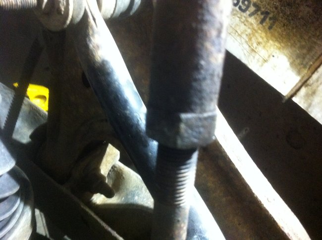

Well I changed the bearing that went good an now my damn issue is this outter tie rod will not free from the inner.I tried a bunch of penetrating oil an heat. Will not come loose. Looks like I will be replacing inner as well but need to get this outter off for now. Any suggestions will help. Thanks.

If it is the outer you ned to loosen the jam nut otherwise it will give you problems
Sunday, June 25th, 2017 AT 9:51 AM
ITISME201411
  • 33 POSTS
The jam nut will not losen.
Sunday, June 25th, 2017 AT 12:51 PM
HMAC300
  • 48,601 POSTS
Try this, heat with a propanetorch then cool with penetrating oil and tap nut with a small hammer all around then repeat this 5 times and then see if nut will turn away from tie rod end.
Sunday, June 25th, 2017 AT 3:26 PM
ITISME201411
  • 33 POSTS

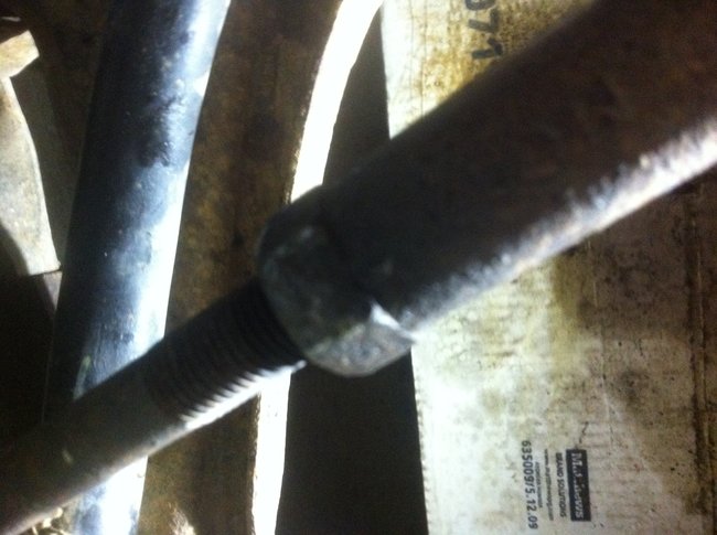

I tried that a few times. Will not losen.I am going to change the inner one to. Can I remove the inner tie rod while the outter one is still attached to it?Here are a couple pics of the nut I cannot losen.
Sunday, June 25th, 2017 AT 10:16 PM
HMAC300
  • 48,601 POSTS
Have you tried what I suggested by heating then cooling with the penetrating oil an dtapping nut all around? That usually works you can pull the inner and outer with no problem other than the boot will have to be replaced on to new inner.
Monday, June 26th, 2017 AT 7:11 AM
ITISME201411
  • 33 POSTS
Yes I did tap it. Not sure what the deal is. The inner one is going bad anyway. Its not tight in the joint. Lits of play.I was going to replace that next pay day. But I'll just do it now. Thanks for the advice. This site helps allot

I tried the heat, cooling, an tapping one more time an it popped loose. It did not work the first few times I tried. Anyway, rented the tie rod adapters an the inner came out easy. Put all the new parts on an just got a wheel alignment. Good to go. Appreciate the help you guys give. It helps allot. Especially for someone like me who likes doing my own work.
