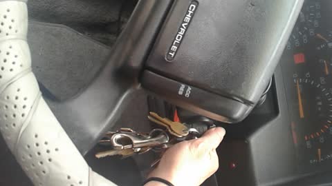

Ran it out off gas now won't start up again, then the key didn't do anything any more. Was getting no power to starter no more so put a push button. Got spark, checked fuel pump, fine.
The purple wire from starter goes to a relay. I am not sure but I think when the ignition stopped working. Maybe everything on that relay went out?How would I test to see if I am getting power to injectors?

It cranks and cranks almost sounds like it going to start, like it needs to back fire, but don't start. Yes I can here fuel pump running when I turn the ignition to on position and I unplugged fuel hose after the filter and gas is coming out good.

It would start every time till one day I took my kids to school and ran out of gas when I got gas it started for a few seconds and then died a couple times then the ignition wouldn't do anything since I tested for power at the starter there wasn't none so I installed a push button toggle. There are 3 big relays that all the wires go to on the firewall, I'm thinking when I bypassed ignition, that relay powers more then just my cognition?It's something telling it not to start?Tested fuel, spark plug and wire and coil.

So is the engine cranking and not starting or not cranking over? Can you please shoot a quick video with your phone so we can see what's going on, that would be great. You can upload it here with your response.

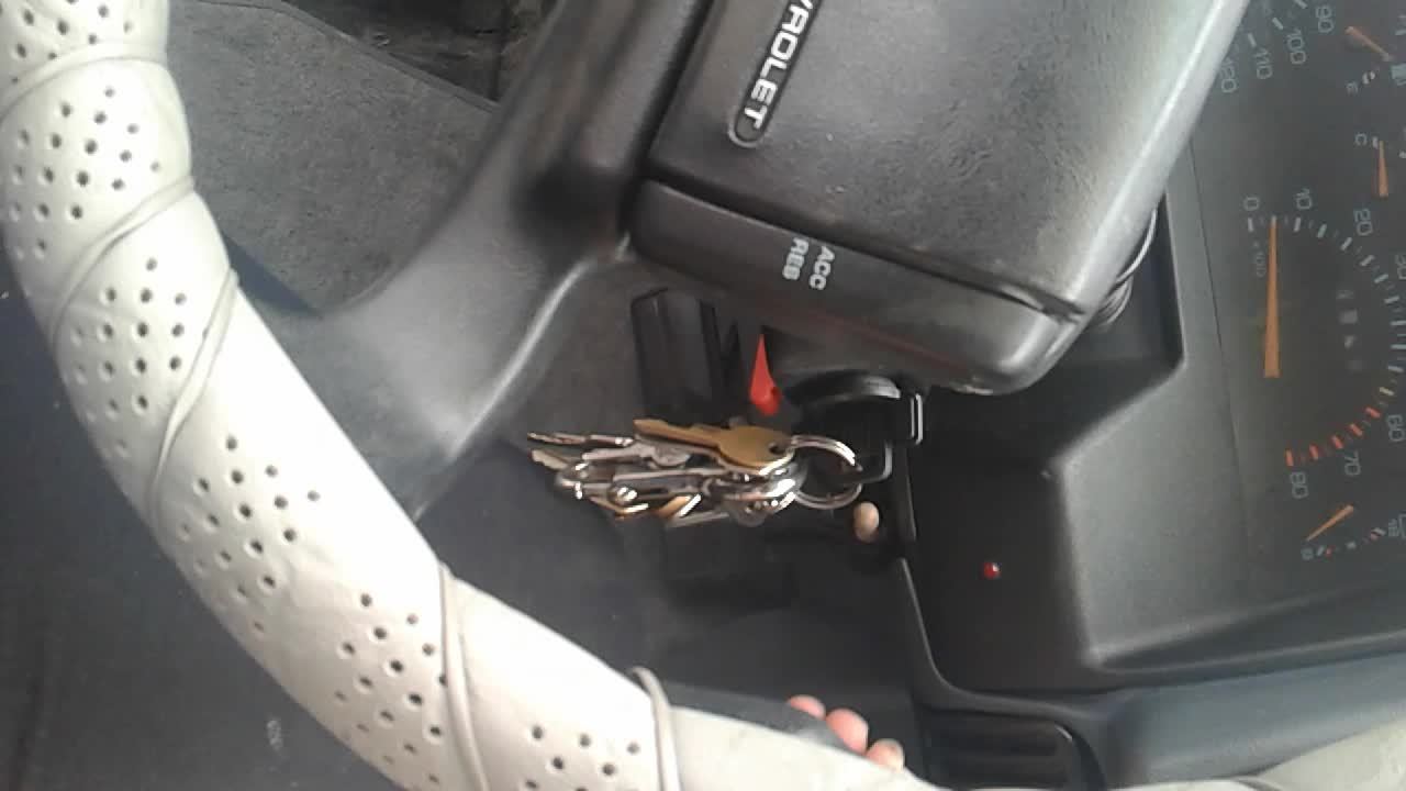

Not sure if you got video?
Thursday, September 26th, 2019 AT 2:23 PM
KEN L
  • MASTER CERTIFIED MECHANIC
  • 54,333 POSTS
I dont see it? Did you upload it?
Friday, September 27th, 2019 AT 4:33 PM
LISA MARTINEZ
  • 23 POSTS
I did twice.

Thank for the video. it sounds like the fuel pump has gone out (no pressure). To confirm here is a guide to help test the fuel pressure:
You can also use starting fluid to see if it will run.

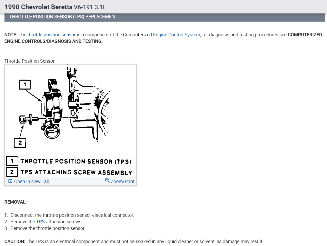

I am getting good fuel pressure, reading a code 12 and 22.
Wednesday, October 16th, 2019 AT 3:59 PM
KEN L
  • 54,333 POSTS
Code 22 is the TPS sensor out which can cause the issue. Here is how you replace it. Check out the diagrams (below). Please let us know what you find.
Saturday, October 19th, 2019 AT 10:18 AM
LISA MARTINEZ
  • 23 POSTS

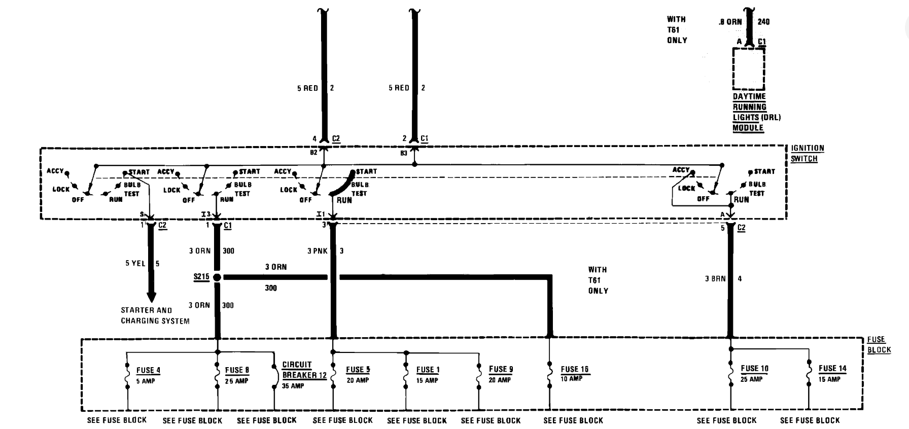

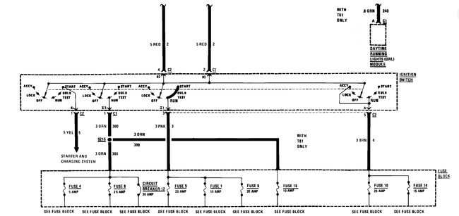

Nope it's good. I have a question, if ignition went out it would tell the PCM cannot start. How to clear codes and how does it know that it has a new one or bypass?
Saturday, October 19th, 2019 AT 11:04 AM
KEN L
  • 54,333 POSTS
Yes if the switch went out the PCM will not get power. To be sure here is a guide and the ignition switch wiring so you can test through it. To clear the codes disconnect the battery.
