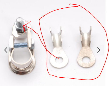

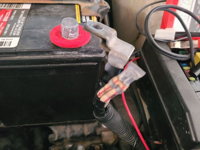

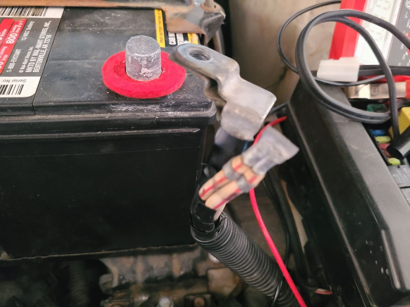

Yesterday, I snapped a wire, and I can't find a new one anywhere. Is there a way to replace it without replacing the entire battery harness? The part number is MR583276.
Aug 28, 2024 at 8:59 AM
  • 110,244 POSTS
I believe I already saw this one. I attached two pictures below. Both parts are from AutoZone.
You need to cut the wires as close to the broken connector as possible, remove approximately 1" pf the insulation from the ends, and crimp them into a connector that will fit the bolt/stud that broke.
You will need a connector that is good for approximately 10-gauge wire. (see pic 2)
Let me know if this helps.
