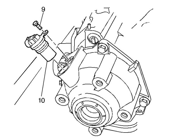

So, all my problems started a while back beginning with the power steering going out randomly, it is working as of right now.. then my speedometer says i am going faster than what I am, then after a wheel bearing being changed to one that wasn't any good the tc light and ABC light came on. now my car will go into reverse but when I put it in drive it acts like it is in neutral until I give it enough speed it then goes straight into second gear and will not shift up or down from there.

The speedometer may be the sensor on the transmission. It usually sets a code when it has failed.

The transmission may be a clogged filter in the pan. I would start with having the transmission service first and see if it helps.
