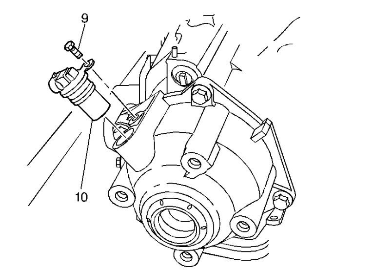

So, all my problems started a while back beginning with the power steering going out randomly, it is working as of right now.. then my speedometer says i am going faster than what I am, then after a wheel bearing being changed to one that wasn't any good the tc light and ABC light came on. now my car will go into reverse but when I put it in drive it acts like it is in neutral until I give it enough speed it then goes straight into second gear and will not shift up or down from there.
Jul 19, 2019 at 1:01 AM
Good afternoon.
The speedometer may be the sensor on the transmission. It usually sets a code when it has failed.
The ABS has a fault code stored. I need that code to narrow the area of failure for you.
https://www.2carpros.com/articles/abs-wheel-speed-sensor-test
The transmission may be a clogged filter in the pan. I would start with having the transmission service first and see if it helps.
