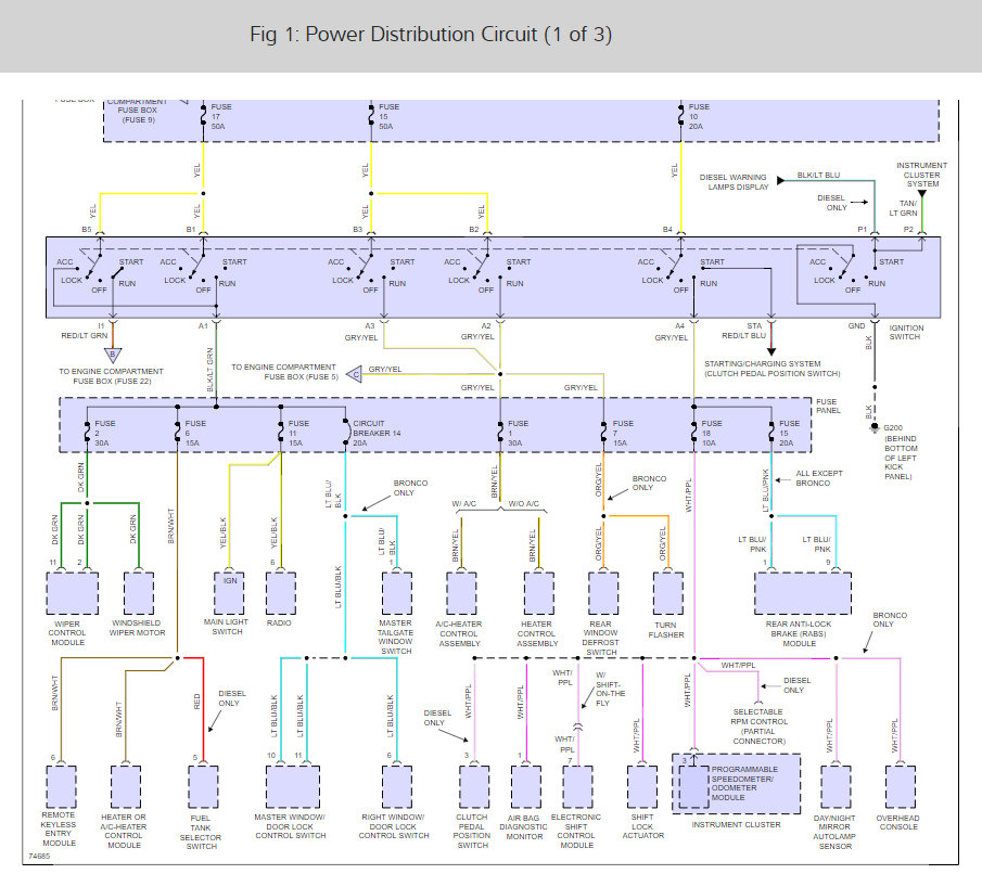

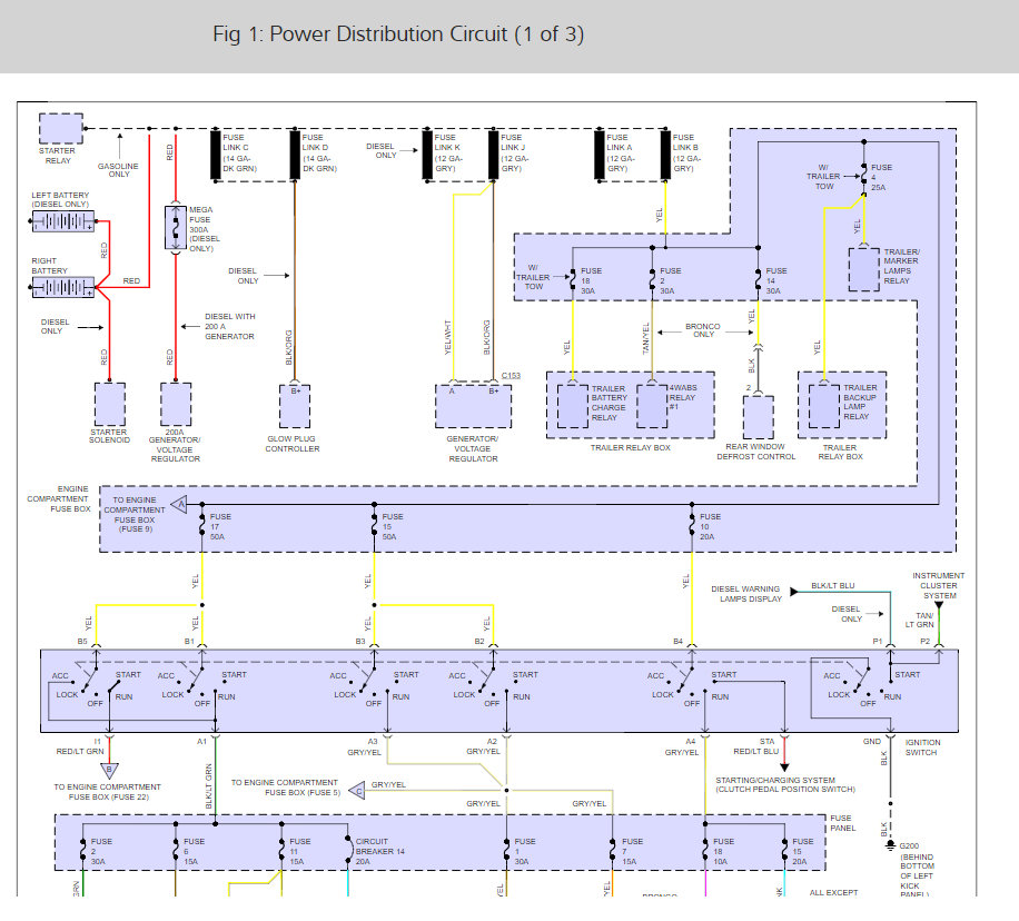

This sounds like you have an ignition switch that has worn out. Through the years the contacts become heated and then they stop working after a short time.

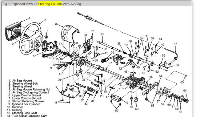

Here is a guide to help you replace the switch and the wiring diagrams to help you confirm the failure:

Yes, classic ignition switch 80% sure. You can test through the switch to confirm when the engine stalls the power will stop coming through the switch at it will be warm.
