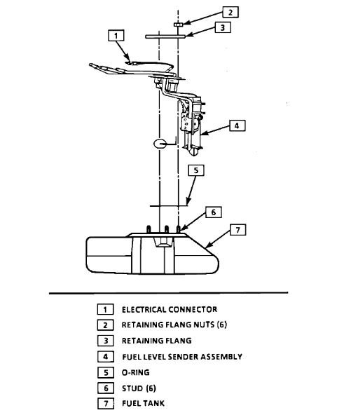

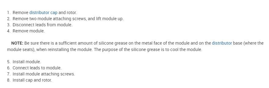

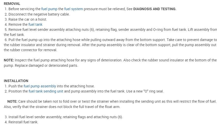

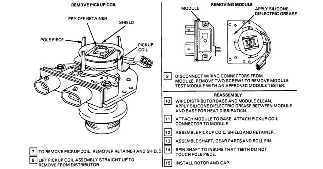

Good morning,
There are a few things that can cause this.
1. Fuel pump. If the pressure is low it will cause the engine to stall while driving from lack of fuel.
2. Loss of spark. That can be from an ignition module or distributor pick up coil in the distributor.
