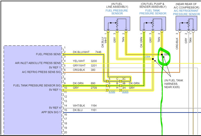

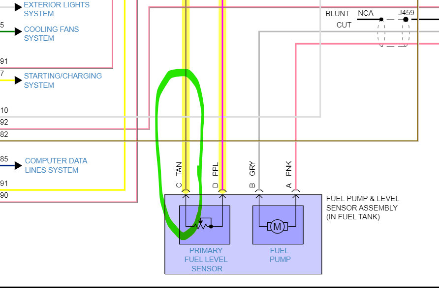

Hello, these are circuit codes, not necessarily a fuel pressure issue, both these two codes P018D and P0463 are for Fuel Pressure sensor "circuit" high and Fuel level sensor "circuit" high input. The Fuel pressure sensor is on the fuel line in this vehicle and the fuel level sensor as you know is in the fuel tank. But these three components share a Ground connection. The Fuel level sensor (1st Diagram), the Fuel Pressure sensor, and the Fuel Tank Pressure sensor all share a Ground together. The Fuel Tank pressure sensor will set an Evap code because it's part of that system.

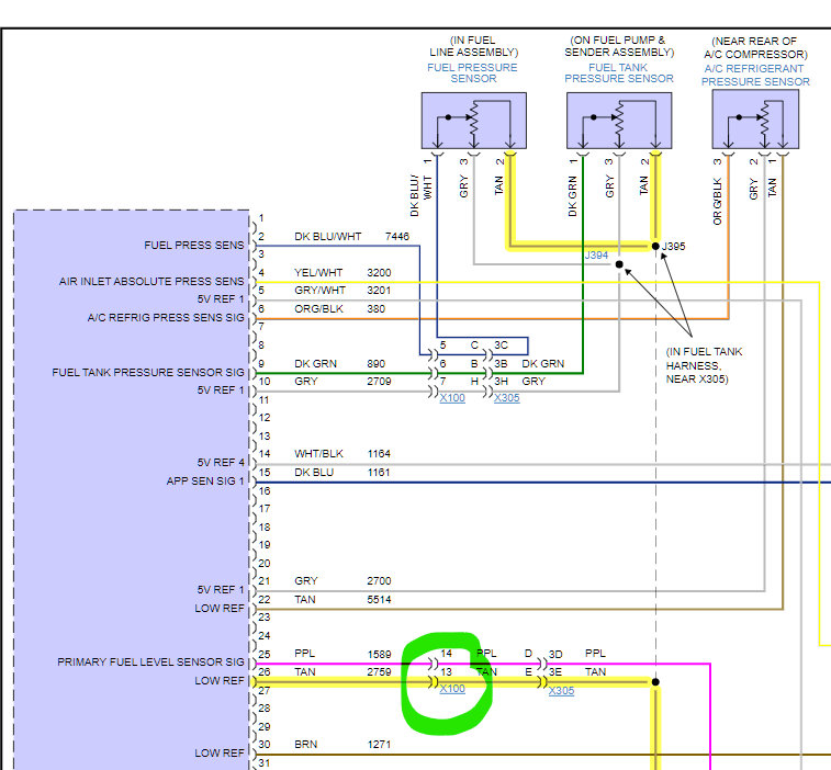

The Ground is circled in green in both diagrams. With a bad Ground wire, it will set voltage high codes because the voltage for the sensor is not being pulled to Ground and the voltage signal stays high. The Ground wire is the one thing that can cause all three of those codes at once. The P0300 is a random misfire code that is the result of the other conditions. You need to track down this Ground wire in the diagrams and find out where it is either broken or has a bad connection.
It's the tan colored wire on all the components, including on top of the fuel tank. These sensors work on a 5-volt Reference circuit, but this explains all the codes together.

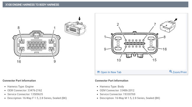

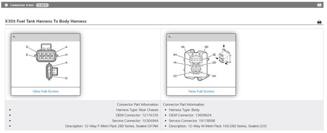

The other two diagrams are the first two connectors coming from those sensors, you'll see them on the wiring diagrams. The X305 is a connection in the fuel tank so I would check the wiring first. Since you have already been in the fuel tank.

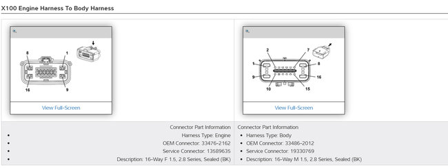

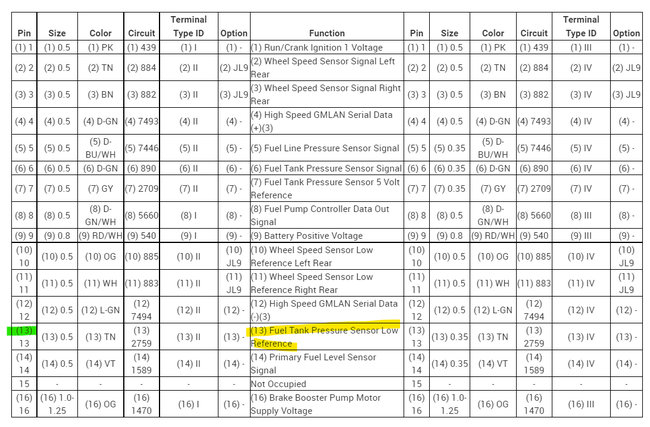

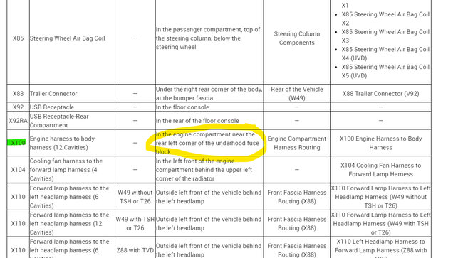

That x100 connection is not on top of the fuel tank though, it is in the engine compartment near a fuse panel. The connector is only listing the Fuel Tank Pressure Sensor Low Reference, but you can see by the last diagram that all 3 low ref (Grounds) run through that connector.

AL W, please accept my apologies for the delayed response! The family has been under the weather, and I haven’t been able to get back to you! The Tan wire in the tank harness was damaged from what looked like debris hitting it. We striped it and spliced it and it totally fixed that problem! You are a life saver!!! My family and I cannot thank you enough!!!
