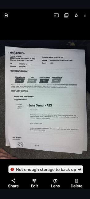

DANGELL
  • 28 POSTS
How do I send a picture to you of what it said? I was actually wrong on the codes for some reason I thought I grabbed a different kind of paper but it says the brake sensor ABS is what it says and it's a p1529 is all that shows up it says replace wheel speed sensor which I've done already I mean I can only find one wheel speed sensor on this car. It doesn't matter where I look I've looked so many different places but there's one on the rear only on the driver side and then there's one on the passenger side up front but I was watching all these different videos however and it kept showing two of them on the front which for the life of me and my friend cannot even remotely find where they're talking about that the front left one is but I've replaced the one on the right front.
Aug 30, 2024 at 1:48 PM
  • 55,732 POSTS
You can upload the images in your response. Also, the pulse generator A and B that control the speedometer and input shaft readings.

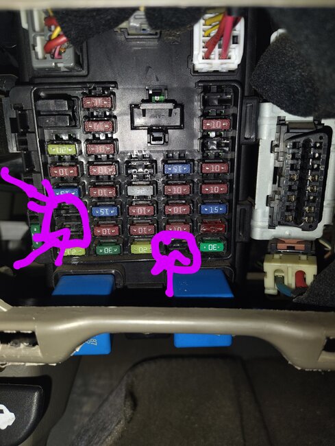

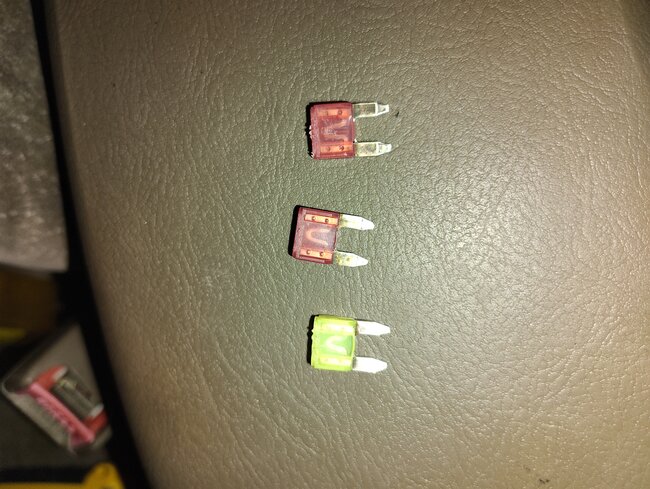

If the speedometer is not working, then the transmission will not shift automatically. Can we check the fuse #14 and #25 in the fuse panel inside the car, these control the TCM. Here is a guide and the fuse locations:
Here are the fuse locations. Test with the key on. if they are okay, I would test the wiring between the output shaft sensor and the TCM.
Sep 15, 2024 at 2:44 AM
DANGELL
  • 28 POSTS
These are the fuses that are not lighting up but look good when I pull them.
Sep 23, 2024 at 12:48 PM
  • 55,732 POSTS
The fuses looks good, it can be normal for the fuses to not light up, was the key on while testing? It does not look like those fuses have anything to do with the system in question, can you confirm by giving me the fuse numbers? Did you check the power and ground to the TCM?

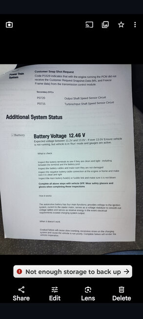

DANGELL
  • 28 POSTS
Here's what codes are. When I test the wires what exactly am I looking for just the continuity or power whatever or what exactly do I need to be looking for whenever we test the wires and you're talking about the wires coming from the TCM to the output sensor right.
Sep 27, 2024 at 7:28 AM
  • 55,732 POSTS
Neither of these codes will cause the problem you are having. Please go over the guide above to test for power and ground to the TCM.
