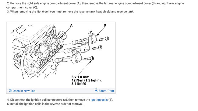

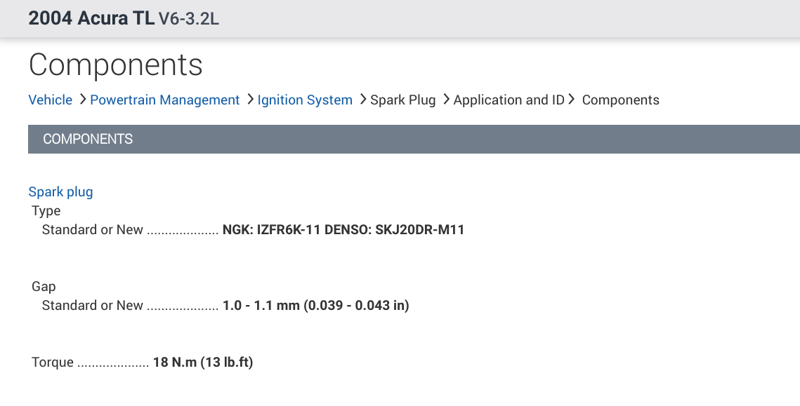

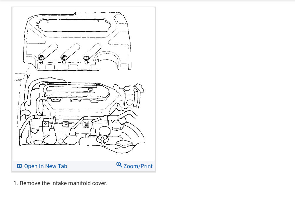

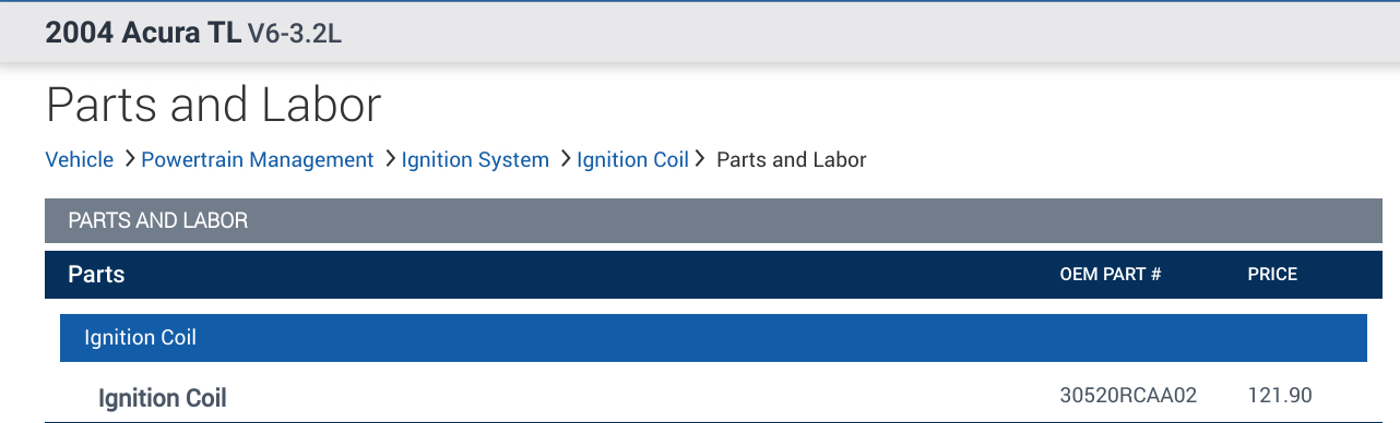

i don't know where the spark plugs are located and what size spark plug wire set i need to get also?
Mar 6, 2020 at 10:49 AM
SCGRANTURISMO
  • 4,897 POSTS

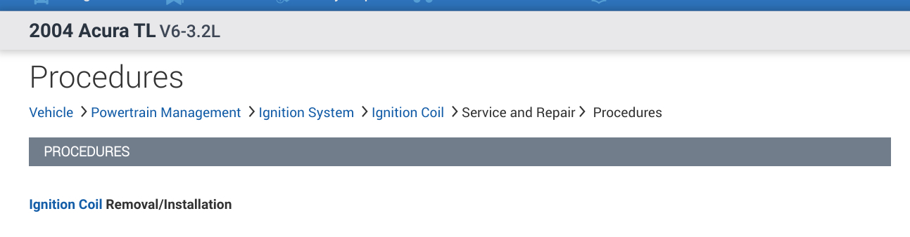

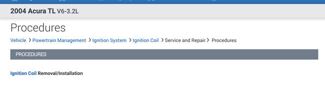

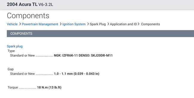

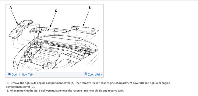

In the diagrams down below I have included the information that you requested. I have included the Original Equipment Manufacturer[OEM] part numbers for the spark plugs and Coil On Plugs[COP] for your vehicle as well as the instructions for the removal and installation of the COPs. Please go through these guides and get back to us with how everything turns out. I hope that this helps.
