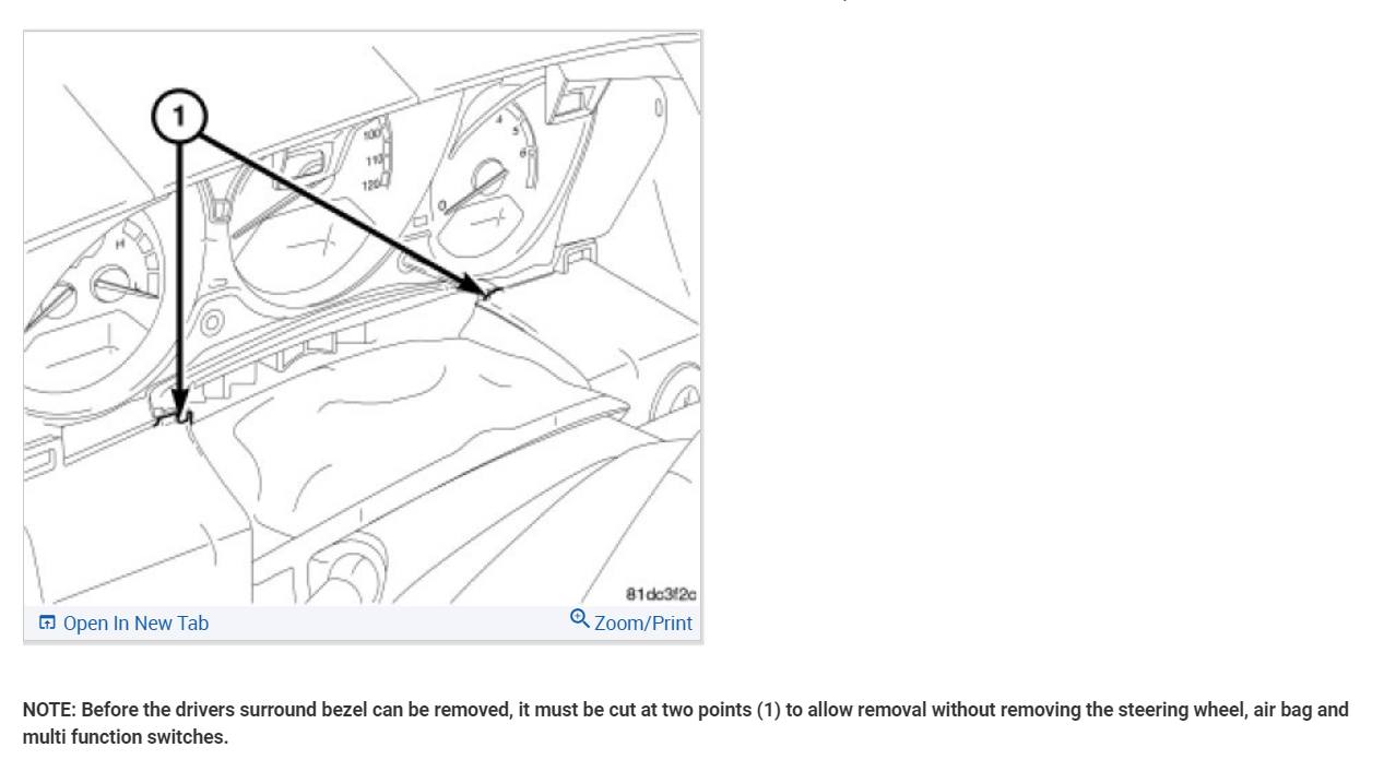

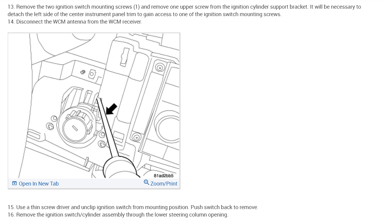

I’m replacing the ignition switch module and I broke the anti-theft module while taking it out. It’s a box that has copper wires the go around a plastic piece where the key goes in if that helps explain it any. If I buy a new anti-theft module, will it have to be programmed?
Jul 11, 2022 at 12:45 PM
  • 55,399 POSTS

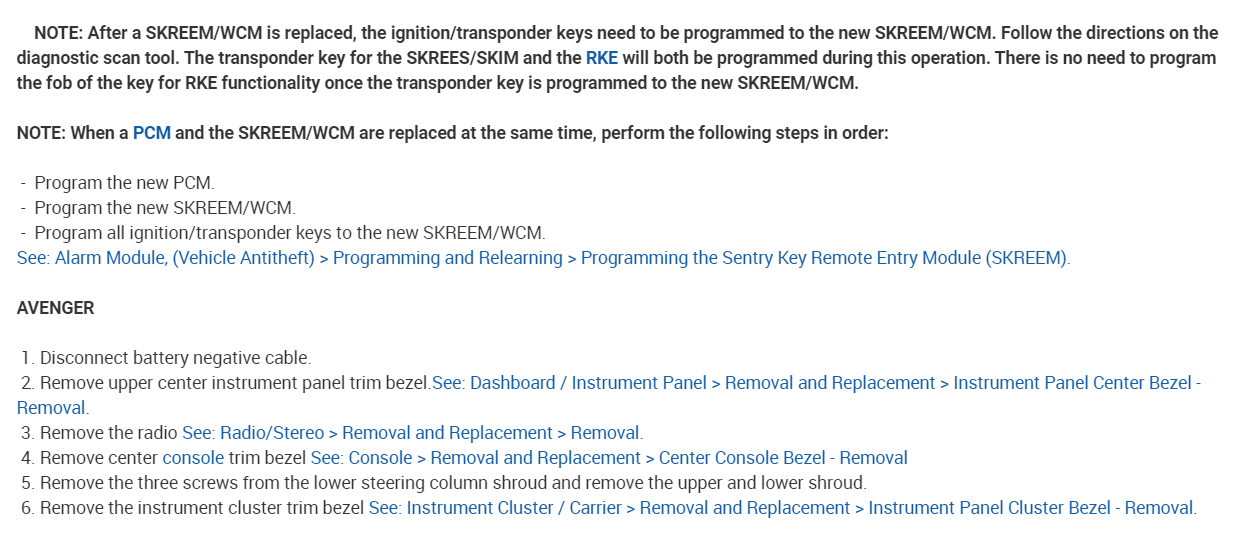

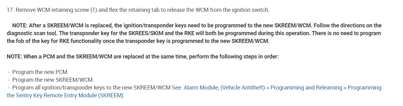

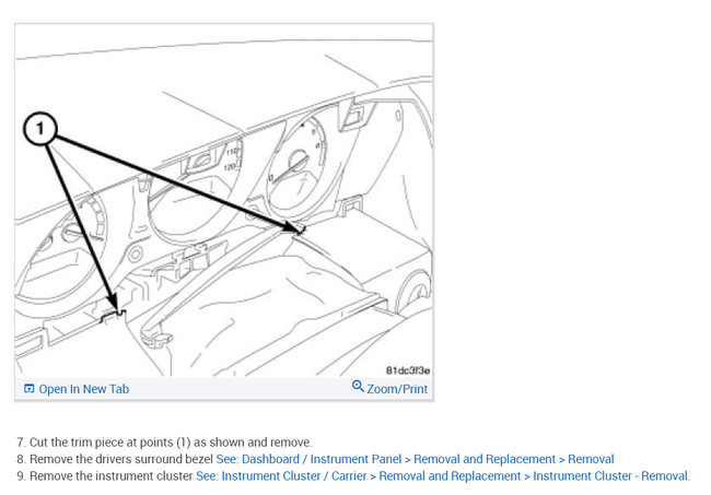

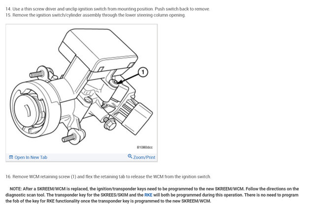

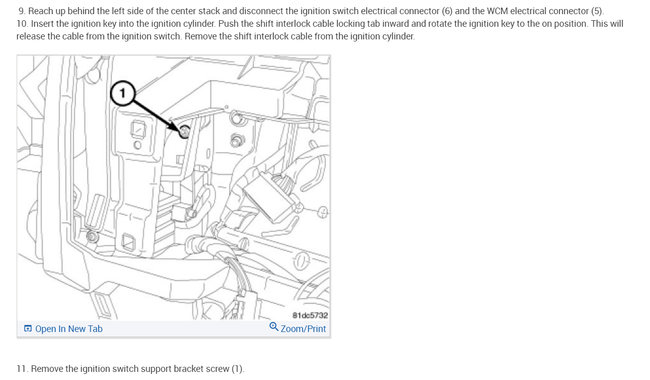

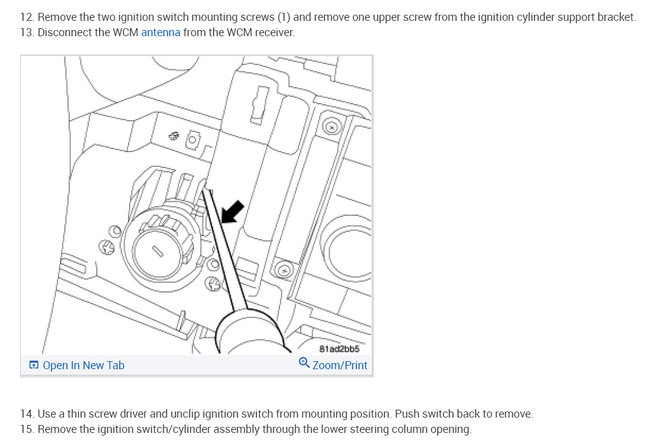

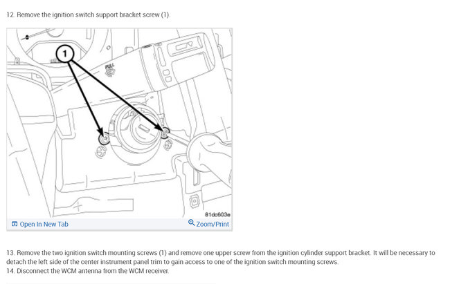

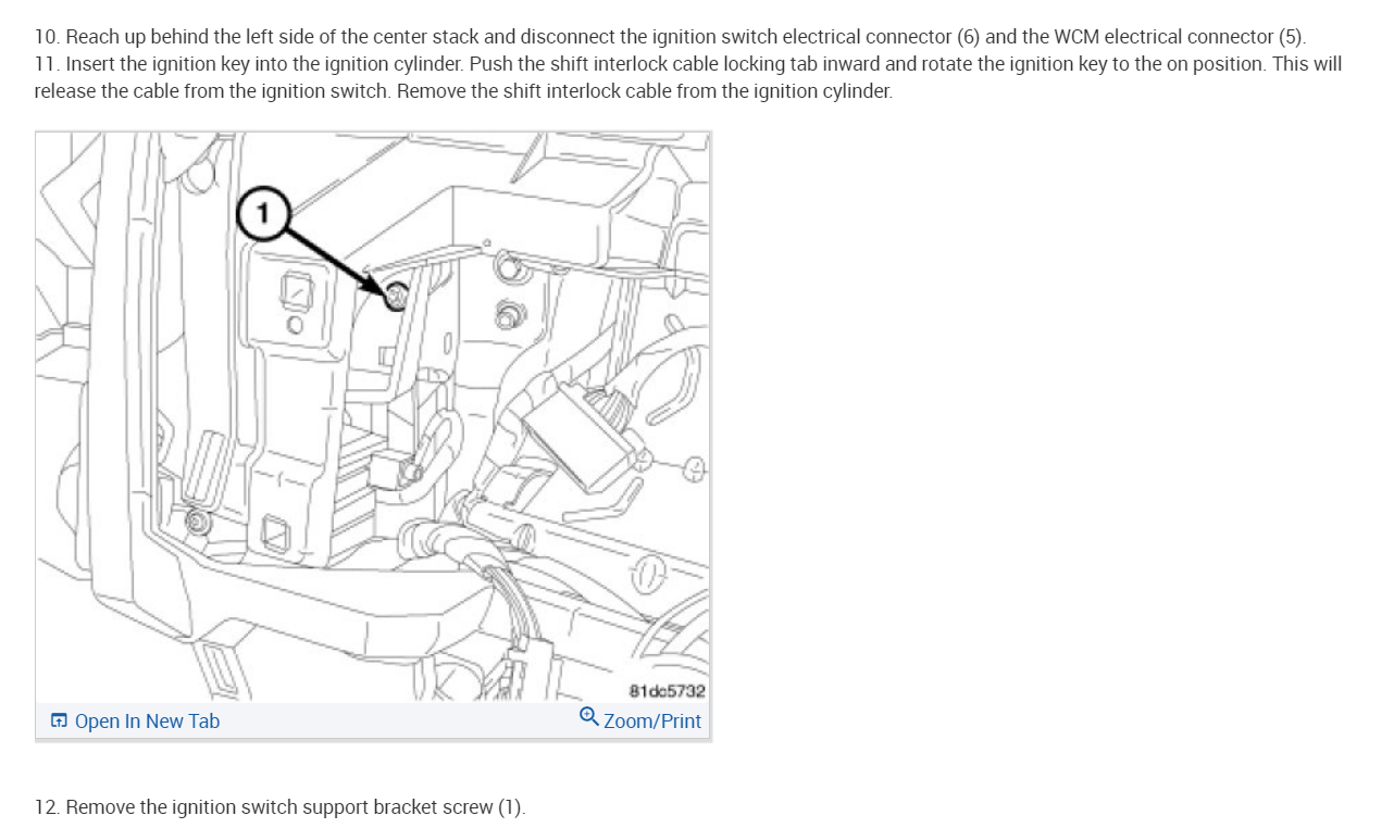

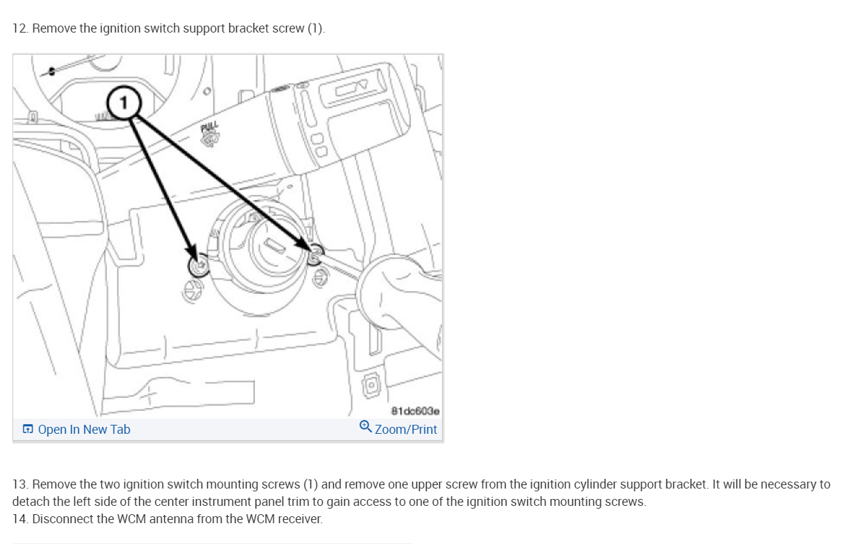

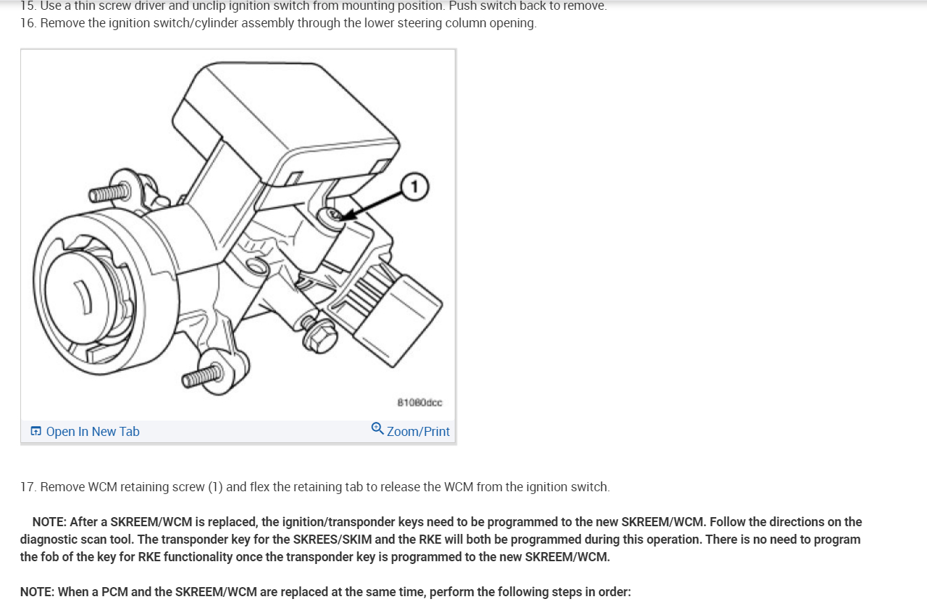

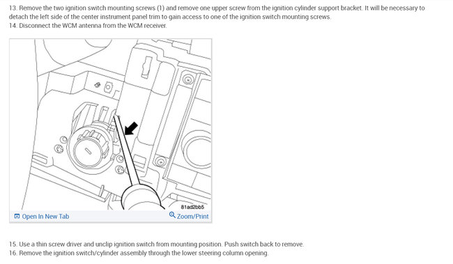

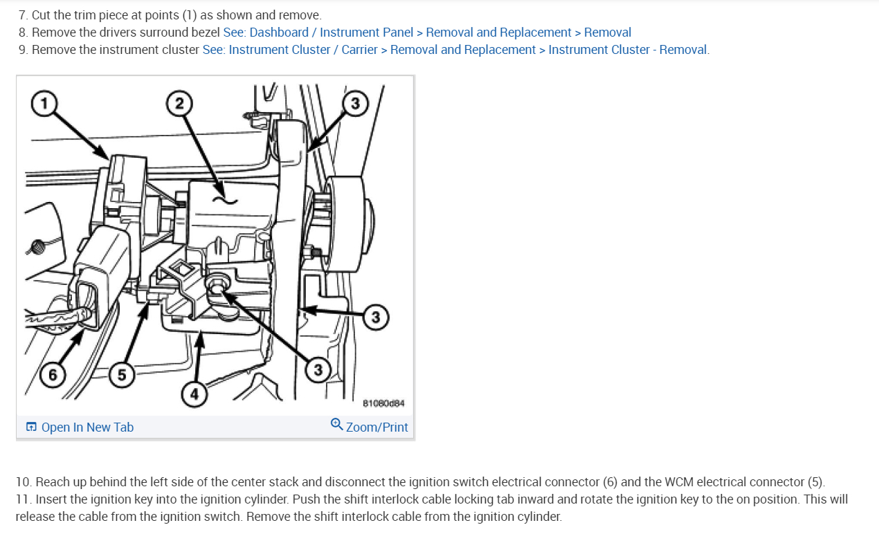

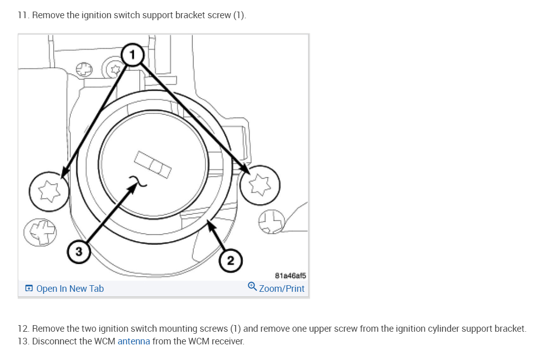

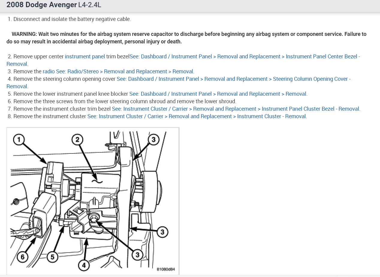

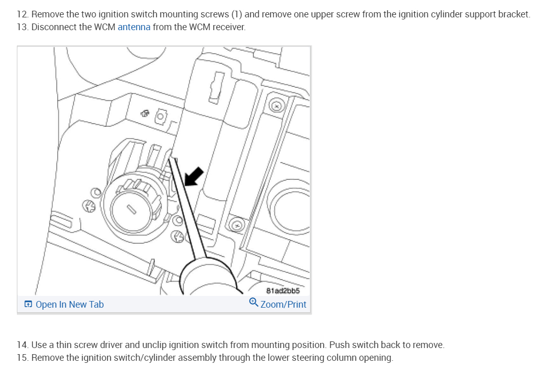

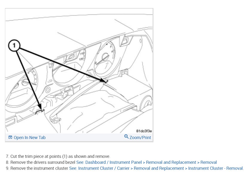

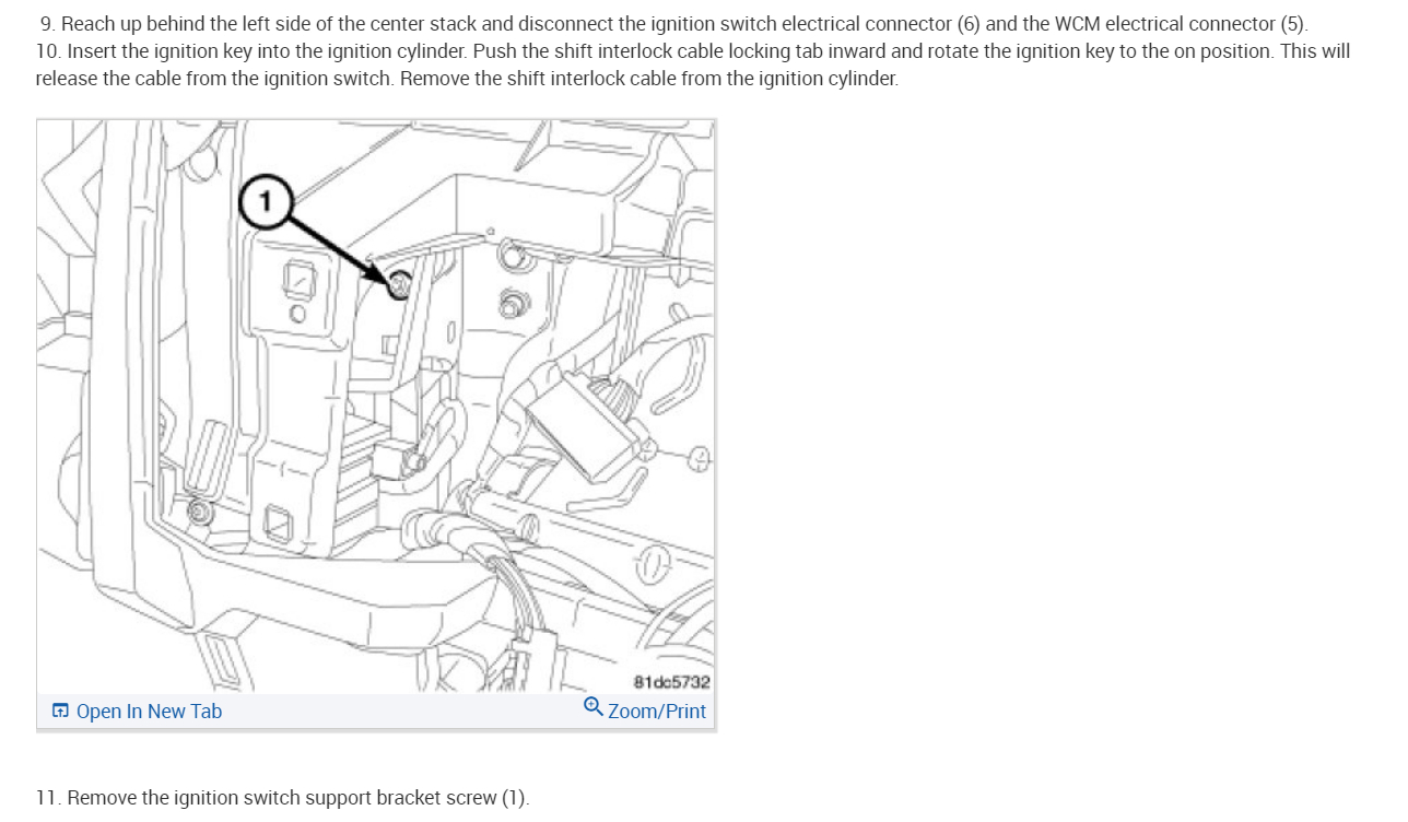

Yes, it will need to be programmed here is how the anti-theft module or immobilizer is replaced in the instructions below. Also check the diagrams, in the images below as well.
SKIS INITIALIZATION
The Sentry Key Immobilizer System (SKIS) must be initialized following a Sentry Key Remote Entry Module (SKREEM), sometimes referred to as the Wireless Control Module (WCM), replacement. SKIS initialization requires the use of a diagnostic scan tool. Initialization will also require that you have access to the unique four-digit PIN code that was assigned to the original SKREEM/WCM. The PIN code MUST be used to enter the Secured Access Mode in the SKREEM/WCM. This PIN number may be obtained from the vehicle owner, from the original vehicle invoice, or from the DaimlerChrysler Customer Center See: Alarm Module, (Vehicle Antitheft) > Programming and Relearning > Programming the Sentry Key Remote Entry Module (SKREEM).
NOTE: If a Powertrain Control Module (PCM) is replaced on a vehicle equipped with the Sentry Key Immobilizer System (SKIS), the unique Secret Key data must be transferred from the Sentry Key Remote Entry Module (SKREEM) to the new PCM using the appropriate programming procedure. This procedure also requires the use of a diagnostic scan tool and the unique four-digit PIN code to enter the Secured Access Mode in the SKREEM/WCM.
