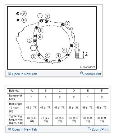

I need the torque specs for the torque converter bolts
30,000 MILES • 2.5L • 4 CYL • FWD • AUTOMATIC
2FASTALTIMA
I need the torque specs for the torque converter bolts an engine to trans bolt torque specs. This is my first time ever doing a motor swap so I wanna be perfect.
Apr 6, 2016 at 12:48 AM
HMAC300
  • 48,601 POSTS
The torque converter nuts go to 38 ft lbs
See the diagram below for sequence and torque spec of the bell housing bolts
