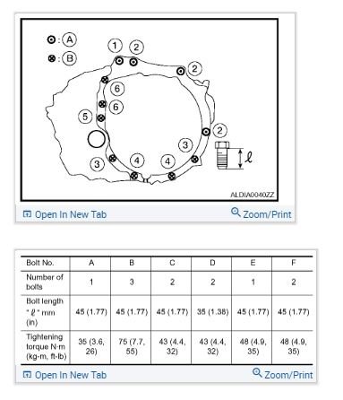

I need the torque specs for the torque converter bolts
2007 NISSAN ALTIMA
30,000 MILES • 2.5L • 4 CYL • FWD • AUTOMATIC
2FASTALTIMA
I need the torque specs for the torque converter bolts an engine to trans bolt torque specs. This is my first time ever doing a motor swap so I wanna be perfect.

The torque converter nuts go to 38 ft lbs
See the diagram below for sequence and torque spec of the bell housing bolts

Thanks I got it snugg all the way around. You wouldn't know were I can find an engine harness diagram I didn't think to tag it cause so much at once for me.
