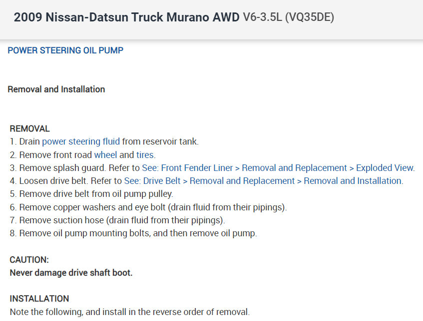

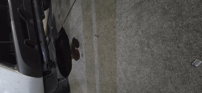

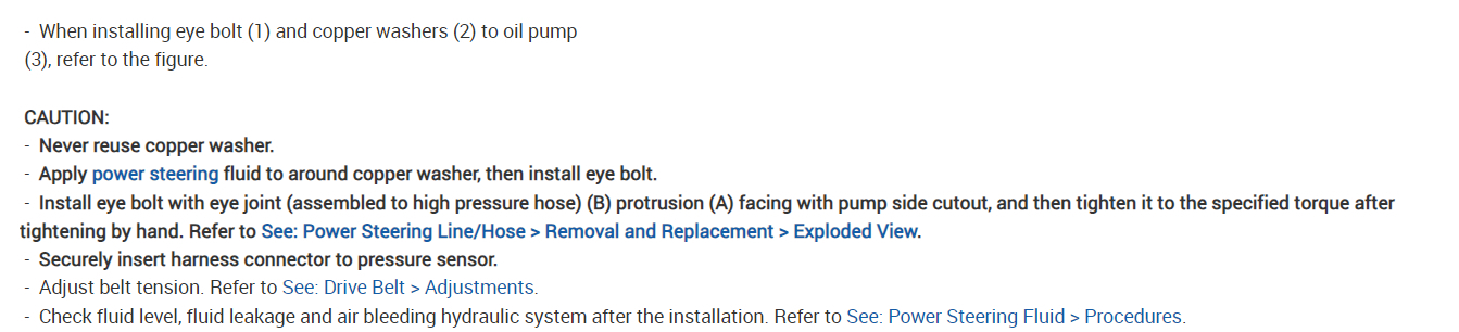

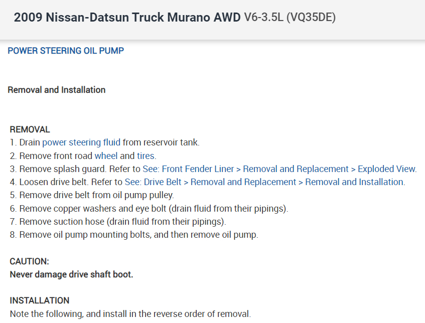

Have a power steering pump failure need some help on a diagram to change it.
Sep 7, 2024 at 9:08 PM
  • 55,402 POSTS

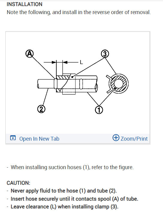

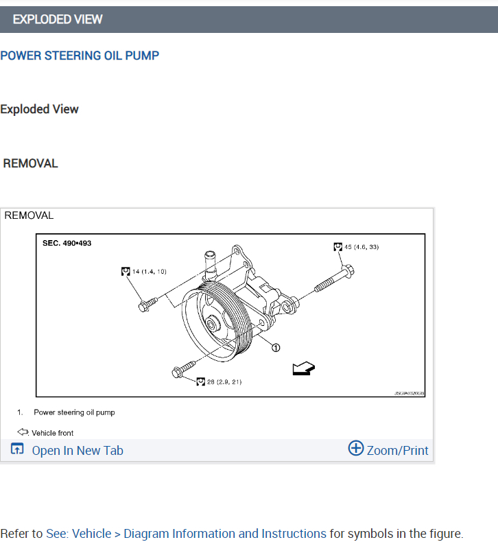

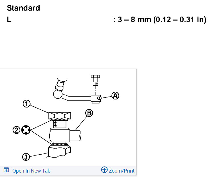

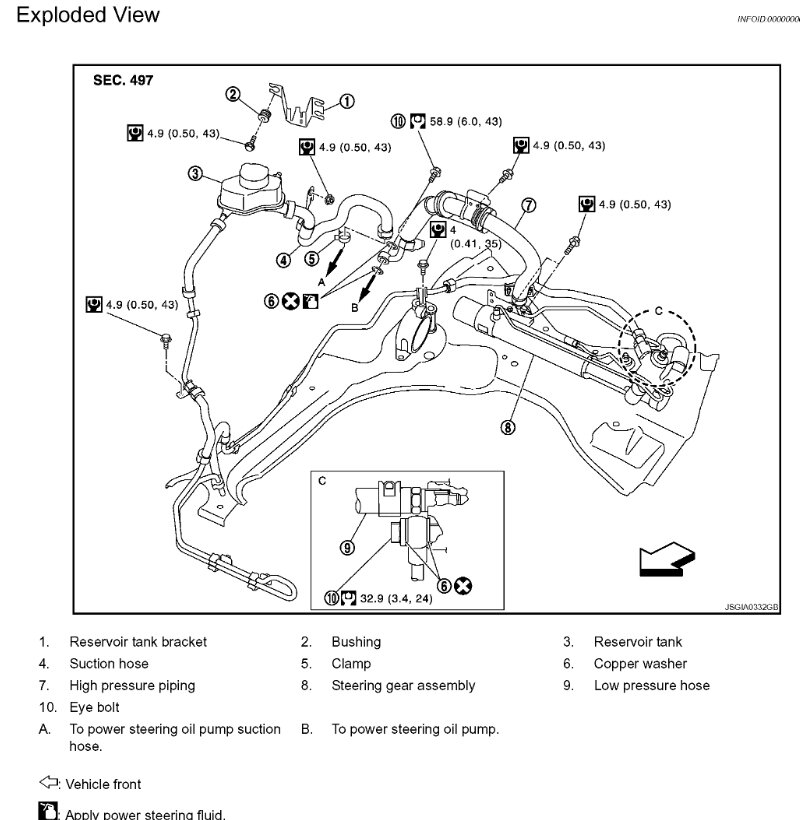

Yep, that pump looks like it needs a change, here are the instructions on how to change the steering pump out with tips on the banjo fitting sealing washers. Check out the images (below). Let us know if you need anything else.
