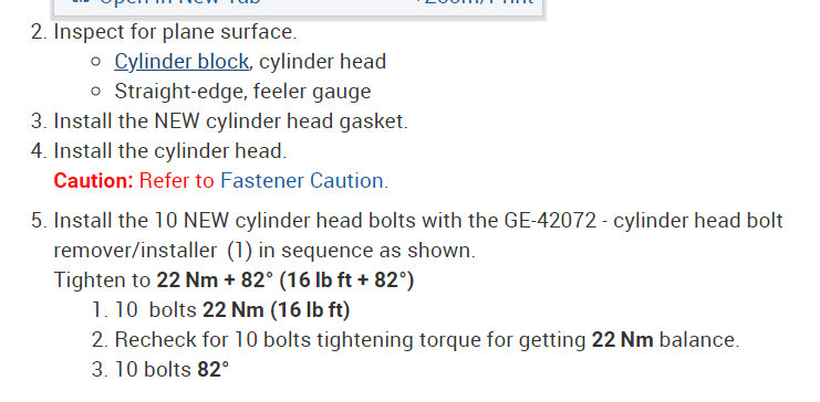

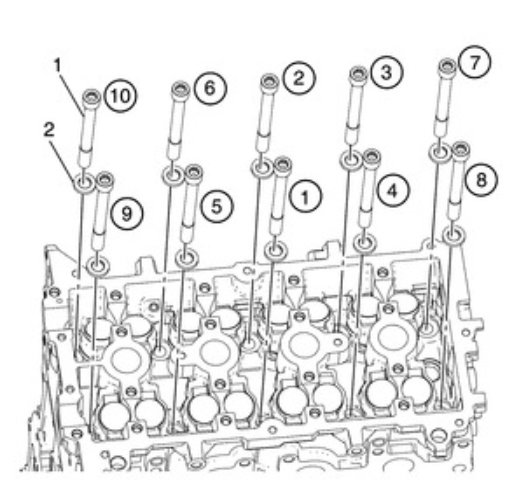

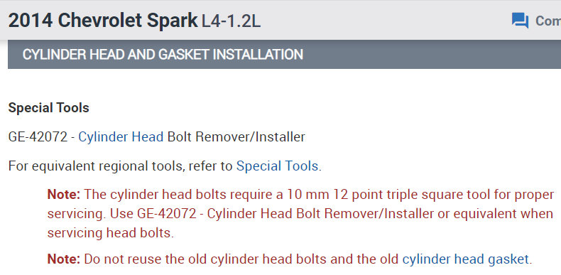

Need head torque specs for head gasket installation
2014 CHEVROLET SPARK
200,000 MILES • 1.2L • 4 CYL • 2WD • AUTOMATIC
BUCKSHORT420
New head gasket.
Dec 21, 2020 at 1:31 AM
DANNY L
  • 5,648 POSTS
Hello, I'm Danny.
Here is the information you requested. I've attached below the cylinder head bolt torque specification and the tightening sequence. Hope this helps and thanks for using 2CarPros.
