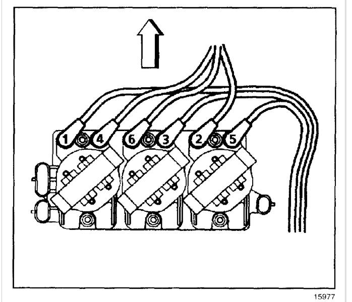

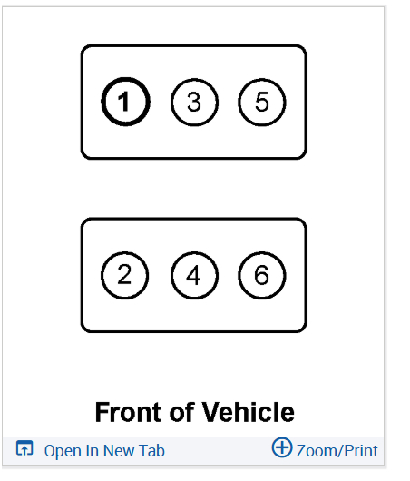

Need Firing order diagram or picture?
2004 OLDSMOBILE ALERO
200,000 MILES • 3.4L • AUTOMATIC
RICHARD BERMEA
Change coil packs plug wires and plugs my coil packs are not numbered correctly the way they're sitting on the ignition control module but from the passenger side going towards the driver side I need to see which coil packs I mean which number they are I would say the first coil pack on the passenger side would be one and four the middle coil pack would be two and five in the last coil pack would be 3 and 6 is that correct?
Jul 5, 2026 at 12:09 PM
  • 55,423 POSTS
Yes the 1, 3 and 5 are at the firing wall side of the engine (right)
Firing Order .................... 1-2-3-4-5-6
Check out the images (below). Let me know if you need anything else. Have a nice sunday!
