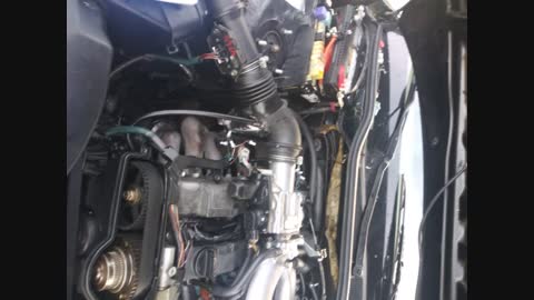

One of the wires pulled out of the electrical connection as a for that plug the throttle body actuator on to the throttle body assembly itself. there are four wires in each and I have thought about just twisting them together but one side of the wires is way sicker than the other. would that be okay to go ahead and do need color coded wiring diagram? please ASAP.

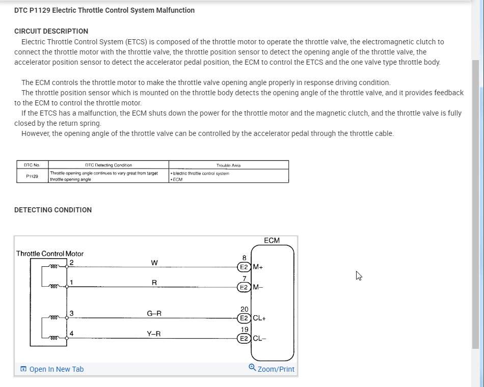

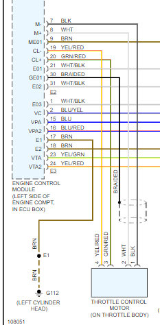

Here is a picture of the wiring diagram for the throttle body. Let me know if you need more detail but if you have a wire that pulled out of the connector you can just use a connector kit and solder the wires back together. If I understand the issue correctly then the better route is to get a new connector with the wiring on it and then just solder it onto the existing wiring. Let me know if I am misunderstanding the issue or if you have questions. Thanks
Apr 20, 2020 at 4:03 PM
DANNY L
  • 5,648 POSTS
Hello, I'm Danny.

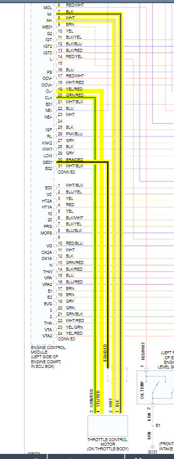

Here is a color wiring diagram you requested. The 4 wires originate from the ECM (engine control module) I've attached the picture below.Hope this helps and thanks for using 2CarPros.
Apr 20, 2020 at 4:04 PM

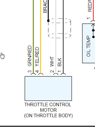

CHRISTA DICKSON
  • 148 POSTS

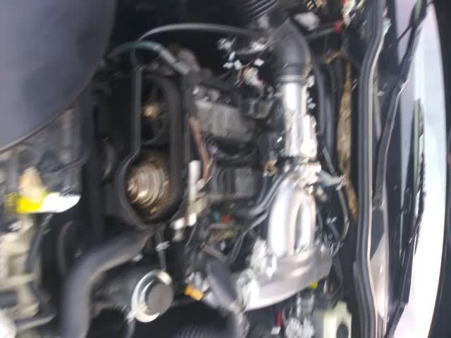

Thanks for your reply, but i am unclear on the braided wire i have ran into it while having to fix this and the crank plug by alternator harnesses and not really sure what to do with the wire ? Should i cut it off , ground it to something or where does it go?
Apr 25, 2020 at 1:28 PM

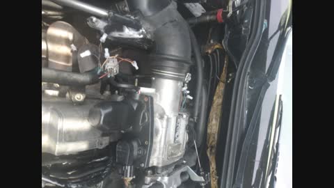

Can you get pictures of what you are dealing with? If you have a connector issue at the throttle body then that is all we need to fix. As for the twisted pair wiring, we just need to connect the new wiring from a connector kit. Just get us pictures of the wiring and connectors that you are trying to repair and we can get you the info that you need to repair it. Thanks
Apr 26, 2020 at 6:01 PM

I also have a piece of the thicker wired side coming from the motor itself cut off from pick n pull that is not broken. if you think it would be better to spice and reconnect the harness that way, but would this be causing no start and how can i fix it? please keep in mind no ride if possible.
Apr 27, 2020 at 12:16 PM

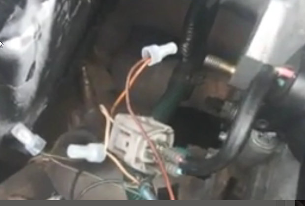

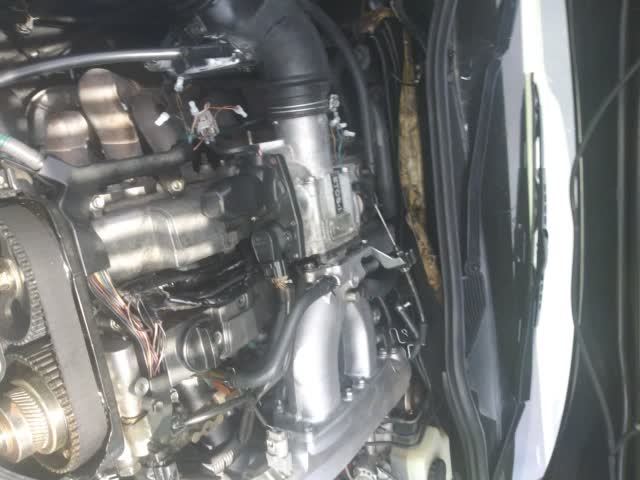

Okay. That video helped but it actually was cut off at the bottom so we couldn't actually see the wiring when you were showing it. So can you get pictures of the two areas that you made those wiring repairs? It seems like you have tried to bypass these sensors? Is that true? Is the connector that is shown below the throttle motor connector?
If you are trying to bypass these components that is the reason for the no start. You can't bypass them. If the ECM doesn't get a signal from these sensors then it will cause what you are dealing with.
The codes you gave me were circuits codes for these circuits and are the cause of your no start. We need to put the wiring back to factory so that we can repair the vehicle for what the issue was before you tried to bypass these things.
Let me know if that is what is happening here and if not, can you get pictures and then show me why you are twisting wires together. Thanks
Apr 28, 2020 at 2:19 PM

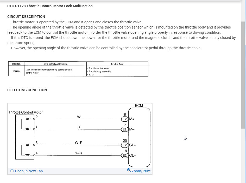

No didn't try to bypass anything just fuse connector. still wont start. code 1128, 1129 and 1130 and pretty sure i have wiring right would appreciate verification.
Apr 29, 2020 at 5:57 AM

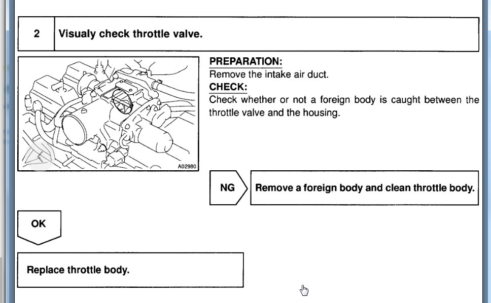

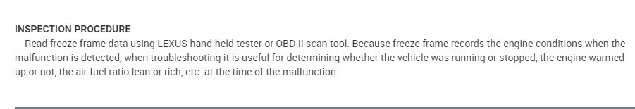

Okay. So if you are just jumping past a connector then that is okay. However, those connectors are not going to hold up. They are okay for now but each of those connections will need to be soldered and heat shrink wrapped.

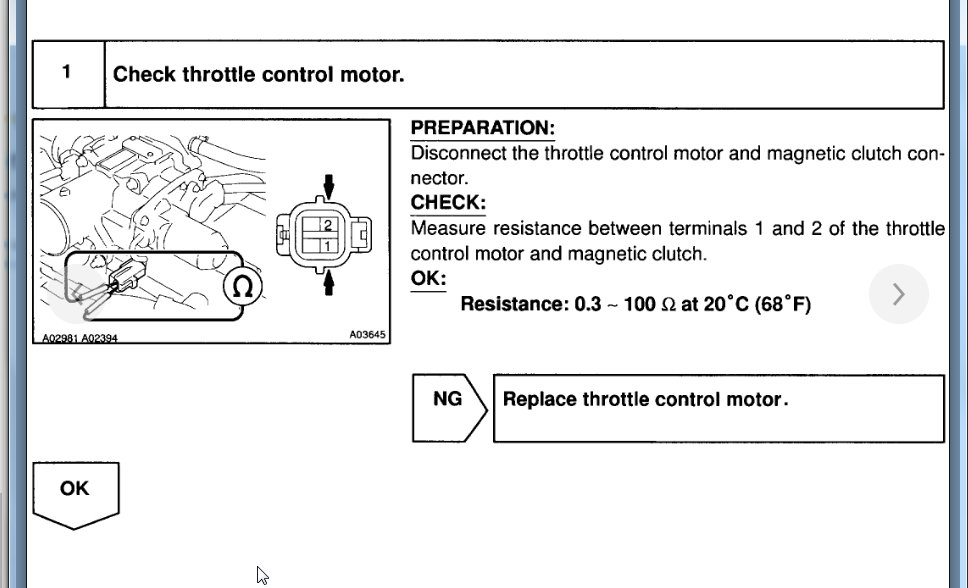

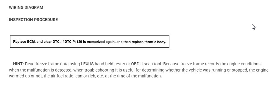

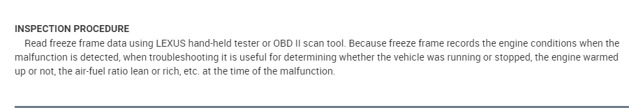

I attached the testing for these codes. We need to run through this and see what we come up with. I agree that I suspect a wiring issue but the codes are telling us where to start so let me know if you have questions or the results and we can go from there. Thanks

It's reading 1.8 steady resistance and i'm pretty sure there's nothing in it because i have already switched it out, but will check again. what should i do next? It's starting then sputtering out like with a second or two every time.
Apr 30, 2020 at 6:04 AM
Okay. Based on these results then the ECM is the issue. However, I would suggest ohm out the wiring from the ECM to the throttle motor. This means unhook each connector and test resistance from end to end. You should have around a half ohm or less on each wire. If you have good continuity and proper resistance then I suspect the ECM is the issue due to these codes.
