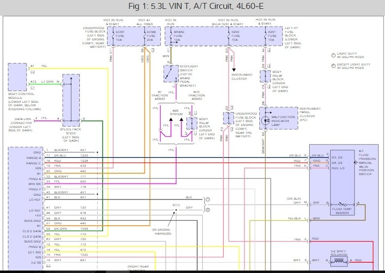

My SUV is a 4x4 with a 5.3L. I am having a hard time getting a wiring diagram for the transmission. The transmission is a 4L60E. Can someone help me?

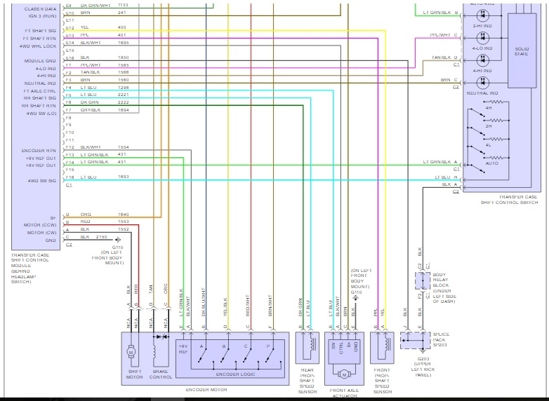

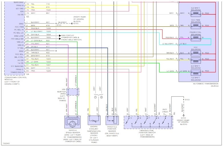

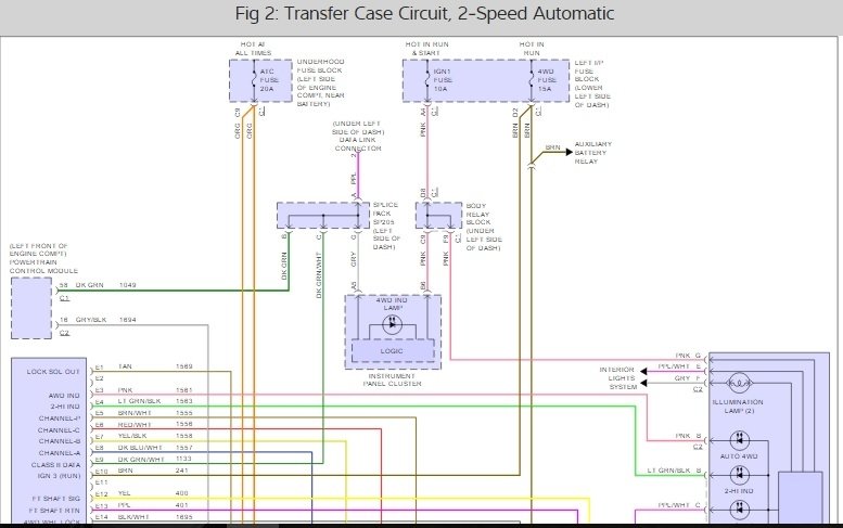

This is what "Prodemand" has,
I made four screenshots using my 2CarPros access, as they do not make the diagrams downloadable.
The first two are one diagram, the last two are the second diagram.
I made sure I had Overlapping on the screenshots.
Diagram one sits atop diagram two.
Diagram three sits atop diagram four.
