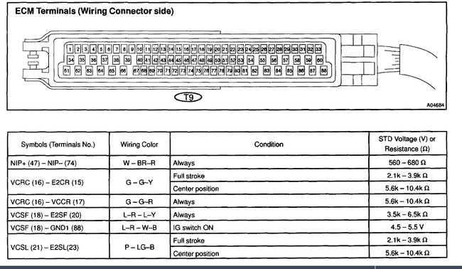

I need ECM pin layout for 1G-FE A/T ECU. I mean numbers of pins and their symbols which are connected to them.
Sep 5, 2022 at 1:03 AM
  • 55,694 POSTS
Sure, here is the ECM pinout values you have requested. Check out the diagrams (below). Please let us know if you need anything else to get the problem fixed.

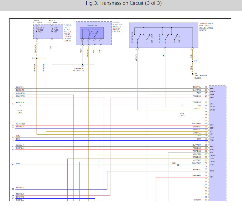

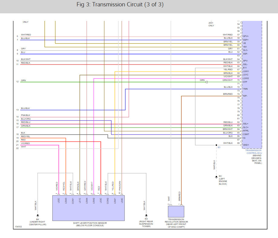

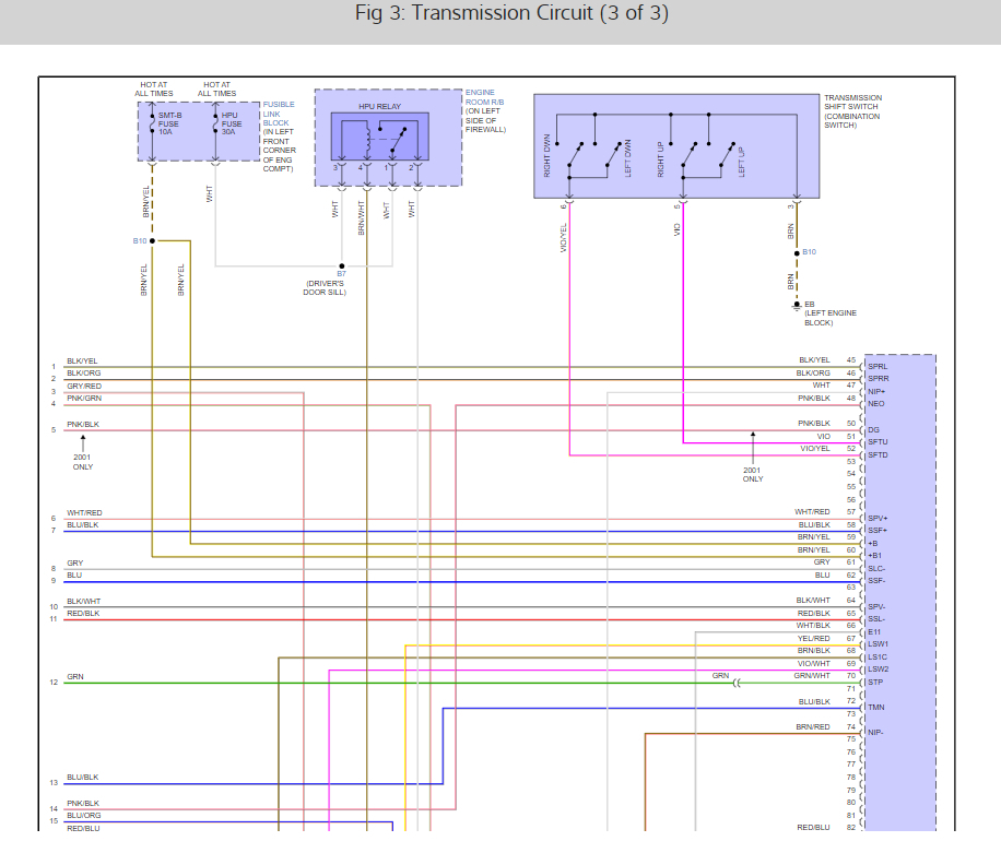

So, which terminal the speed sensor and revolution sensor will be connected on this ECM?
Sep 12, 2022 at 5:46 PM
  • 55,694 POSTS
The speed sensor is fed into the TCM. here are the wiring diagrams so you can see what I am talking about.
