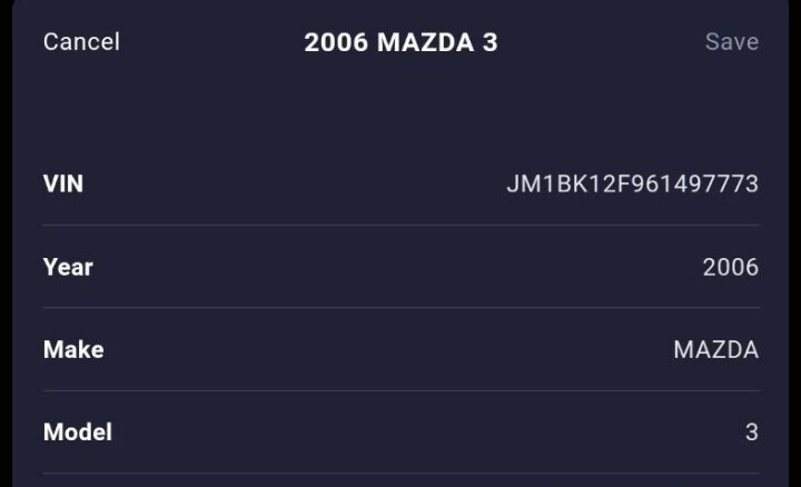

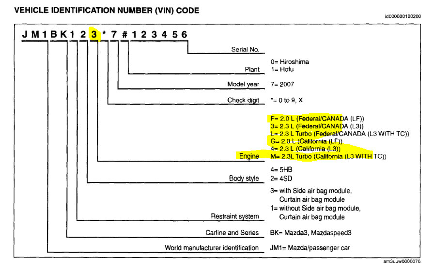

That's the thing. When it comes to the engine size, the door tag says its a 2.3L but everything else says it's a 2.0. How do I know for sure?
Jun 2, 2023 at 4:58 AM
  • 110,244 POSTS
There should be a label under the hood indicating the engine size. Also, does it say anything on the valve cover itself?
If possible, let me know what the 8th digit of your VIN is. That identifies the engine that the vehicle came with. Unless it was replaced, it should be correct.
I attached the VIN breakdown. Take a look.
See pic below.
Jun 2, 2023 at 12:49 PM
ANDIWARD76
  • 10 POSTS

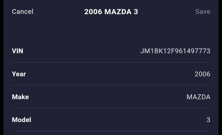

Here is the info I have at the moment. Hopefully this will give you some clarity?
Jun 2, 2023 at 1:17 PM
  • 110,244 POSTS

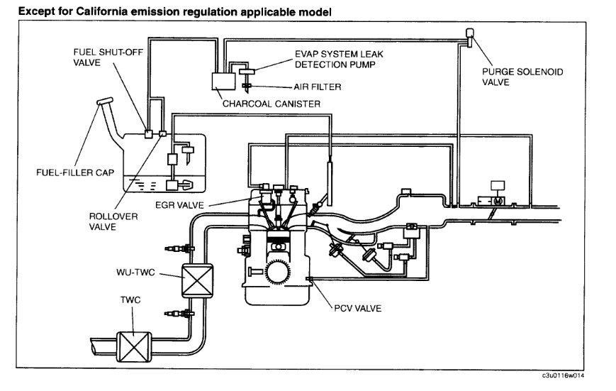

According to the VIN (engine code F), you have a 2.0L with federal/Canada emissions. Does that sound correct?
As far as the tag on the door, was the vehicle ever in an accident, and had that door replaced with a used one? That's the only thing I can think of.
I attached the vacuum schematics for your vehicle below. Let me know if that helps. Also, I need a circuit for the wiring needed.
See pic below.

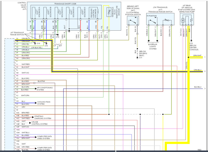

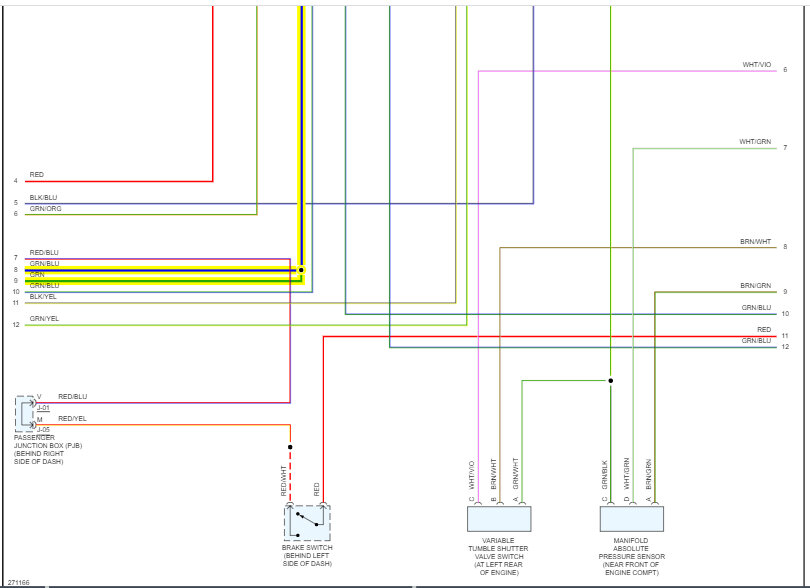

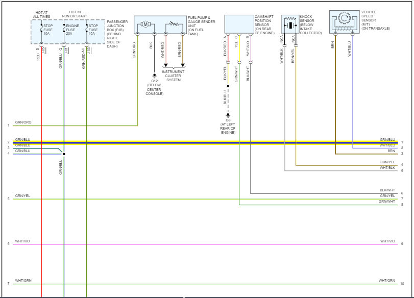

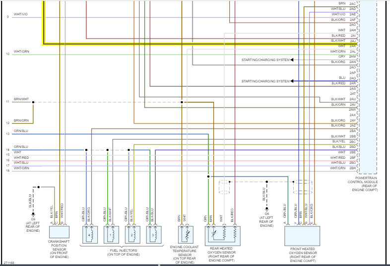

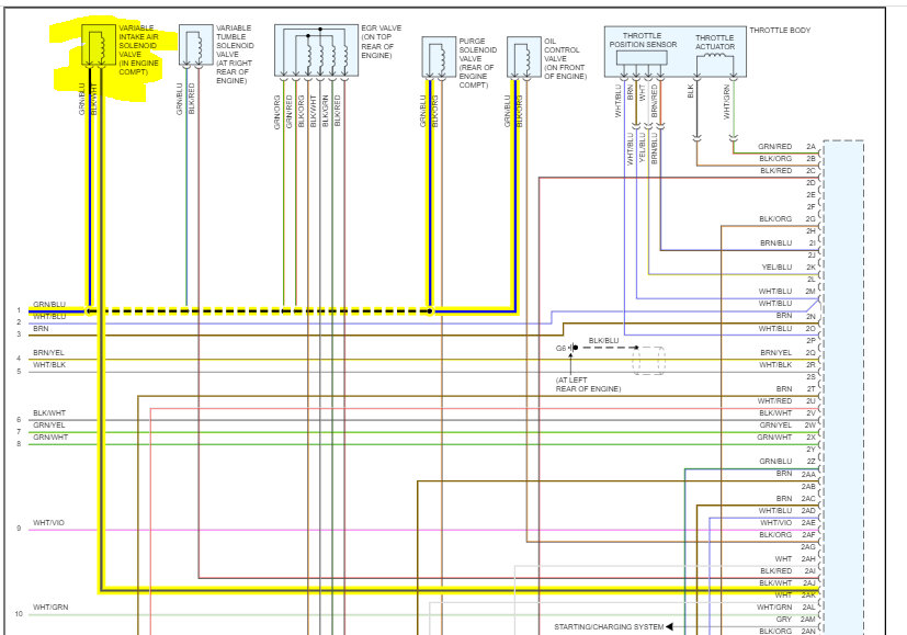

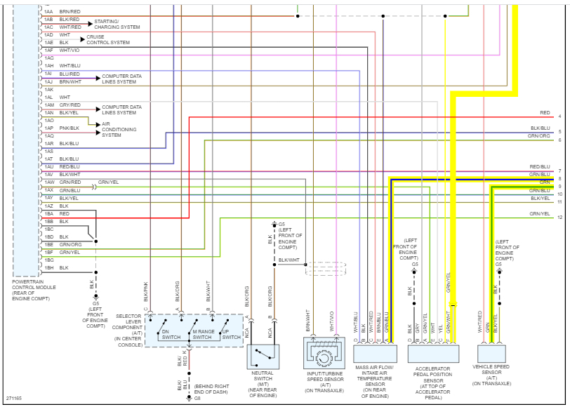

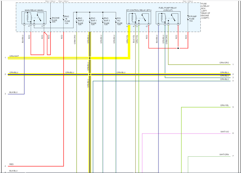

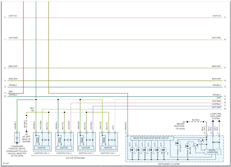

Can you get me the intake Manifold runner solenoid line diagram?
Jun 4, 2023 at 7:20 AM
  • 110,244 POSTS
I attached the entire powertrain management system schematics below. I highlighted the wiring related to the runner.
Let me know if this helps.
See pics below. Note: The schematic was 4 pages long. I had to cut each pic in half to make them readable.
