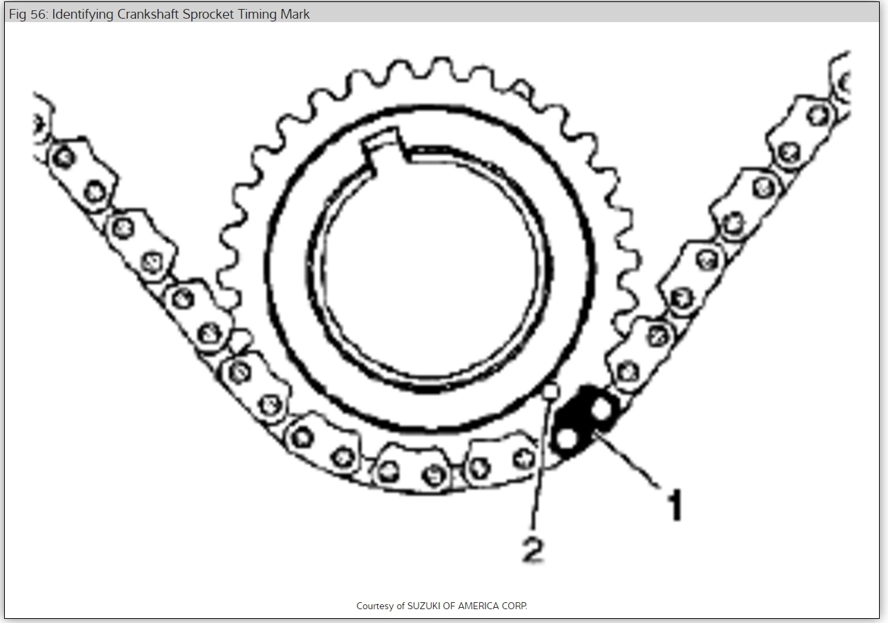

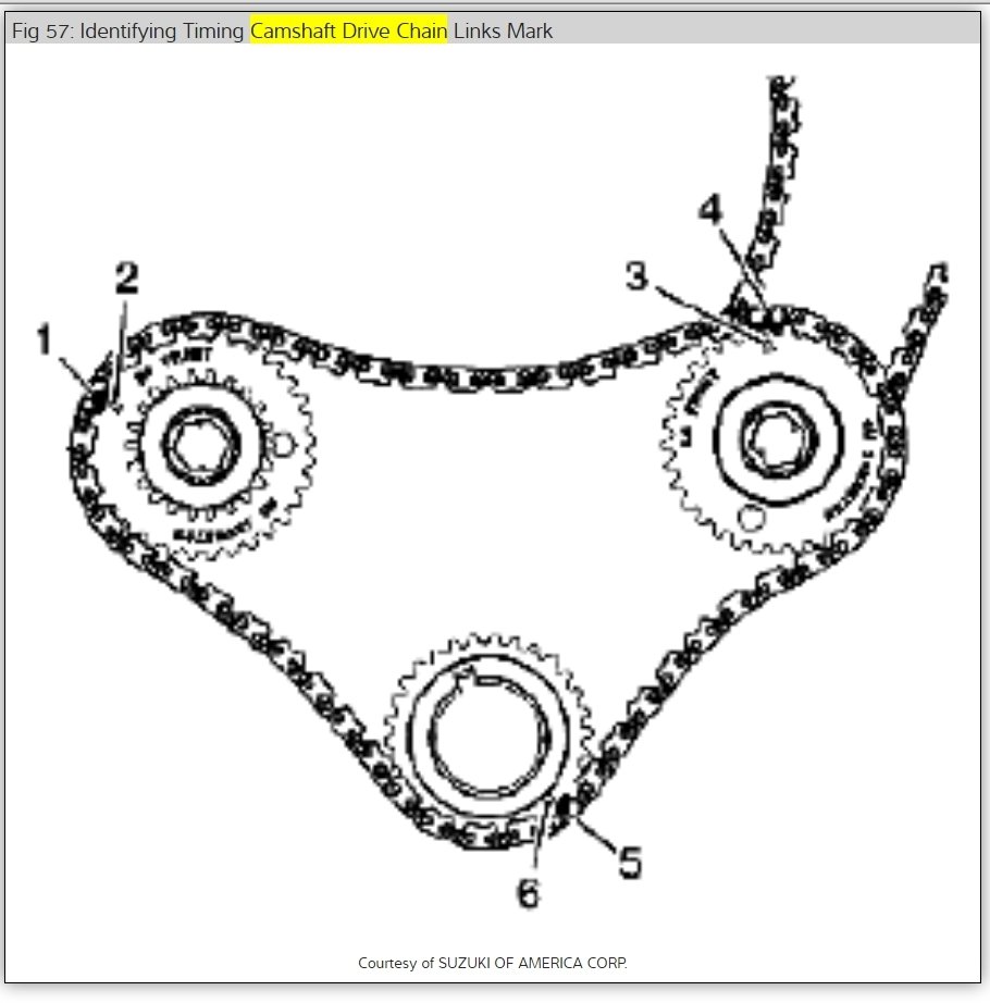

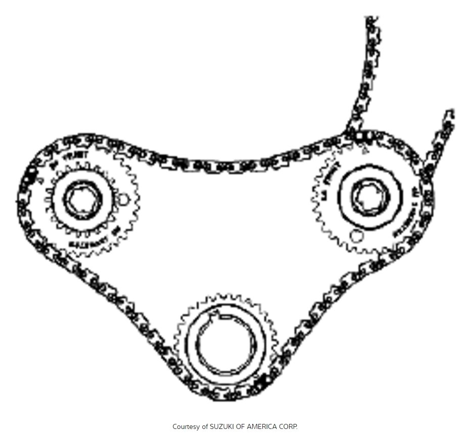

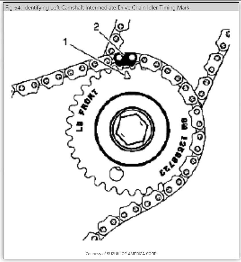

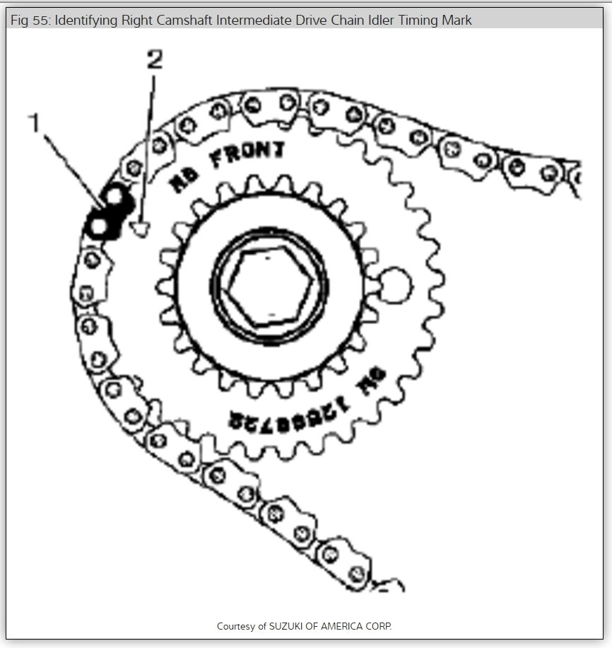

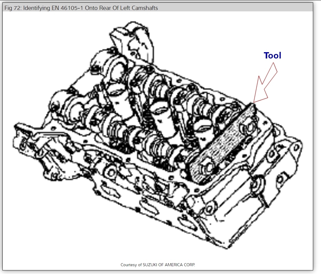

Instructions on timing chain on the car listed above.
Aug 10, 2016 at 8:50 AM
Experienced Mechanic
55,851 POSTS
Hey Bear,
This is a big job, must be fun ! Here are the diagrams you need to make it happen, let us know if you need anything else, we are here to help
Best, Ken
