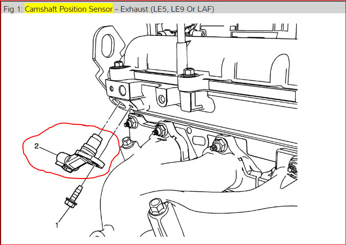

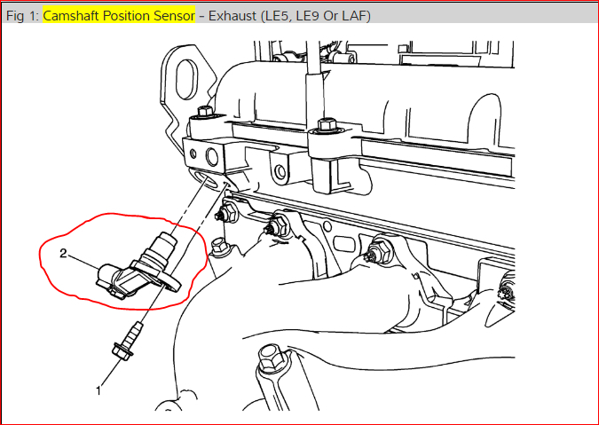

I need a diagram for the camshaft position sensor locations.

I have attached a picture for you and circled the sensor in red. Hope this helps and feel free to ask any other questions if needed. Thanks for using 2CarPros.

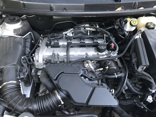

Is that the only one? I ask cause auto parts store sold my girlfriend's mom two of them. Attached is vehicle tag behind driver door and picture of engine compartment.

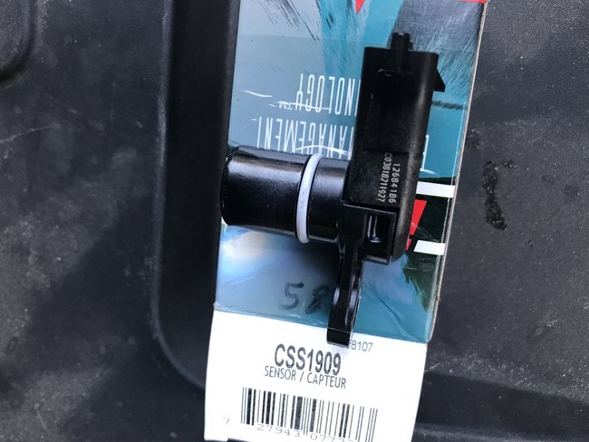

And these are what they sold her. Two of them.

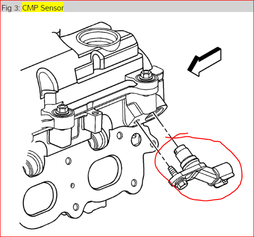

This picture is the intake side. The first picture was the exhaust side. I found the Intake picture just now. Thanks again for using 2CarPros.
