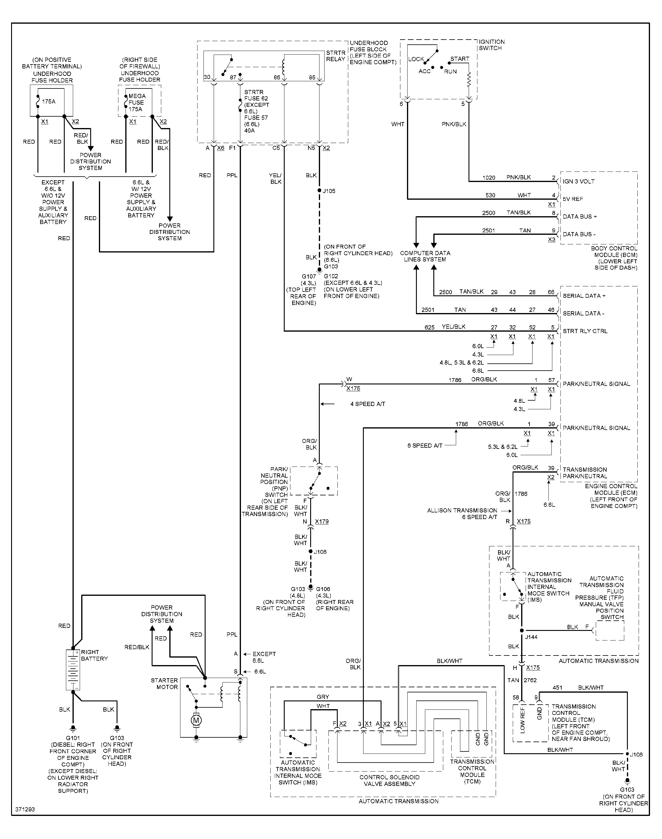

need color code of ignion switch for aftermarket start button
2012 CHEVROLET SILVERADO
4,000 MILES
RMLEWIS
I need to know what two wires I tap into to finish the installation of an aftermarket complete kit that i purchased. Unfortunatly the kit does not tell you the color of the wires coming off the ignition keyswitch to use. The kit was easy to install but without knowing what color of wires to tap into its useless. Any help would be appreciated.

OK---NO TRUCK NOMENCLATURE OR ENGINE SIZE
IN ORDER TO GET YOU INFO FAST....I DID NOT REQUEST THOSE....I WINGED IT, HAD TO GUESS!
LEMME KNOW IF THIS WAS A GOOD GUESS
"SILVERADO 1500"
THERE ARE LIKE 260 DIAGRAMS FOR THAT TRUCK ALONE----WITHOUT AN ENGINE SIZE, I WAS FORCED TO GET 'EM ALL
---------PICK OUT THE CORRECT ONE FOR YOU!!!-----
IF I WAS WRONG WITH MY SEARCH CRITERA----CORRECT ME---I'LL TRY AGAIN (WE ARE PEOPLE, NOT ROBOTS......I'M MORE AT HOME ANSWERING OLD JEEPS AND OLD FORDS, CARBURETED KIND!)
I CAN GET DIAGRAMS FOR YOU FROM "MITCHELL I", THOUGH I KNOW LITTLE ABOUT YOUR RIG
SILVERADO 1500 .....EACH ONE WAS LABELED "STARTING CIRCUIT"

RMLEWIS
Sorry about not giving you all the info you needed CJ MRDEVAC-I did not realize that there were so many diagrams for the same model. Basically I am jus looking for the color code of the wires at the ignition swith so that I can tap into the two I need. Thanks anyway for the help and again my apologies. By the way your title suggests you might be a vet, if you are welcome home and thank you for your service.

..........AND THE WIRE COLORS ARE LISTED BESIDE EACH WIRE IN THE DIAGRAM!!!!!
JUST PICKIN' AT YOU....THE DIAGRAMS WERE WITHIN 2 OR 3 DIAGRAMS OF EACH OTHER
