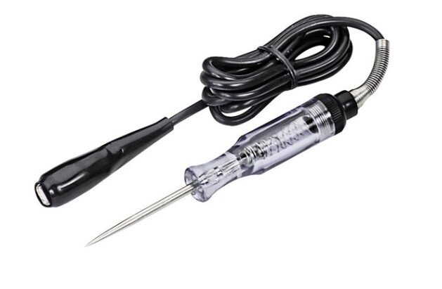

OK, as it started with the snapshot, I would remove that, then disconnect the battery for a few minutes. Reconnect it and go for a drive. Many of the items you describe sound like the system is losing the keep alive power that hold the adaptive things like shifting, clock memory and more. That can cause the shifting and light issues. Disconnecting may reset the system so it can relearn them and then store them. To go with that it would be a good idea to check the fuses, it's possible that one of the memory fuses blew and it is causing this. The fastest way to do that is to get a cheap test light, and run the fuses with it.
Be sure the key is on. Check the fuses in the under hood block as well as the instrument panel block (right side between the door and IP)

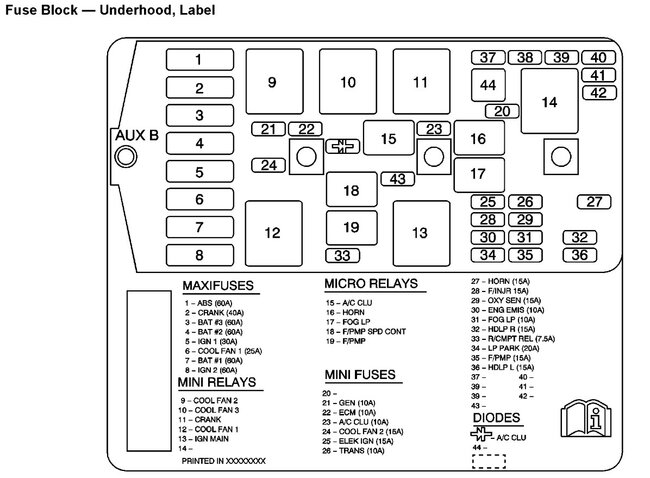

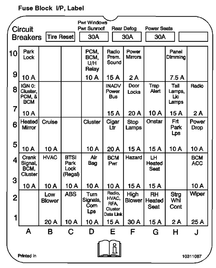

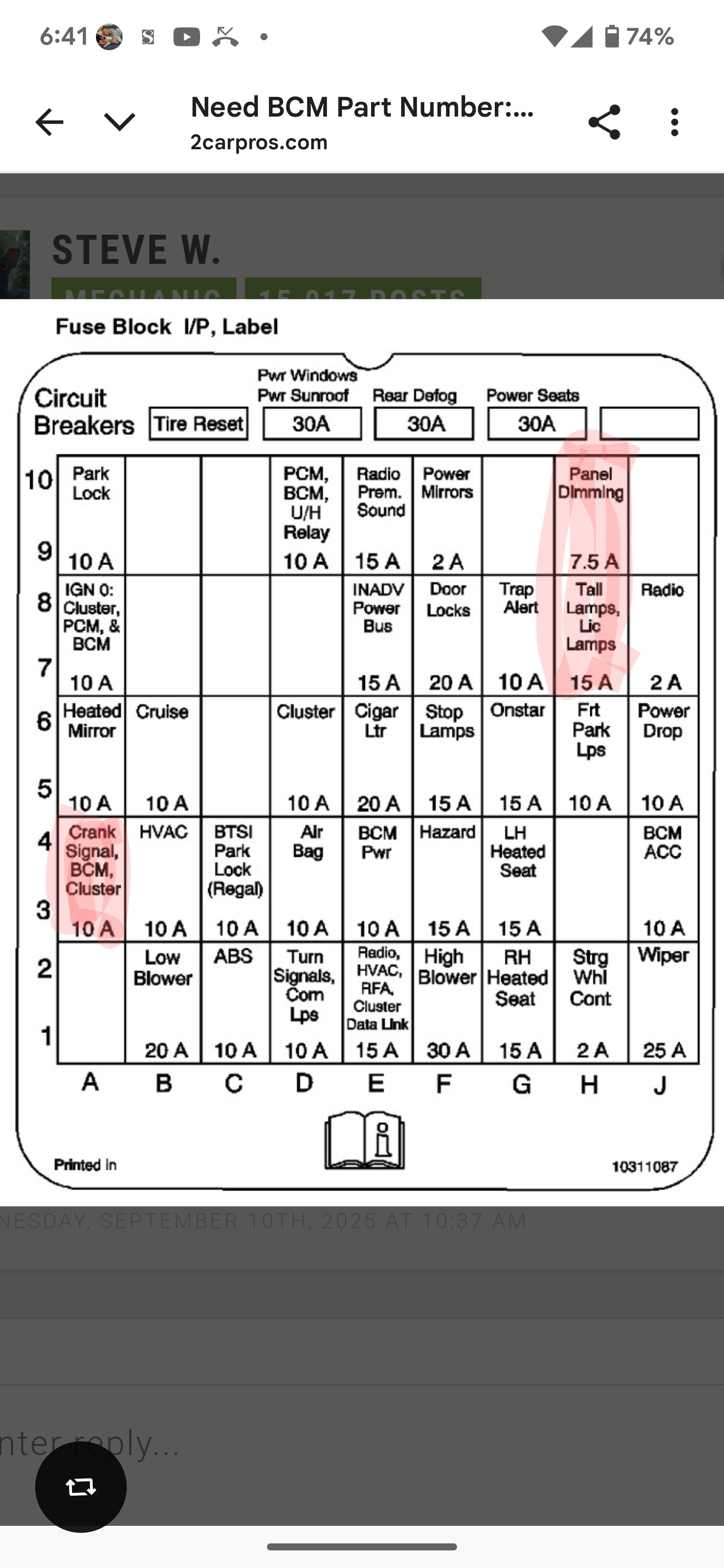

So I took that snapshot out and that seems to have fixed most of the issues. Now the only problem is on of the fuses inside the cab keeps popping everytime I try to replace it. And there are 2 other fuses that are getting no power to them at all.... Any advice on what that could be ?
Sep 10, 2025 at 2:54 AM
STEVE W.
  • 15,352 POSTS
Can you tell the fuse numbers from these images? That might give us a clue.
Sep 10, 2025 at 3:37 AM
AMBERTURNER2025
  • 5 POSTS
I marked the ones that aren't working in red. The 15 amp keeps popping everytime we try to put a new one in. The 7.5 amp one there's no power, and the 10 amp only reads power on half of it.
Sep 11, 2025 at 9:46 AM
STEVE W.
  • 15,352 POSTS
OK, the 10 amp is bad then. Remove it and check the connections in the box, They can corrode off or they get hot and open up. That one alone will keep it from running.
The 15 amp is the tail lights, that can be a short in the rear harness so it blows instantly. It also feeds the 7.5 amp circuit. Let's see about the 10 amp first and maybe get it running. Then if you don't mind log in and ask a new question about the lights. We try to keep topics in separate sections to make searching easier. So someone looking for taillights wouldn't look at BCM part numbers. https://www.2carpros.com/questions/new Post the same image and info about those 2 fuses. Thank you.
