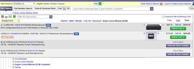

Good evening,
The labor is one hour. That is about $100.00.
The programming is $125.00
The part is $175.00. .....................................................

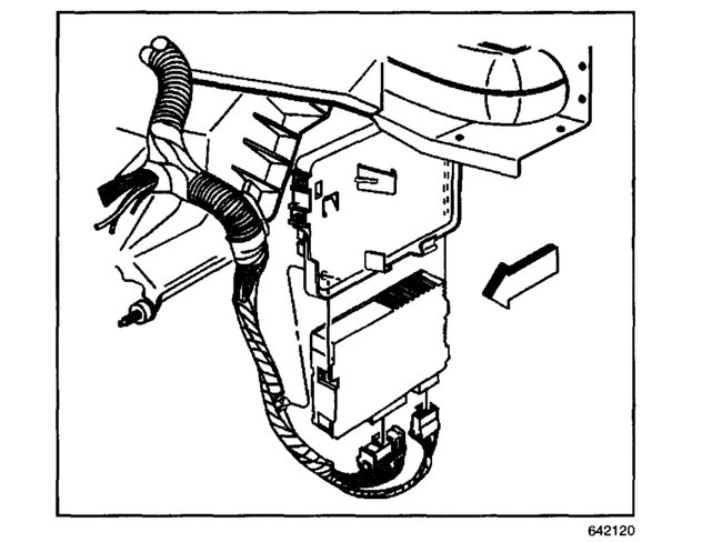

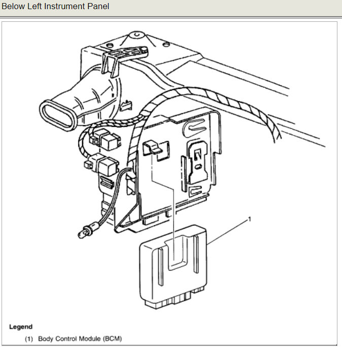

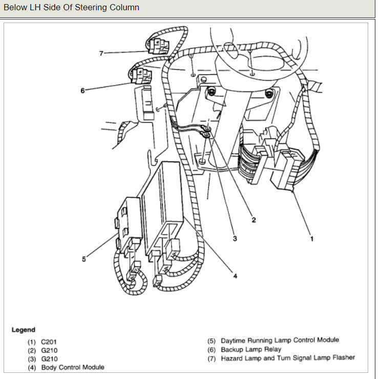

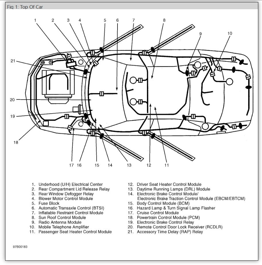

Where is the body control module located?
Nov 27, 2020 at 7:56 AM (Merged)
  • 55,423 POSTS
It looks like the BCM Body Control Module is located behind left side of dash, left of steering column. See the image below: #15. I would try a used one.
Please let me know if you need anything else to get the problem fixed. look at the diagrams *BELOW)
Best, Ken
