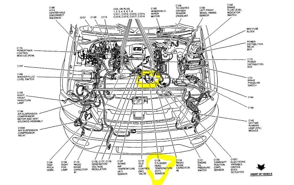

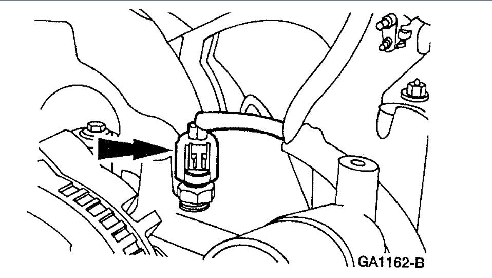

There is a sensor for the engine temperature on the front of the driver's side head.
I attached a picture for you to view. This is the most common reason for the gauge not working.

Okay, but when I plug my scanner in to the OBD2 diagnostic connector it reads the engine temperature. That's why I thought the cht sensor was okay and it had to be the ECT on the intake it has both?
May 30, 2019 at 5:09 AM
If it is reading engine temperature on the scan tool, then you either have wiring issue from the ECM to the dash or the cluster is bad.

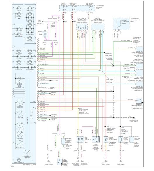

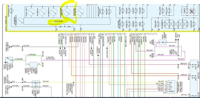

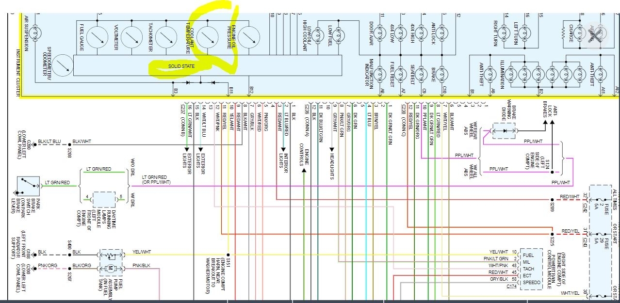

I know I need to test wiring from PCM to gauge cluster, but have no information on test procedure and no information for pin location for connector at PCM and gauge cluster.
May 31, 2019 at 8:50 AM
Okay, I attached a diagram for you to view.
This is not something you can test with a voltmeter. The only thing you can do is to check the connector at the back of the cluster. The controls for the gauge are in the solid state unit in the cluster.

Can you please send me a clear copy or a link that I can see or download? thanks, Jeff
May 31, 2019 at 7:26 PM
You can try this link:
https://www.2carpros.com/images/question_images/271687/original.jpg
Jun 1, 2019 at 4:55 AM
JEFF HILL
  • 21 POSTS
You have helped me, but I need a complete image of cluster wiring.
Jun 1, 2019 at 8:13 AM
That is the only image of the cluster. As I stated before, there is nothing you can check internally as it is controlled by a microprocessor in the cluster itself.
Jun 1, 2019 at 8:16 AM
JEFF HILL
  • 21 POSTS
Okay, thank you for your time. I just was hoping for a link or a web sight that I could look up images on my own.
