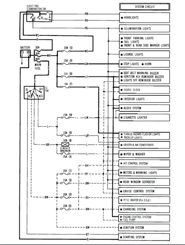

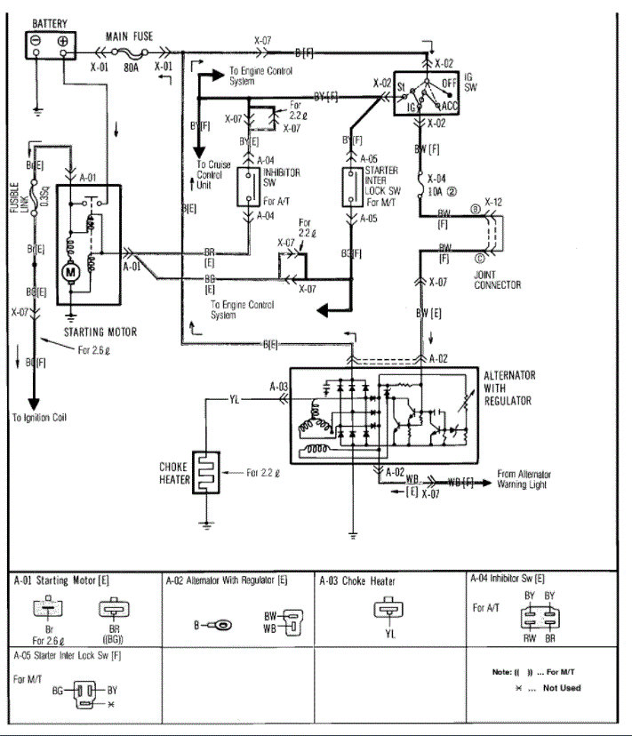

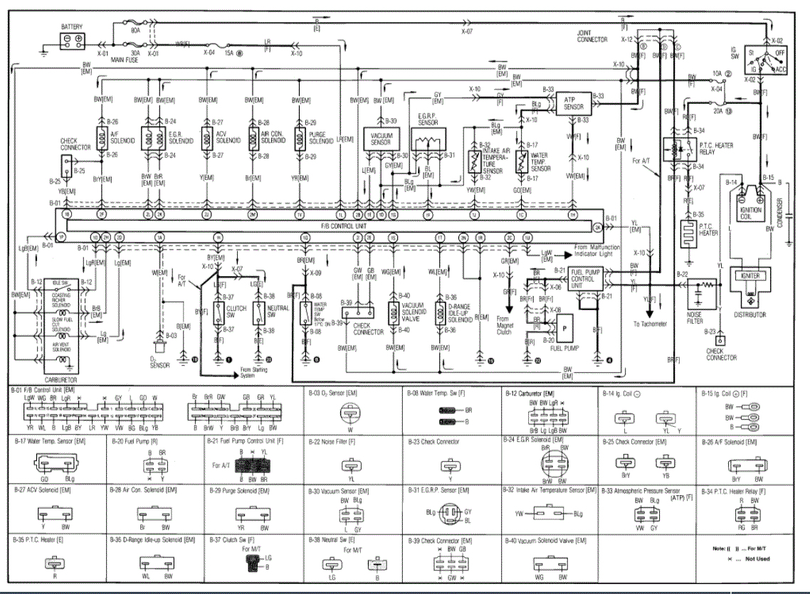

I need a wiring diagram for the underwood harness bought an online manual but it doesn't show what I need.
Feb 25, 2022 at 5:21 AM
  • 110,240 POSTS
I just looked up schematics for this vehicle, and because of the model year, they are very limited. Also, I'm not sure specifically what you need.
If you look below, pic 1 shows the OEM wiring schematic for the powertrain management. Pic 2 is the starting/charging system. Pic 3 is the schematic for the power distribution.
Let me know if any of these help. If they don't, let me know what specifically you need schematics for.
Take care and I'll watch for your reply.
